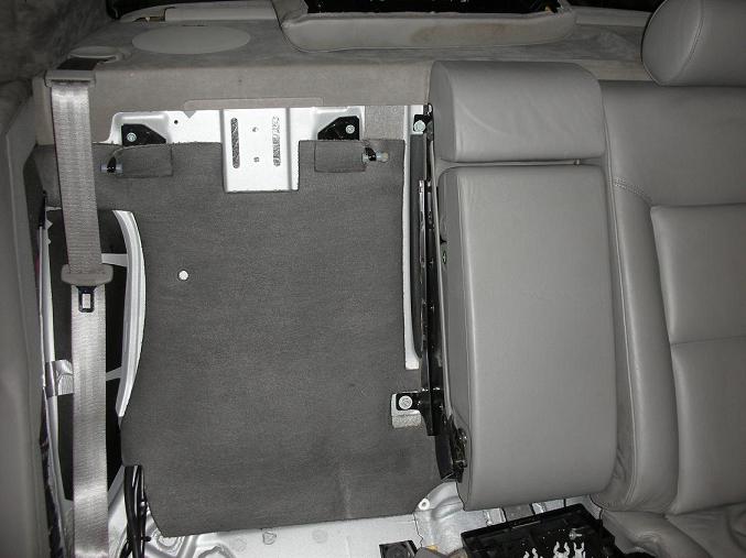

Anyway, they say pictures speak a thousand words so here we go:
(1) The seats, with one rear seat elevated and reclined.....
http://forum.a8parts.co.uk/attachmen...1&d=1260806736
(2) Under the surface. What it looks like when you remove one seat:
(3) Again, one seat removed

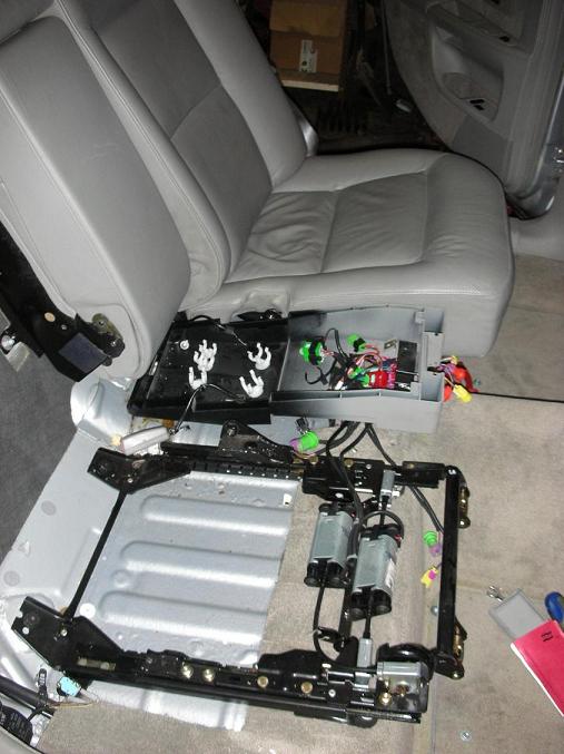

(4) Close up of the base and wiring

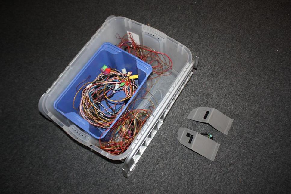

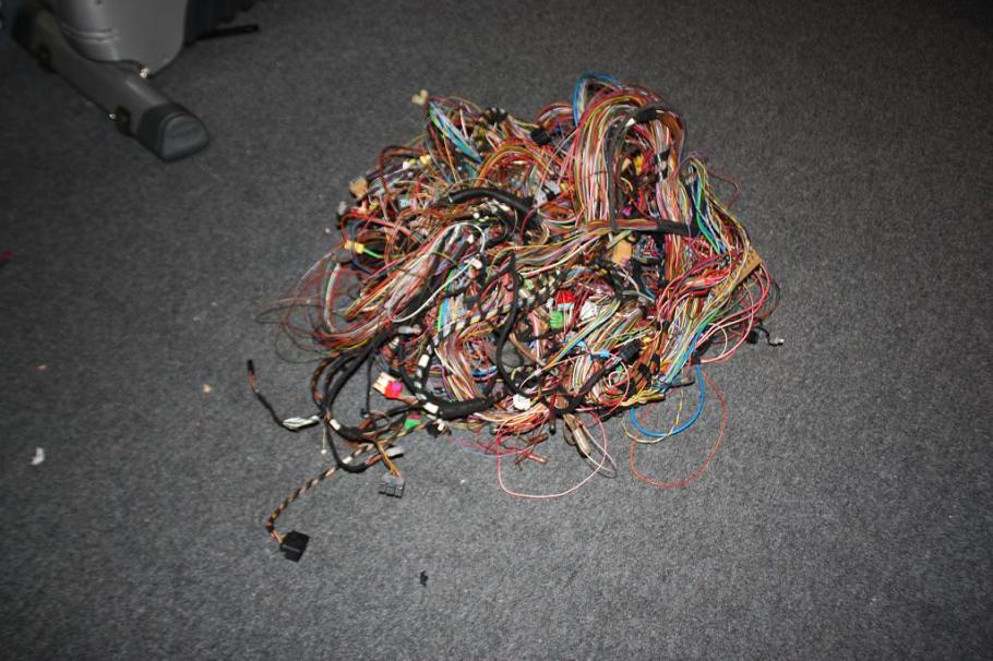

So, speaking of wiring... All these buttons in doors, heating elements and whizzy motors take quite a bit of wiring in. So, we took the entire loom from the donor car, and the seperated off the main loom to leave us with just the accessories:
(6) Then we unravel it all. Remove all the fabric tape, and start to extract just the cable runs we need for this project.

There are 3 in this box, and one other that I took out earlier. In principal, the 4 looms are:
Front passenger seat memory
Rear Heated seat connections with controls
Electric rear seat movement inc switches for driver side rear door
Electric rear seat movement inc switches for passenger side rear door
