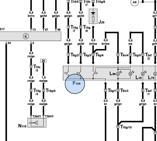

Not tried it, but its just switches in the shifter mechanism so no reason you couldn't do it. Since you'd have the shifter in bits you could swap the + & - symbols easily enough too so they were correct with the new shifter action.
In theory you just need to swap T5g/2 and 3 to reverse the switches.
http://forum.a8parts.co.uk/attachmen...1&d=1551911017

thanks MJ would you know if they are discrete wires in a multiconnector or just separate plugs that need pulling
MikkiJayne 11th March 2019 03:04 PM
Wires in a multi-connector so you'd need to dismantle the connector, pull the terminals, swap them over and reassemble. I'll have a look for one shortly.

Would it not be easier to swap them at the TCU end (looks like pins 46/47 of J217)?

There's less to dismantle at the TCU end but its more complicated. But, then the + and - symbols on the shifter bezel would be backwards. If you do it at the shifter you can swap the + and - to match.
