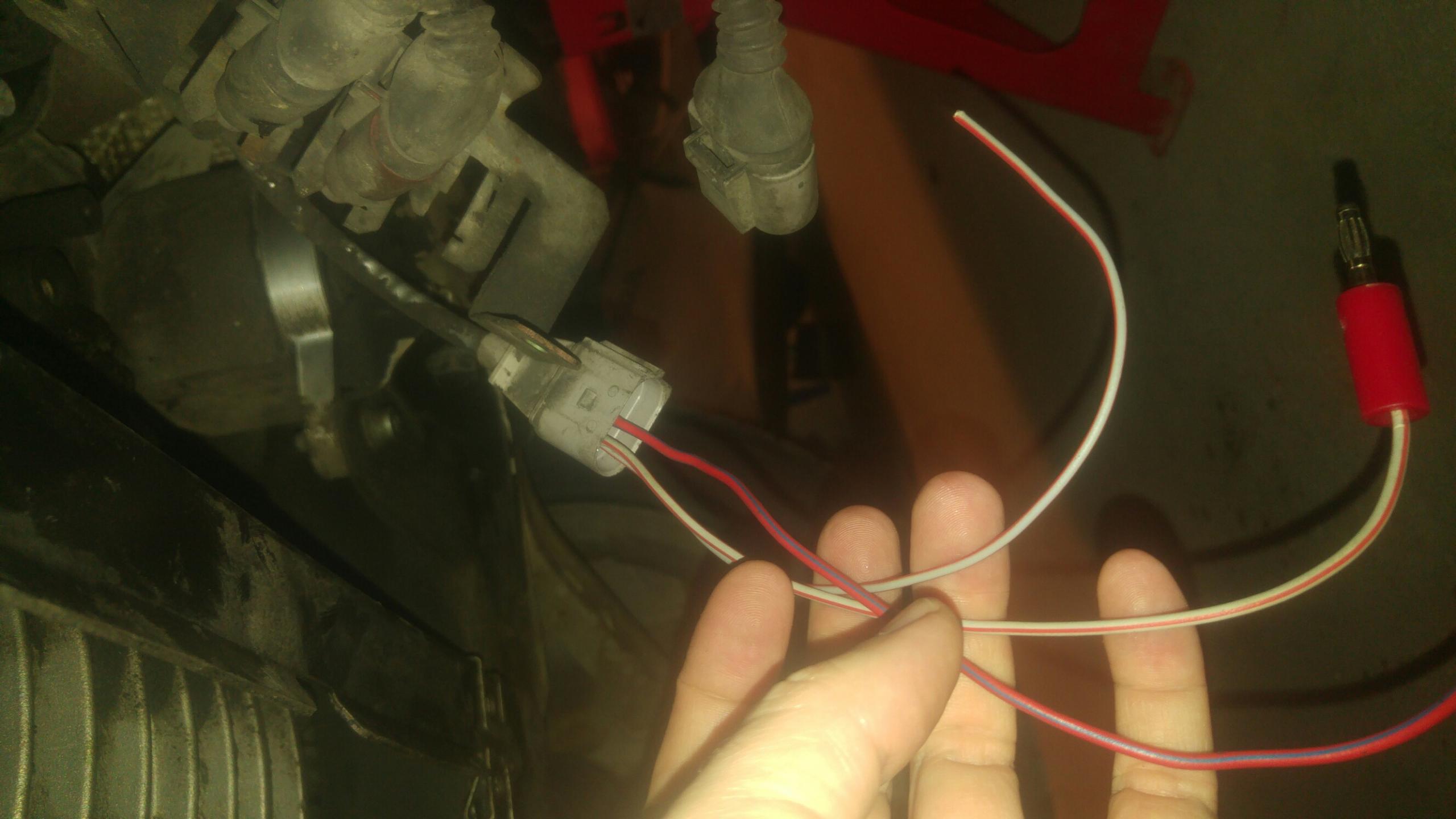

Hello all!
I`ve got a 2004 A8 4,2 petrol (BFM)
Wife called the other day. "It wont start"! :Confused:
I hooked up the VAG-COM and among the usual complaints as engine mount and system too lean messages I had a new one:
16706 - Engine Speed Sensor (G28)
P0322 - 004 - No Signal - Intermittent
The car starts eventually - so far it has not died when driven.
I could not find any info about this sensor or related issues on the forum, so atleast I took a couple of pictures in the process.
So far I haven`t identified the fault. There is no procedure for checking, not even a location in the workshopmanual - dissapointing really!
I checked the resistance of the sensor. it was arount 1K. (Was just under when checking from pin #2 to #3 and just above when reversing - cannot understand why...)
The sensor acts as expected. The resistance value changes, and resumes original value when a metal object is placed on the sensor tip. The same thing happens when the metal object is removed...

Pellesin 27th April 2020 11:23 AM
Is it easy to replace?
Not in my opinion!
Everything is in the way. And all screws are hard to access.
I took a picture to show the location.

Here`s a link to a bloke that made a video:
https://www.youtube.com/watch?v=ds6Mr9e_lnU
He "gives it all the names" but its the right sensor. And it can be reached with the car on jack stands - if you don`t have a lift - I don`t. Just like the picture I have attached in the initial message the heatcover for the driveshaft is removevd. It has to come off since the sensor wire is behind the cover inboard of the heatcover. You`ll understand as soon as you have a look.
