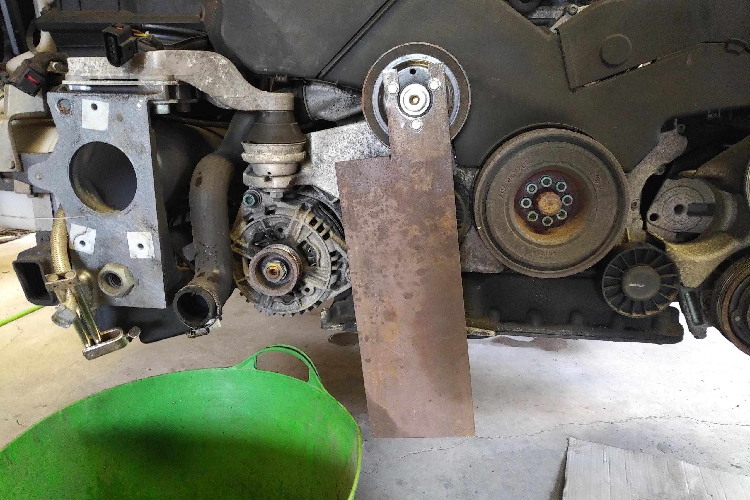

pete-p 21st August 2020 10:16 AM
1 Attachment(s)
Originally Posted by MikkiJayne (Post 159144)
...and a sturdy pin wrench to get the fan pulley off.
Perhaps even the special extra heavy duty version! :D
Attachment 23784
