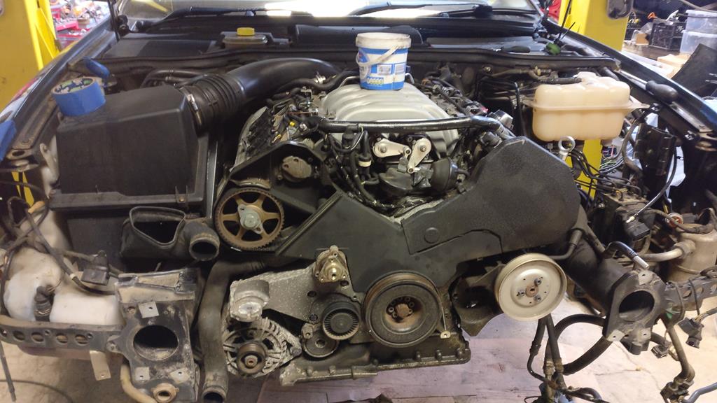

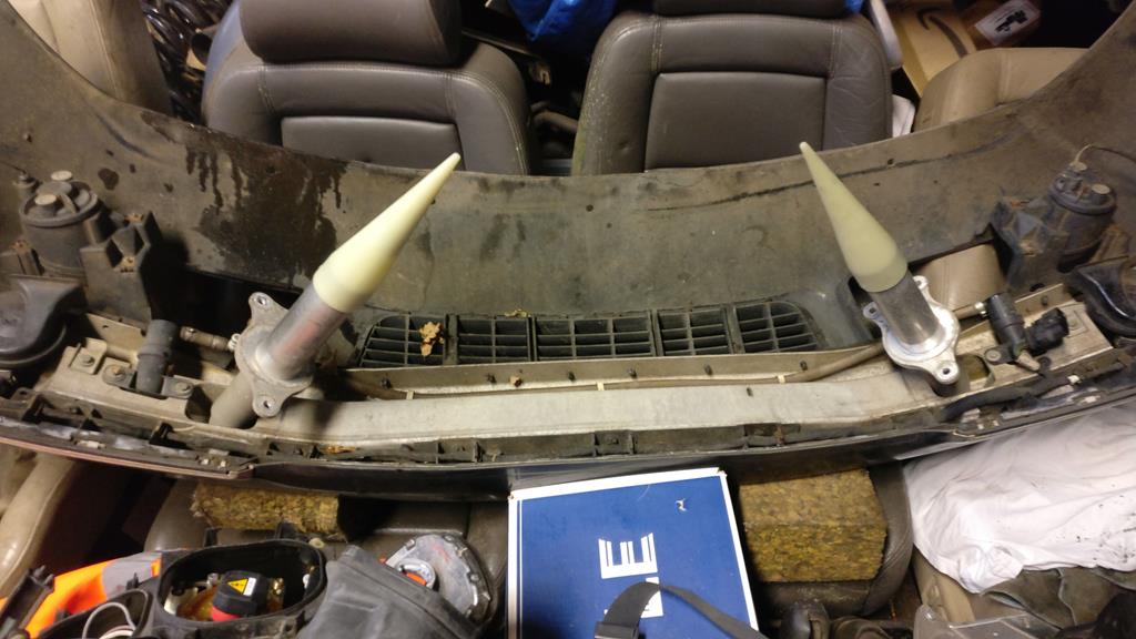

Engine out today. It didn't start well as the main bumper bolts refused to come out so I had to take it off with the supports. I'm getting quite good at this now though since the last four I've done have been like this! I am running out of new bumper bolts though :rolleyes:
http://forum.a8parts.co.uk/attachmen...1&d=1619901795

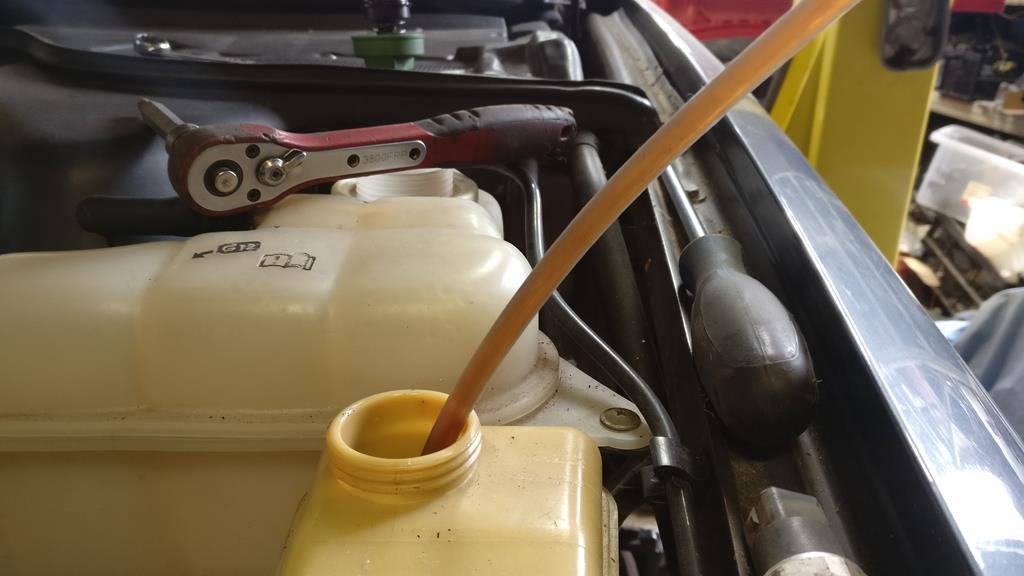

The power steering fluid is past it's best so I'll change that.

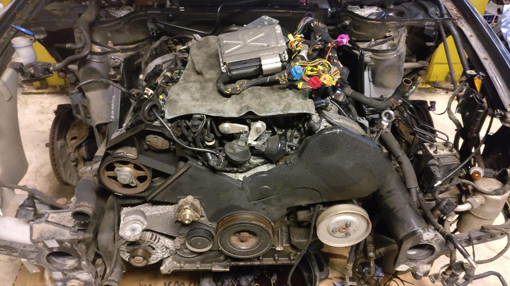

After the bumper, everything else came off just fine - no other seized bolts and it all went really well :) Front panel off:

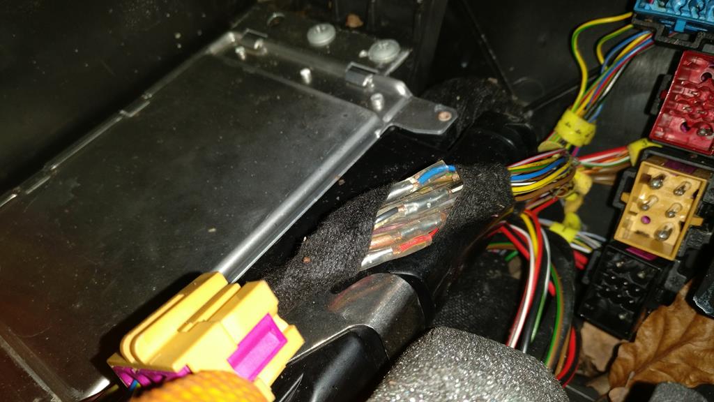

Oh, well apart from this

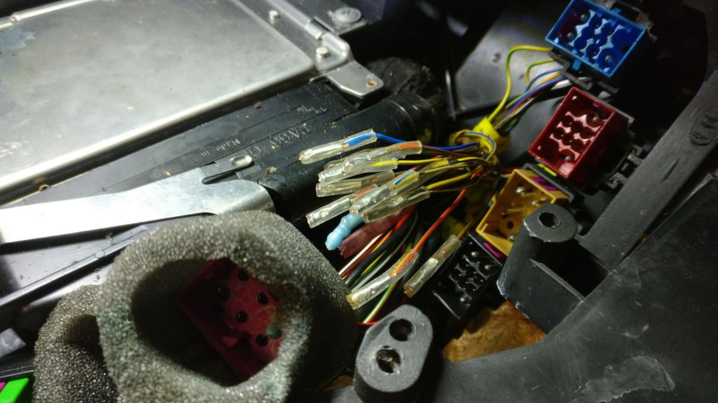

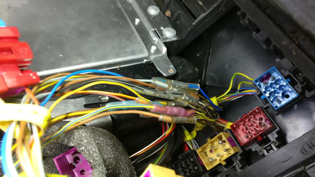

At some point in the past there has been an issue with two of the connectors in the electronics box and someone has made a really nice job of splicing the body harness to the engine harness. Unfortunately, the engine harness must come out with the engine - its nigh impossible to get it off with the engine in and completely impossible to refit it like that, so I had to cut these apart :(
I'll fix this later with some original connectors.

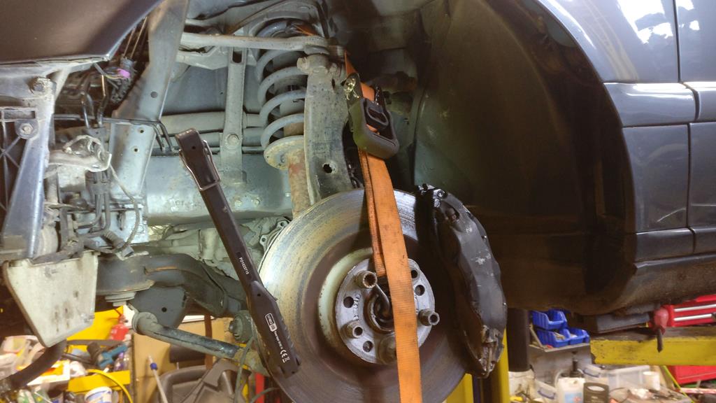

Strap the suspension up so it doesn't destroy the upper arms when the lower arms are removed from the subframe

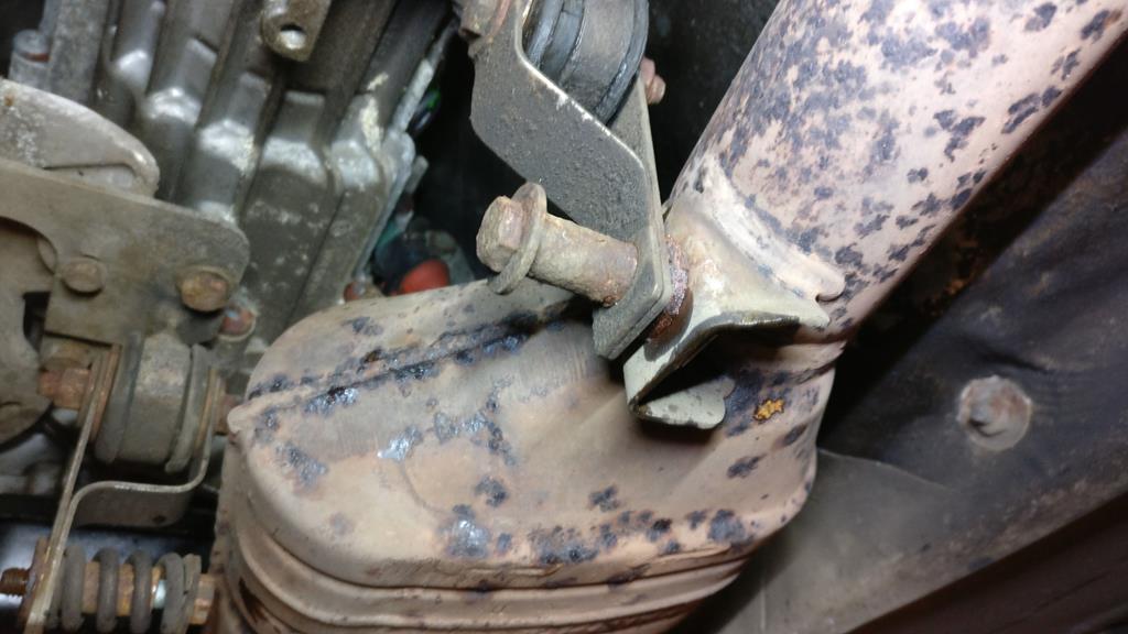

The spring on this exhaust bracket is awol for some reason. I have spares though.

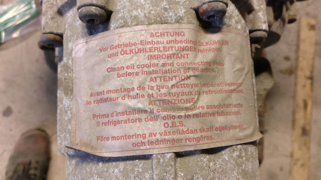

This is interesting on the gearbox. New OE replacement perhaps rather than a rebuild?

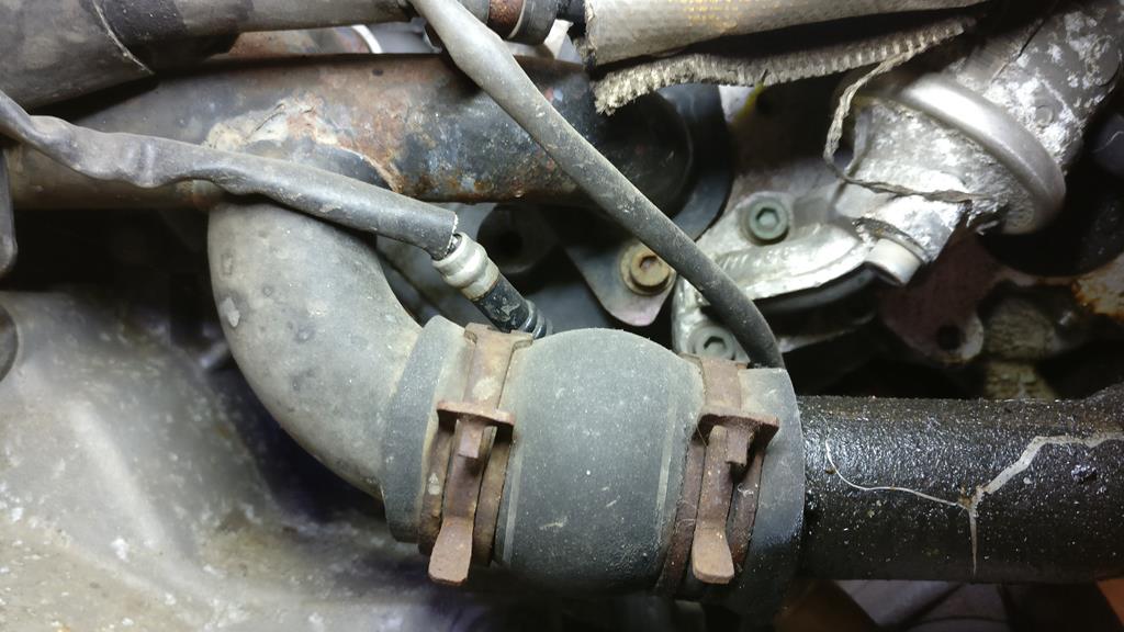

All the coolant hoses are distended so will need to be replaced. This one is especially bad

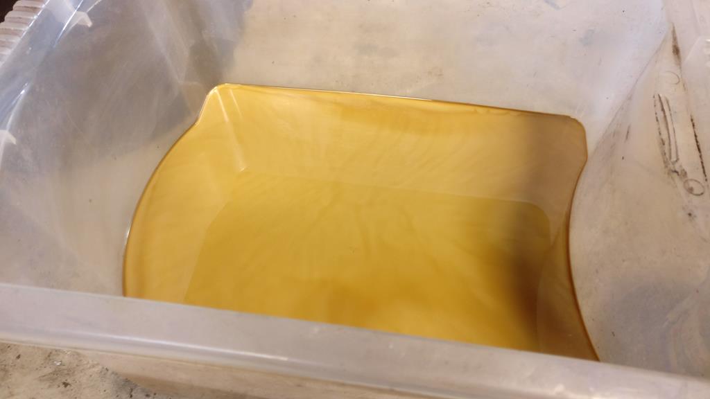

Before I removed the engine I opened the sump plug again, and was rewarded with 3/4 of a litre of clean coolant, then a cupful of the brown slime, so the coolant is leaking in while it is just sitting there. That means whatever is causing it should be relatively straightforward to find.

Markiii 1st May 2021 09:54 PM
blimey never seen a coolant line like that before, what causes that?
MikkiJayne 1st May 2021 10:34 PM
Just age I think. Its getting to be an increasingly common problem.
spannerrash 1st May 2021 10:54 PM
Is it possible to change that particular line whilst the engine is still in the car?
