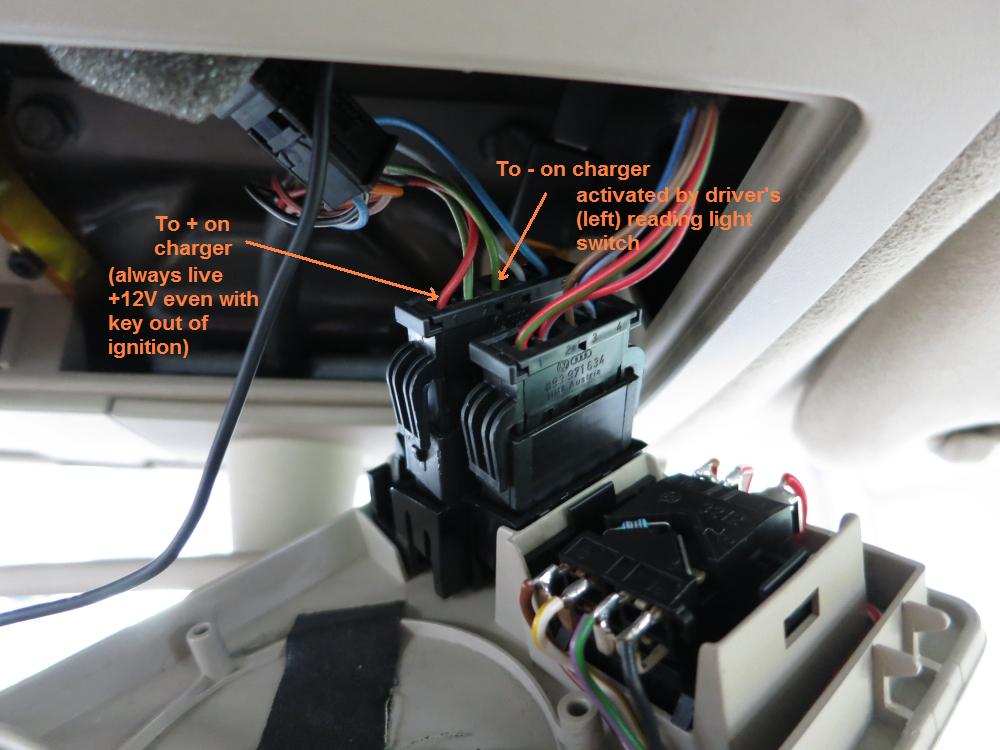

As I have a facelift car with the ambient lighting I was thinking tapping into that would make the most sense as it would then activate with the headlights, what I haven't been able to find is which wires this would be. Does anyone know which these would be?
I came across the picture below from Goran when fitting his dashcam which shows the reading lights circuit. in this post http://forum.a8parts.co.uk/showthread.php?t=11184
This leaves the Green/Cream, Grey and Blue wires to check.
Attachment 26688

So I've been studying the wiring diagram for the interior lights and think I have the solution.
The usual plug on the mirror with/without dimming has the pins below:
1. Red - Always live even when ignition off.
2. Grey/Green - Switched live with headlights. Also same colour wire provides power to other lights (e.g. ashtray)
3. Green - Unsure. Some reversible ground from lights? Goran indicates this as being activated by driver's reading light switch but then connected it to the negative for the Dashcam.
4. Grey - Not sure but possibly related to headlights or perhaps the other reading light, only other grey I can see is between the headlight switch and the relay in the footwell.
5. Blue - Ground. Another blue on the tiptronic switch is connected to ground (brown) so seems logical this does too.
So I found a 9v battery and connected the positive to pin 2 and negative to pin 5 and the red ambient lights switched on. I think this is where I need to connect pins 2 and 1 from the dimming circuit.
Not sure if I can connect pin 3 from the mirror (linked to reading light switching) to pin 6 of the dimming (normally connected to interior front and reading lights) any thoughts?!
