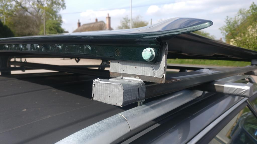

Fix are painting the bonnet while the engine is out. People seem slightly bemused when I take them only the part I want them to deal with, rather than the whole car, but that just seems logical to me. No point having it sitting in a bodyshop for a week while I could be working on the engine, but as a D2 bonnet won't fit inside anything I own, I made a bespoke roof rack for the Allroad so I can bolt the bonnet to it using the hinge points and catches. That way I can bring it back without having to run a strap over fresh paint.

This is how the special roof rack works - the catches are removed and replaced with some M8 threaded bar which attaches to the right hand side of the rack
http://forum.a8parts.co.uk/attachmen...1&d=1651260753
and the left hand side of the rack attaches to the hinge holes.
The bonnet is solid on here without touching the fresh paint :cool:

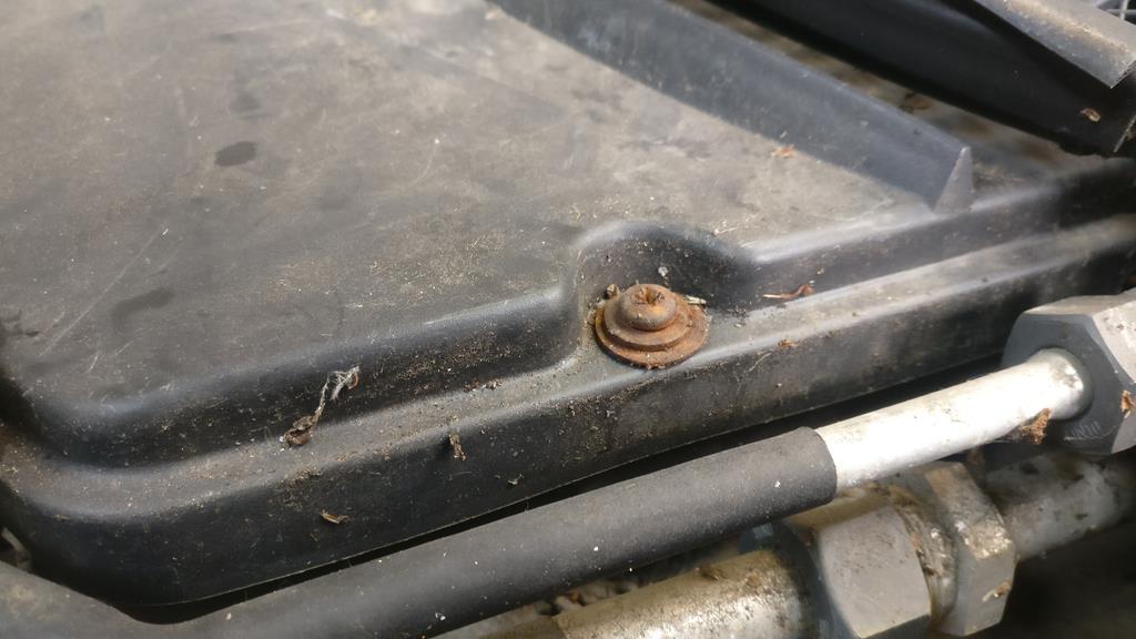

On with engine removal. In keeping with the generally cooperative nature of the car so far, only two screws on the electronics box are seized. One can be recovered, and this rusty one will be replaced
