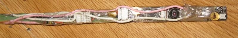

ainarssems 1st January 2011 10:06 AM
1 Attachment(s)
Here is the picture of my borescope
http://forum.a8parts.co.uk/attachmen...2&d=1293879908
Conan_the_Librarian 1st January 2011 11:07 AM
Top bodging. Could you do a small how-to on this please?

ainarssems 2nd January 2011 02:03 PM
There is not much to it. Most if not all laptop webcams run on USB anyway so you only need to connect cable to it so that You can plug it into USB port and a source of light.
You can use any webcam if You have any or buy them cheaply on e-bay £5-15. I would recommend 1.3MP( 1280x1024) and from a newish laptop preferably one that says webcam optimised for low light video or something like that. Pick one with the cable attached as it will make it easier to connect the wires correctly. I just used one I had lying around from old laptop 0.3MP( 640x480). Make sure You know laptop or camera model as You will need to download drivers for it.
You will also need standard USB cable to connect it to PC/laptop. Leave the plug that plugs in PC and cut the other end off to connect to camera.
Now the problem is that while USB cables normally use standard colours for wires laptop manufacturers do not follow them so it can be tricky to connect them right. I was lucky that only one wire was different colour on camera cable so I connected matching wires and the the remaining different coloured ones. If the colours do not match up search the web to find out. But You cannot follow it always as white wiremost of the times are data- but sometimes can be ground. If You connect them wrong protection should kick in and it will just not work nothing should get damaged but I do not give any guarantees do this at Your own risk.
Then you need some source of light. I used white 3V LED from a keyfob torch wife kindly donated. you can use several LEDs pointing different directions to give more light including surface mounted ones. You might also sand the tip of LED to make it matt and spread out light a bit more. You can also try different colour LEDs maybe some colours give more contrast or even use infra-red LED.
You will also need power for LED. You can use extra source of power if You want, I used 5V from USB with a resistor in line..
I also cut the lens/sensor body edges at 45 degrees so that I can attach small mirror made out of CD so that I can look up or down as required. Used small amount of glue so that it can be removed. Also used some of brown postal sticky tape on the back so that it would not fall into cylinder in case it breaks off. If it does fall in You can blow it out with compressed air.
That's about it.
