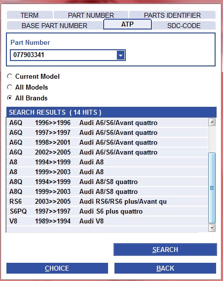

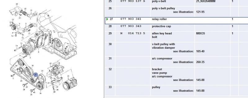

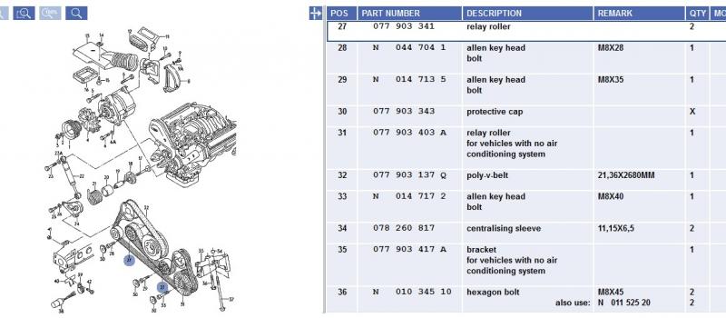

I have had a look and I think you can use the 40V rollers. They are the same part number, but a price check shows them the same price from an Audi dealer.
Here is a drawing or two to help.
32V & PN
http://forum.a8parts.co.uk/attachmen...1&d=1303835425
Vehicles used on:
40V & PN
HTH

Duhh!! I have Etka myself but for some silly reason I have not checked the part numbers. I just saw them being sold either as 1994-1999 or 1999- 2003 with a great price difference so I assumed they are different.
