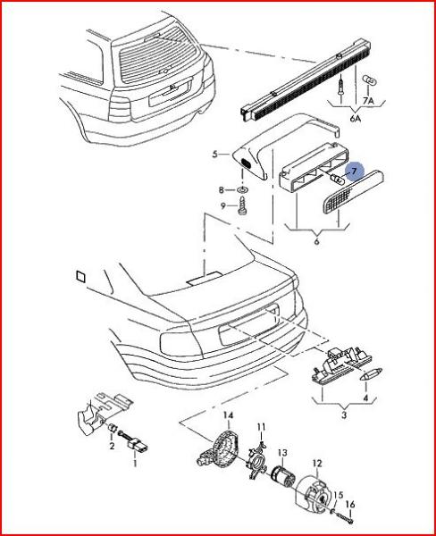

1 Attachment(s)
Bulbs are - 4 No. of
part No. N 017 753 5
W5W-12V5W
and are £1.83 each
http://forum.a8parts.co.uk/attachmen...1&d=1327202940
It looks like the housing needs to come off (screw as shown) and then youn can access the bulb holder. You may need to unscrew the housing from under the parcel shelf in the boot

Thanks, I think your right. I did look in the boot, but perhaps the screw is located in hole rather than the on the surface. At least I now know where to look, now to get some W5W bulbs and change them all.

I now have the new bulbs, and went to have a go this evening. There are 2 holes beneath the light when looking in through the boot, but they don't appear to have screws in. They are quiet deep, so I inserted a screwdriver and cannot feel a screw head in there to undo.

mannyo 25th January 2012 06:16 PM
And I have now changed the bulbs, took just a few minutes once I knew how to take it apart.
Dezzy 26th January 2012 08:46 AM
I know it's too late now but it just pulls off forward

mannyo 26th January 2012 01:23 PM
Originally Posted by HPsauce (Post 32309)
Is it the same if you have a rear blind?
Yes, because I have the rear blind. it just pulls forward still but because of the rear blind as you pull it forwards you lift slightly to get over the blind.
