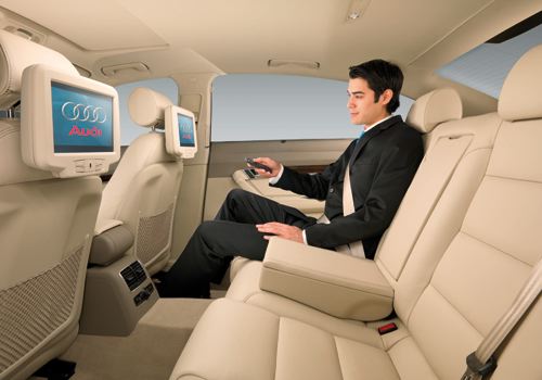

fancied doing this for a while, some very cheap kit around on ebay which will do the job, so with that in mind i went down to my local supplier to take a look (well, buy if possible) these headrests come in 3 shades Black, beige and grey, and while im happy with the tech, specially the 9" detachable touchscreen version, the "grey" colour is a few shades darker than my platinum interior.
choices are
a) Get someone to dye it (or do it myself) to the required colour (but the facia of the actual monitor will still be darker
b) go slightly different and do it in this style
Attachment 2986
the actual style im considering for this is one of these
Attachment 2987
its growing on me,
Just tried out one of these units, very good quality picture, responsive touchscreen, AVI, DivX among others and built in dvd
theres an attachment available which does the job of holding it to the headrest poles, and they unclip quickly and can be used elsewhere, wiring can still be mostly hidden, not quite as good as going down the centre of the poles but should be unoticable on the A8
what do you think , traditional or new style?

If you do not already have a rear entertainment pack, how much additional work is there to link in the power source?
I like the ones inside the headrest, but some are a bit of a pain if the people in the front tilt the headrest too far forwards.
I saw some that sat on a bracket from Audi, but as they were removeable they looked like a bit of an afterthought with a black casng and silver slide-in DVD monitors. I think they list it on the Q5 as an option if I remember rightly.
