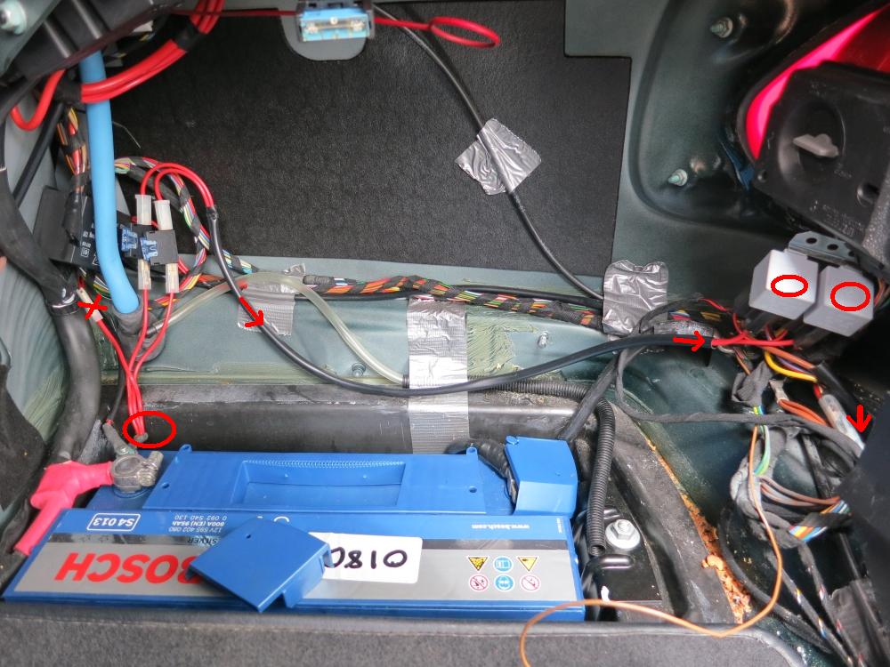

Yesterday when Sergey and me were performing surgery on the heated windscreen module, we saw some odd looking wires and relays in my battery compartment. The odd thing was one of the 3 red wires goes nowhere, the other two go to two relays that are not bolted down, and then wires from those dissapear into the wire duct into the bumper.
Anyone know what this is for?
Thanks.

PsYcHe 21st May 2012 12:16 PM
Did the car have a tow bar at some point? Sounds/looks like towbar wiring.
IT 21st May 2012 12:39 PM
That would be my guess - That aint standard Audi wiring.....
Dezzy 21st May 2012 12:47 PM
Just for future ref, when i did my towbar electrics i pulled the cable that Audi have placed in there, cut the euro plug off the end and wired up. Much easier than wiring into the light feeds or whatever. Obviously thats for a 96 A8, not sure on the later cars having wires for stuff they don't have but my 8 looks to be wired for everything it doesn't have.
Goran 21st May 2012 03:36 PM
Thanks guys!
I guess its safe to take this wiring out? Since I have landed the tow hook, and dont plan on doing any towing, I may as well lose the wiring.
PsYcHe 21st May 2012 03:41 PM
Should be safe to remove, just check all the bits it taps into and make sure that you don't leave any connections broken, then should be fine.
Goran 21st May 2012 04:01 PM
Sorry one more question.
Is that thin black wire, on the left of the 3 red wires that connect to the positive terminal, also non-standard?
Maybe I can remove that too?
