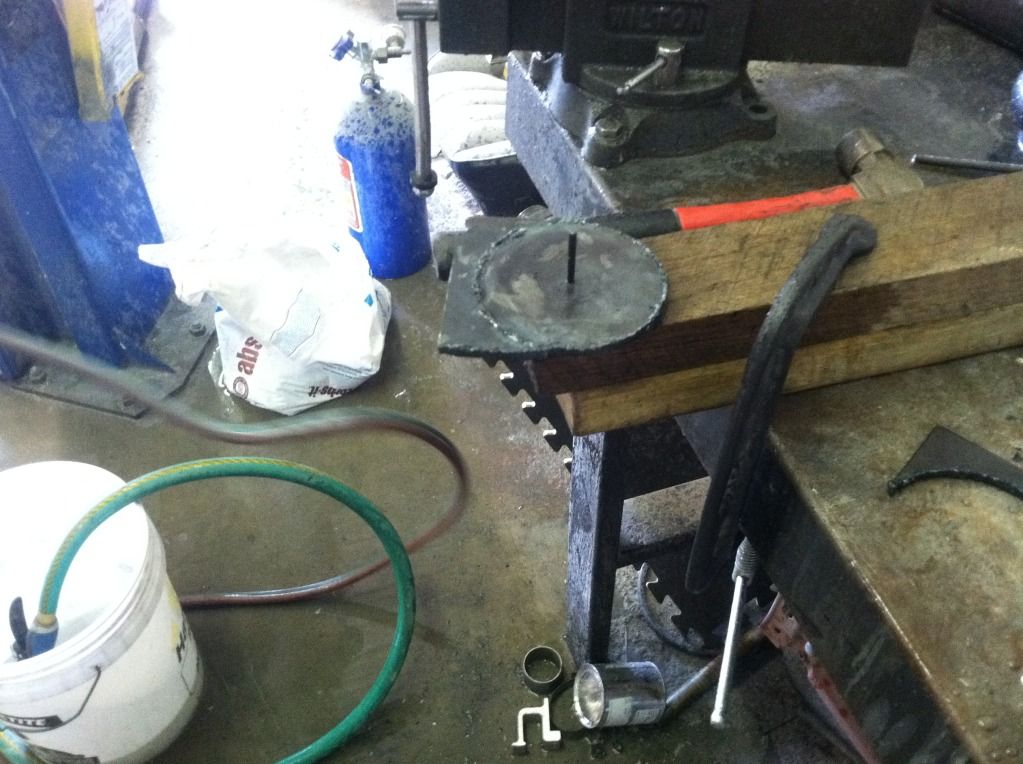

The bags are the same size on both the top and bottom mounting plate. Therefore I cut four identical bases (two for top and two for bottom, or one for each side on both top and bottom) for the mounting brackets. To do that I marked a sheet of 1/4"hardened steel I had in the same diameter as the base of the bags. I then marked center and punched it. After hitting the center with the punch we used a bit and drilled the center:
http://i631.photobucket.com/albums/u...4/IMG_0848.jpg
Then we cut the sheet off close to the marking and placed it on this rig we devised:
http://i631.photobucket.com/albums/u...4/IMG_0849.jpg
That's a couple 2x4 pieces of wood with the drill bit run into it. Once that was together we slid some washers over the drill bit and then placed the at present square piece of steel onto it. The table we were using has a vice on it so we placed a cutting torch into the vice and fired it up. Then, with the torch set to cut we spun the steel plate on the wood/washers/drill bit to get a circular "pad" to mount the bags onto.

That process gave a circle but it had a lot of waste and slag so we chucked a grinder into the vice and cleaned them up:
