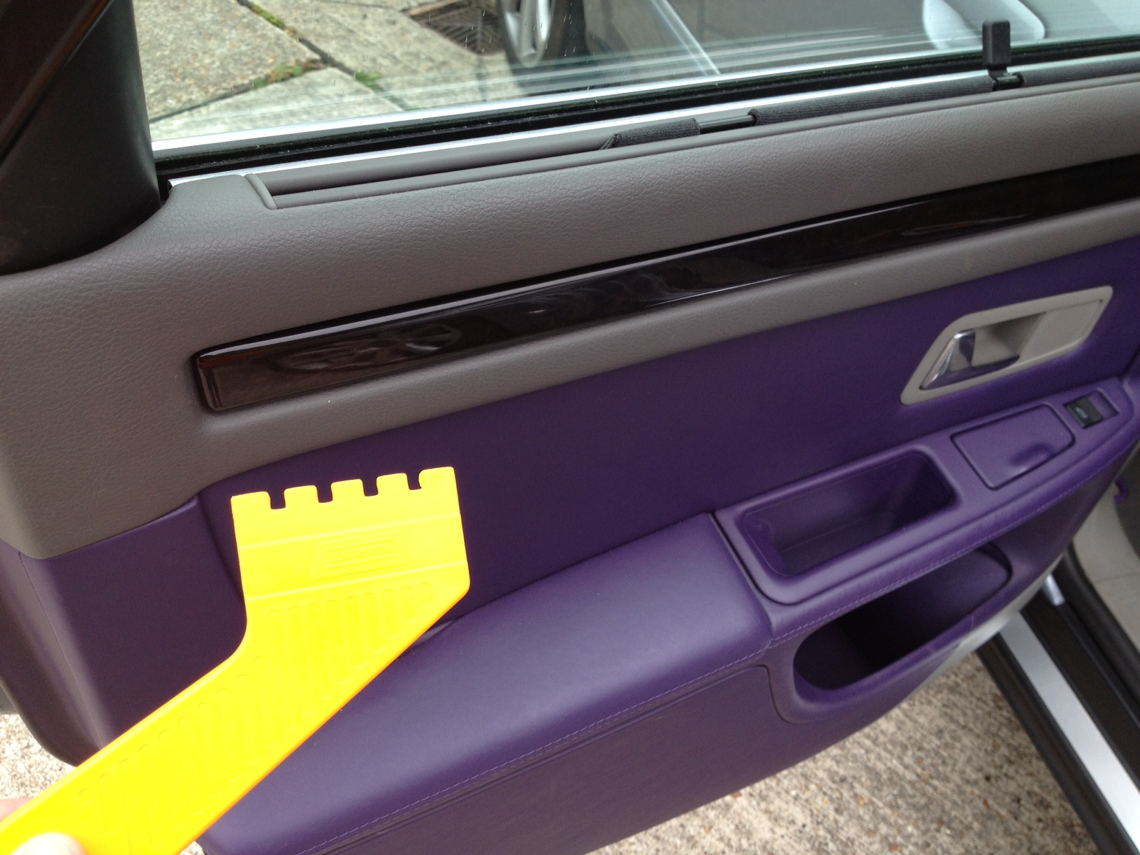

Well that was good advice from HP to have a look first!
With the trim sitting out from the panel I managed to get an adhesive spreader in under the trim and it very quickly released all the clips holding the trim in place.
http://forum.a8parts.co.uk/attachmen...1&d=1370941241
Where the trim wasn't sitting flush there isn't a clip anyway - it covers a screw holding the door trim in place.
Got a trusty straight edge and it was quite obvious the trim was banana shaped so a little light tweaking by hand soon had it back to something approaching straight. Popped it back in and it's now sitting flush again. Will have to test over time whether the rattle has gone too.
HPsauce 11th June 2013 09:22 AM
I put a tiny bit of adhesive foam over the screw head to stop it rattling.
But I think my door panel had been taken off before as the screw head didn't look OEM and was quite bulky.
Glad you're sorted. +++
