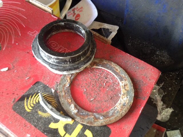

Architex_mA8tey 25th December 2013 04:36 PM
1 Attachment(s)
Thanks chaps, yes all fixed and driving fine again today. +++
Here's the damaged seat and the incorrect steel washer which should be nylon
http://forum.a8parts.co.uk/attachmen...1&d=1387992963

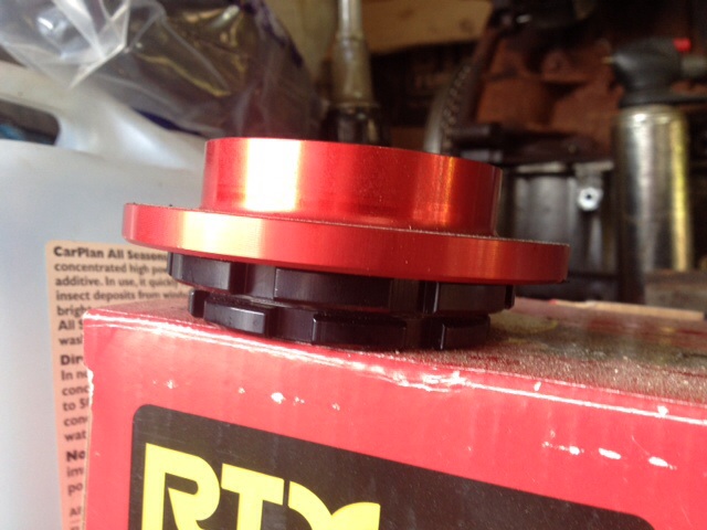

Architex_mA8tey 25th December 2013 04:38 PM
1 Attachment(s)
And here's what a new set of seat, washer, adjusting nut and lock nut look like
Unfortunately it cost a staggering £99 for the set including vat from H&R in Germany via Euro car Parts who are their agents and that is with my trade discount! :eek: I've now had the seat part measured by a local engineering company as they can make new seats for me next time if I need one and anodise them for me too, should be a lot cheaper. The adjusting nut and lock nut themselves were actually pretty good condition but I changed them anyway as I had already bought the set
http://forum.a8parts.co.uk/attachmen...1&d=1387993101

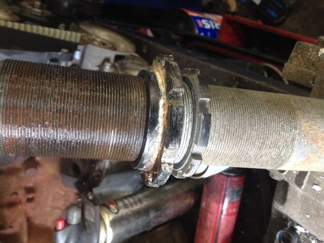

Architex_mA8tey 25th December 2013 04:46 PM
1 Attachment(s)
http://forum.a8parts.co.uk/attachmen...1&d=1387993563
