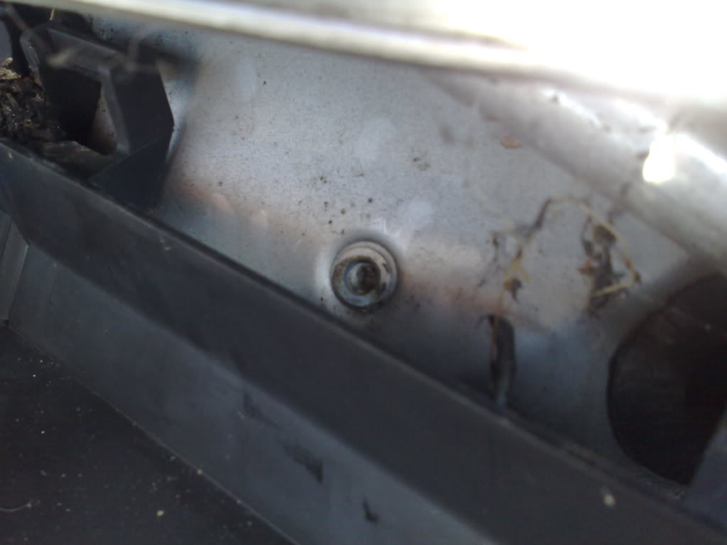

Now i know that 1 is left and the other right hand drive but, This is from Notorious and the hole is just a hole.
http://forum.a8parts.co.uk/attachmen...1&d=1392625625

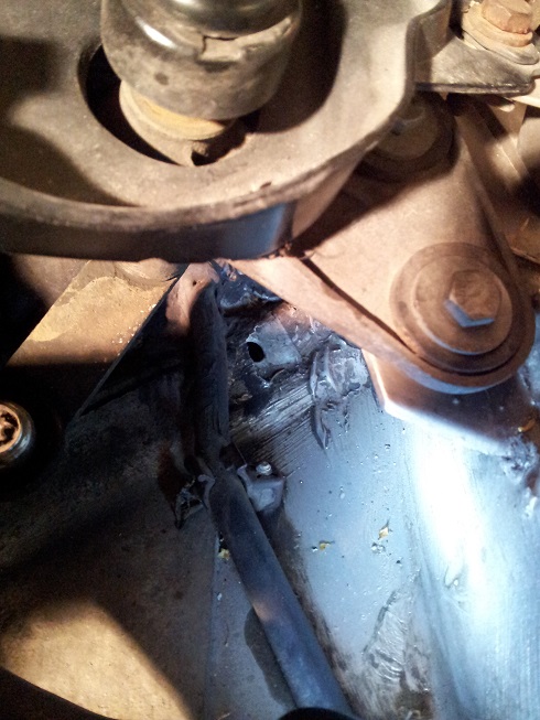

This is from Davisbike and is a captive thread, the same as i found.

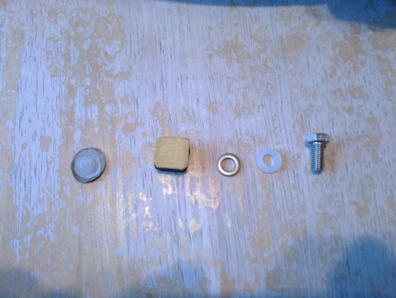

So off i went to my shed to see what i could find. Tapped hole is an M6 so a stainless bolt, washer x2 and some single sided foam tape.

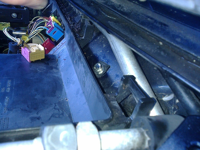

http://forum.a8parts.co.uk/attachmen...1&d=1392627749
But in the end i dropped the plastic washer for a larger stainless to spread more weight over the foam
The foam is water tight at 3/4 compression so i just done it up handtight with a socket, extention and wobbler.

Car is RHD, you see in photo 3 and 4 the little round bit of tape, that was stuck over the hole.

I'm pretty sure that the first picture is the one that I've seen referred to as Botangs Hole, below outboard edge of the ECU box I think on RHD.

Dezzy, this is not Botang's hole. The hole you have fixed is positioned too high to actually leak.
Botang's hole is hiding below cracked mastic and leaking through cracked mastic, so you won't see it in the way you see it in first picture, because you need to scratch mastic a bit first, which will fall off and reveal Botang's hole. Only then you will see a picture similar to 1st picture in your list.
