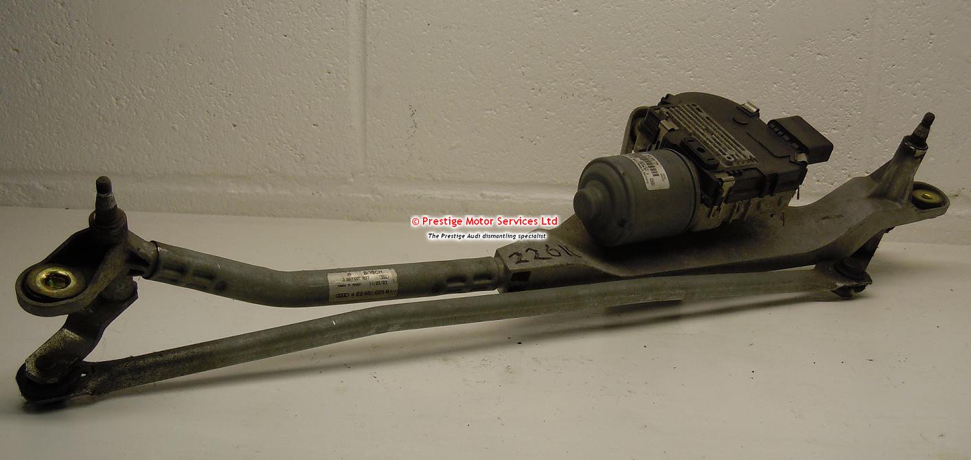

Marcin, I found a picture on ebay of an a8parts one. Looking at that there is not a lot that can go wrong, the spindle causing the problem is the closest in the picture below. I am going to check the wiper arm nut, since I removed it last weekend and maybe its loose I don't know. As long as its not raining in the morning I'll try that before heading to work.
http://forum.a8parts.co.uk/attachmen...8&d=1396559435
I had a quick look at Etka but the drawing is not that great.

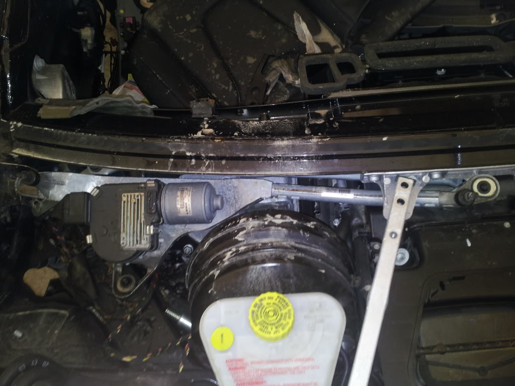

To remove the linkage is a piece of cake, already researched that.
Remove both arms,
Remove plenum covers from both sides,
Remove the lower trim from the windscreen,
Disconnect wiring to motor
Remove three bolts and lift out
Reverse to refit.
The picture below is the one I have ordered, its already dispatched. You can see it here attached to the car it was removed from. The picture shows the assembly with the plenum and screen trim removed.
http://forum.a8parts.co.uk/attachmen...9&d=1396607299
