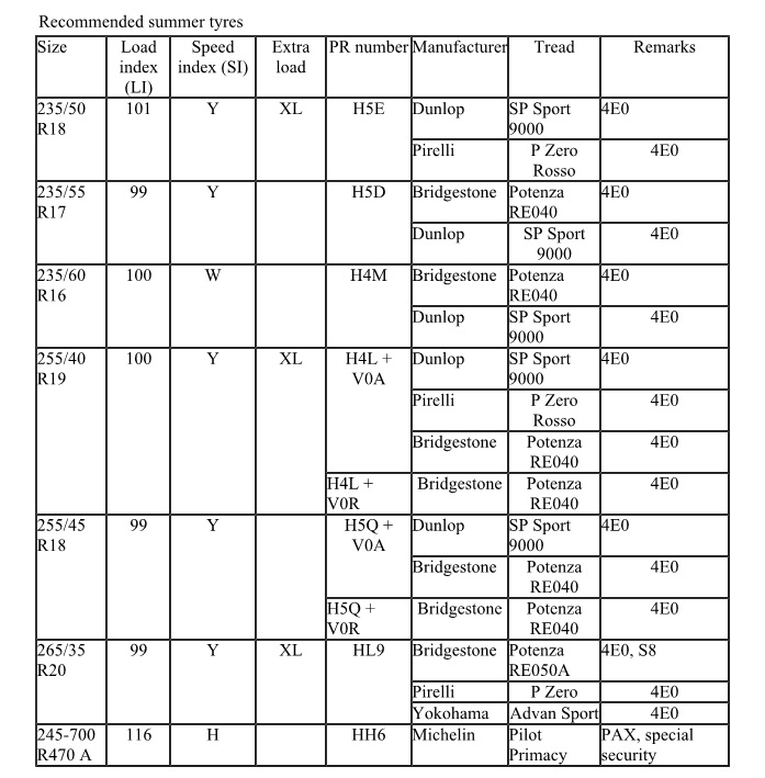

M-A8 24th August 2014 10:38 AM
1 Attachment(s)
Cheers Neil +++
Too many bad words I heard about Contis.
Found this in Elsa
http://forum.a8parts.co.uk/attachmen...1&d=1408876514
