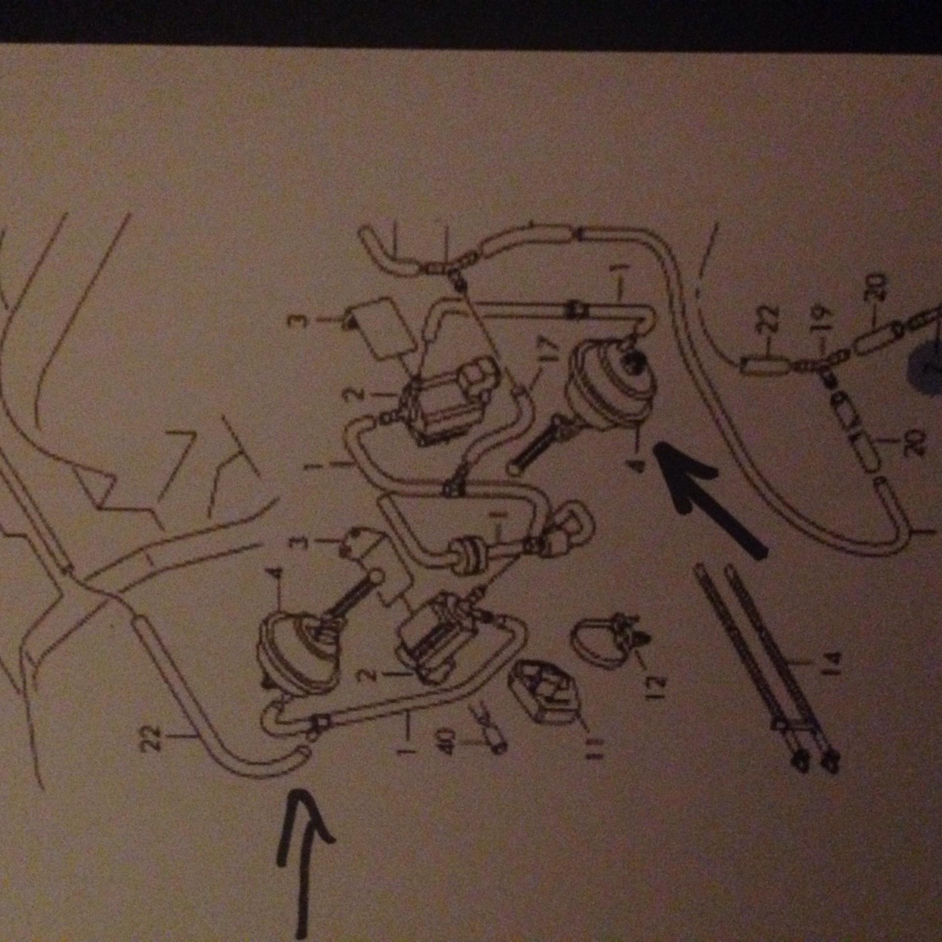

1 Attachment(s)
Attachment 9355
They look like pludges connected to swirl flaps ?
Number 4 on the pic

Is it the bellows unit you want? As noted A8parts would probably have these if that's the problem.
The question is why? These aren't particularly noted for failing, more that the manifold flaps get jammed and/or the link arms break.
Borys 25th October 2014 01:45 PM
Links are broken off
Flaps are operating ok
HPsauce 25th October 2014 01:51 PM
You can buy the links from Gruvenparts, or is it what they connect to that is broken?
Borys 25th October 2014 03:29 PM
Link themselfs are broken, the ball type ends snapped
notorious 25th October 2014 08:22 PM
Gruvenparts from the US then.
But they break because manifolds get seized.
So before installing new links make sure to service manifolds.
