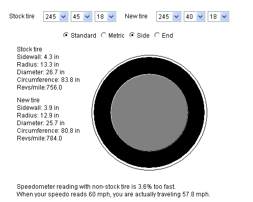

see the attached image
if they are all the same size then your speedo will just indicate you are doing faster than you actually are by 2.2mph and you can just wait until they are worn down to renew with a new size but again you will need to do all 4
