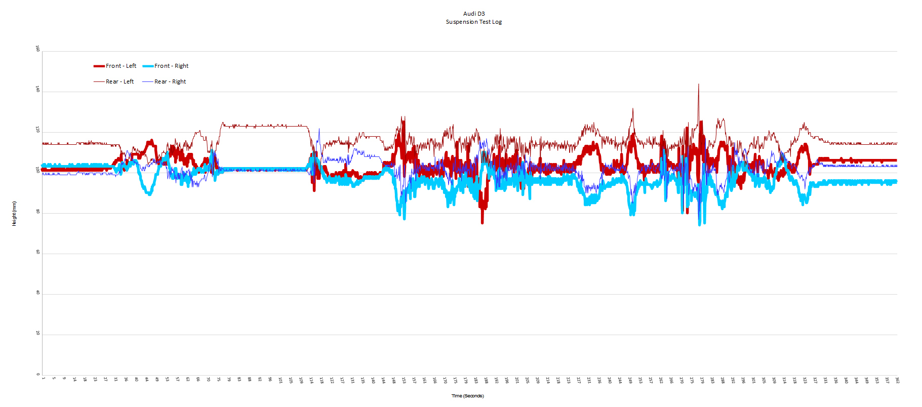

I've noticed that my rear right wheel has recently looked more into the wheel arch than the left. I park on a uneven surface so it may just be a visual thing. But today I decided to plug VCDS in and take a look at the measuring blocks and log a little 6 minute drive. I logged block 5, absolute vehicle height, which gives a reading around 100mm for each side.
After the 6 minute journey the average height for each side was
Front Left +103.5mm +97.0mm Front Right
Rear Left +115.4mm +101.9mm Rear Right
With this result I now don't know if the rear left is too high because the other 3 sides are around +100mm, or the rear right is too low?
I expect that the left will be a little higher than the right side to compensate for the camber of the road and me in the drivers seat.
Does anybody know any base settings for each side? Should it be around 100mm? Should the rears be a little higher? And would a suspension recalibration be needed?
Below is the logged line graph of the journey. Quite interesting as you can see the majority of the journey was left turns.

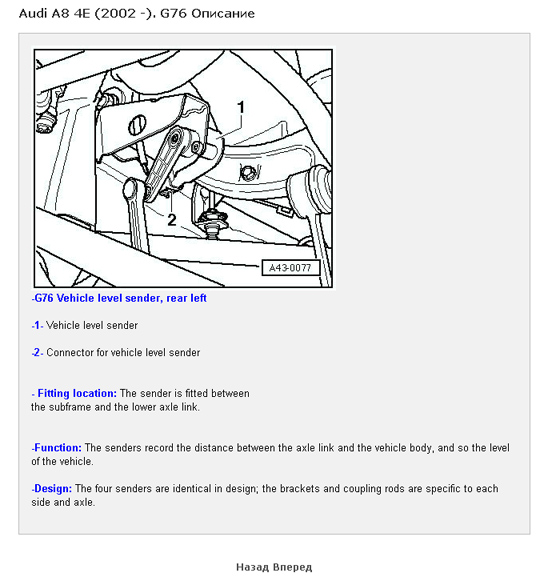

Worth checking the rear left sensor isn't seized or faulty before proceeding to alter the settings
Will check that, thanks
