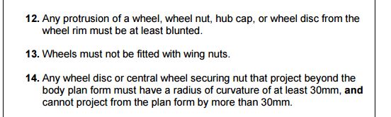

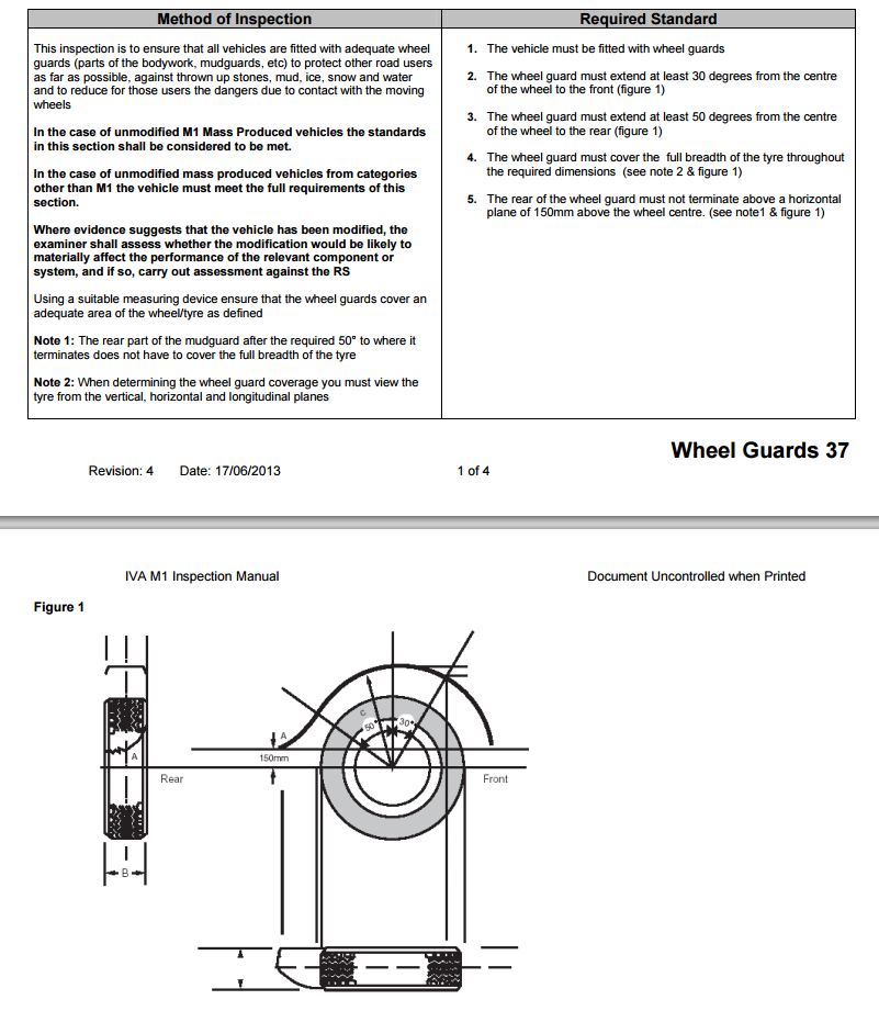

This from individual vehicle approval regulations:
ID:	11964   Click image for larger version
