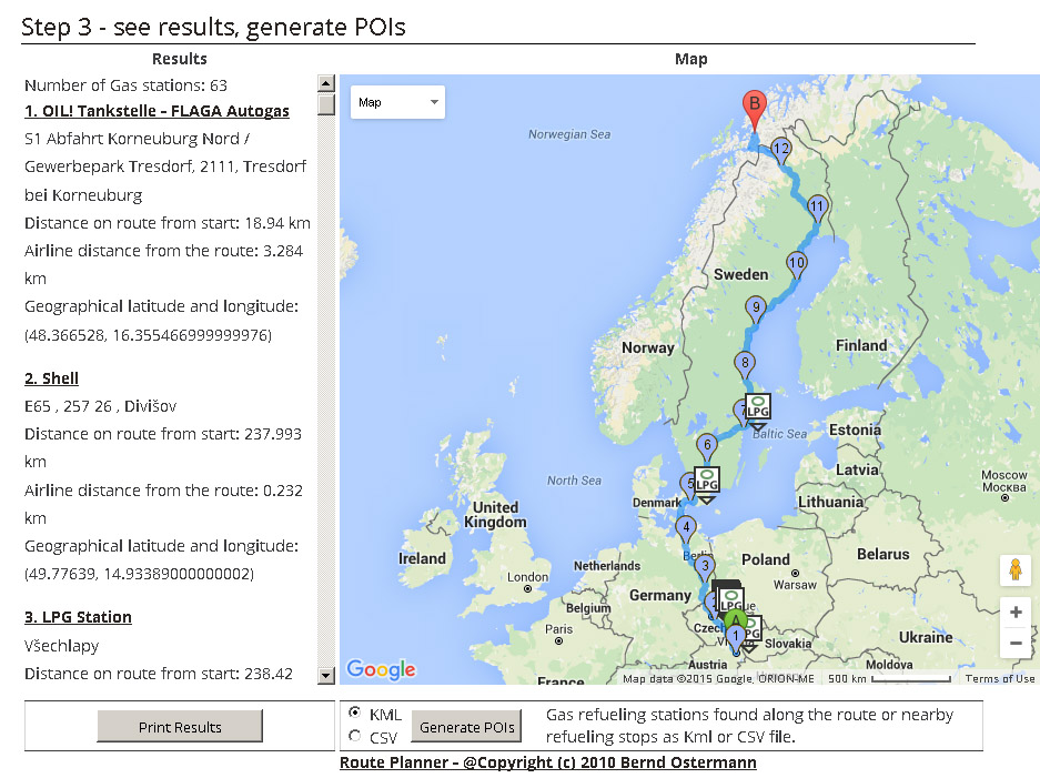

You've tried the route planner on mylpg.eu? I just did a search and seems helpful. You can change the route if you prefer, I just did a simple A to B.

Matty that's interesting that there is an LPG rout planner ! il have to have a play with that and hope its up to date when en Rout
