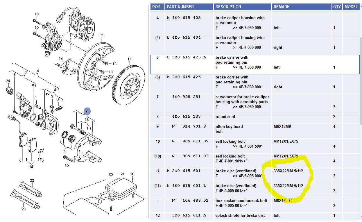

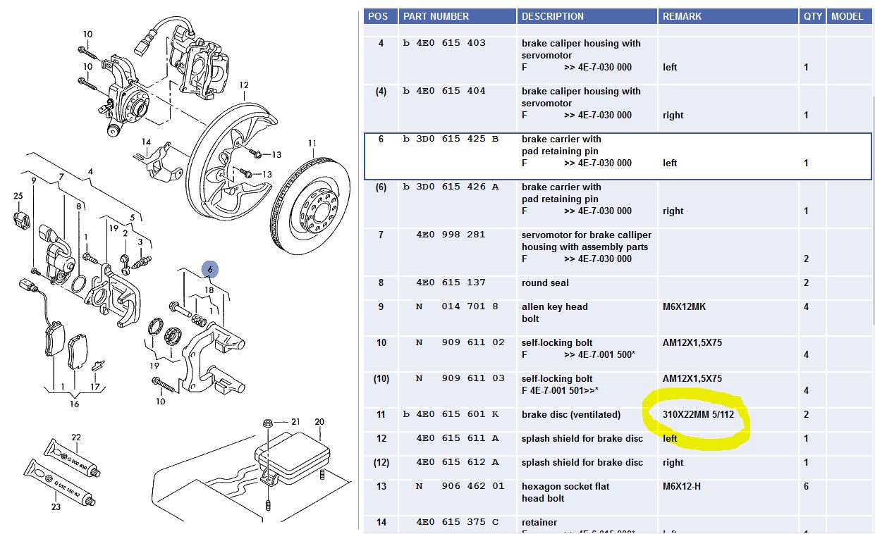

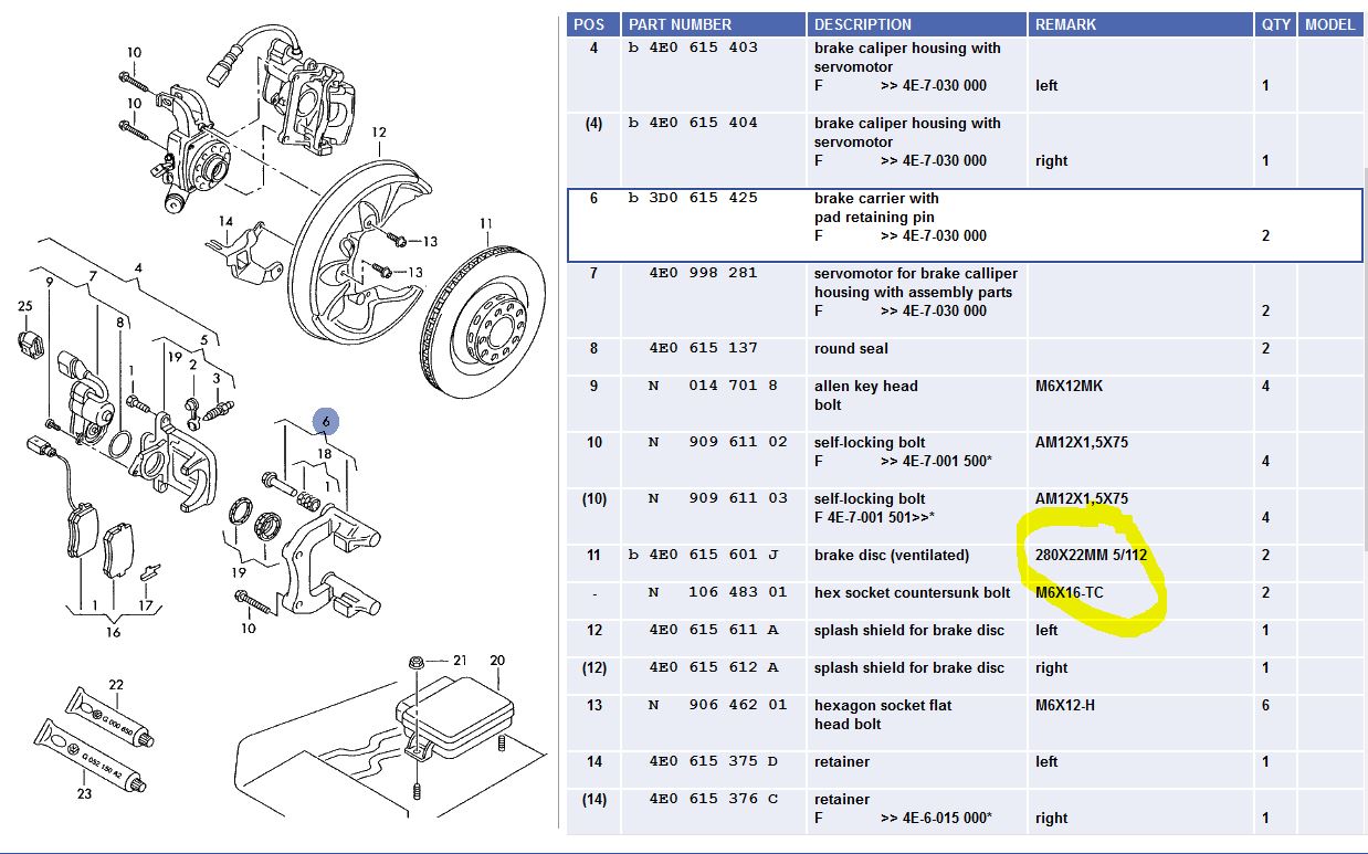

Old 11th April 2019, 03:28 PM
This is what my Etka shows:
Same numbers for all versions but different suffixes for different sizes. Also note that the 280 is not handed but the 310 and 335 are. Not sure why that would be. The rear hub is the same for all versions.

Old 11th April 2019, 04:10 PM
That's not unexpected - there are often supersessions and my Etka is a bit out of date.
The theory is still sound that discs and carriers from an S8 will fit an A8. Hubs are the same, splash plates are the same, calipers are the same.
