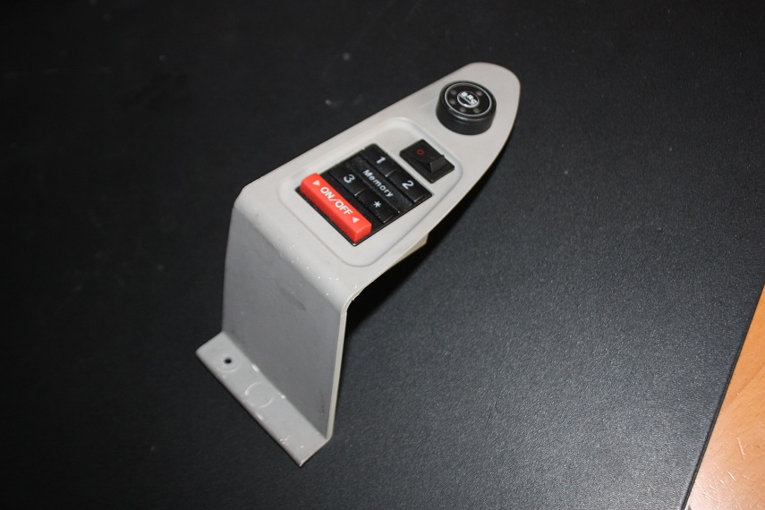

How annoying is it when you have a beautifully crafted luxury vessel and then as part of a £2000 LPG conversion someone goes and drills a hole right in the middle of something to install a £2.99 LPG control/readout.
Well, I've moved mine and I think its the dogs danglies tucked right out of sight, within reach and without the LED's reflecting off the drivers window glass at night, which is another bug bear of mine
All primed and ready for install:

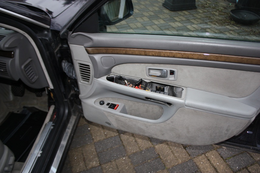

Then, I simply take the existing connector to the LPG control, cut it and extend each of the 5 connecting wires by a meter or so, fabric wrap it all for safety, then feed that through and into the driver door.
and in situ:
Then just replace/cover the piece of trim that was originally butchered, and she looks good as new... a nice discrete install...
