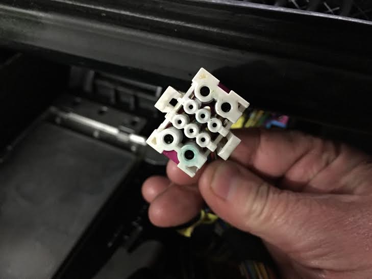

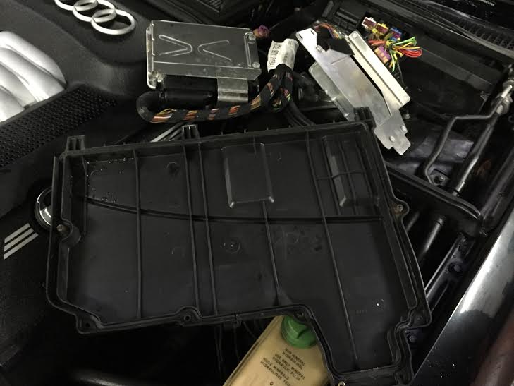

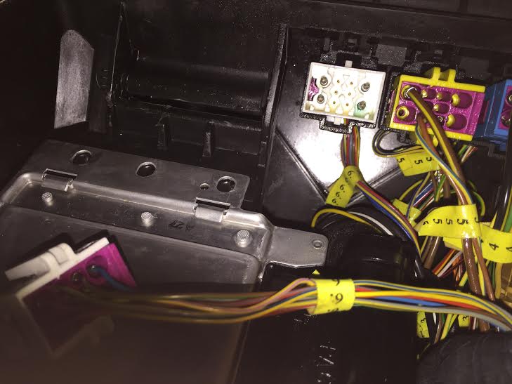

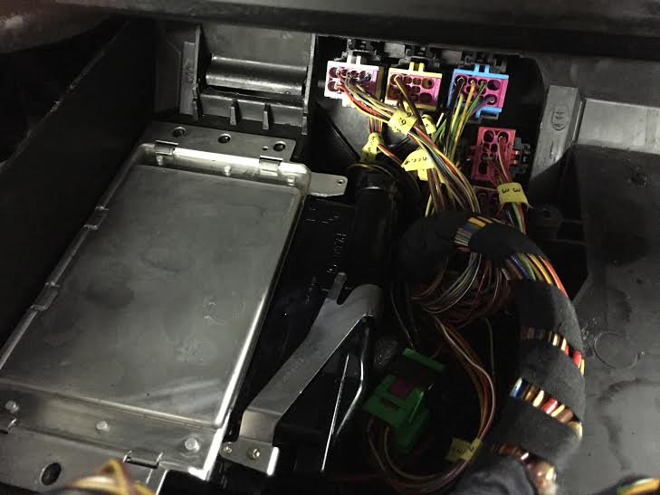

Some fairly prolonged investigation revealed that the seal in the 'e box' was perished and, as the attached photos show, water was getting in. If you zoom in on the third photo, you can see water resting in the bottom of connector block 6 and the fourth photo shows some corrosion.
My belief now is that, in very heavy and prolonged rain, the water overwhelms the scuttle drains and, with a perished seal, can get into the 'e box'. And my guess is, if mine's perished, so is yours!
Unfortunately, Audi say that the cover and seal are on indefinite back order and the replacement I got from A8 Parts was worse than mine. So, time for the silicone sealant! I should get the car back today hopefully, and there's plenty of rain to test it!

Just heard that the new lid and seal will be delivered from Audi on Wednesday, so no need for the silicone sealant. Very pleased about that, as I'd much prefer to have the job done properly.

Part number for lid and seal combined (apparently) is 4D2 937 128F.
A word of caution for removal and refitting: the screws that secure the lid, screw into captured brass threads that are fitted to the base of the 'e box'. A few of these had come loose, either because of corrosion and/or the plastic base becoming brittle with age. My garage used oversize bolts and nuts with locking washers to replace these (otherwise the whole box base would have to be replaced too).
