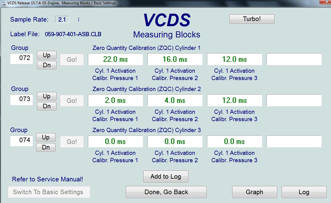

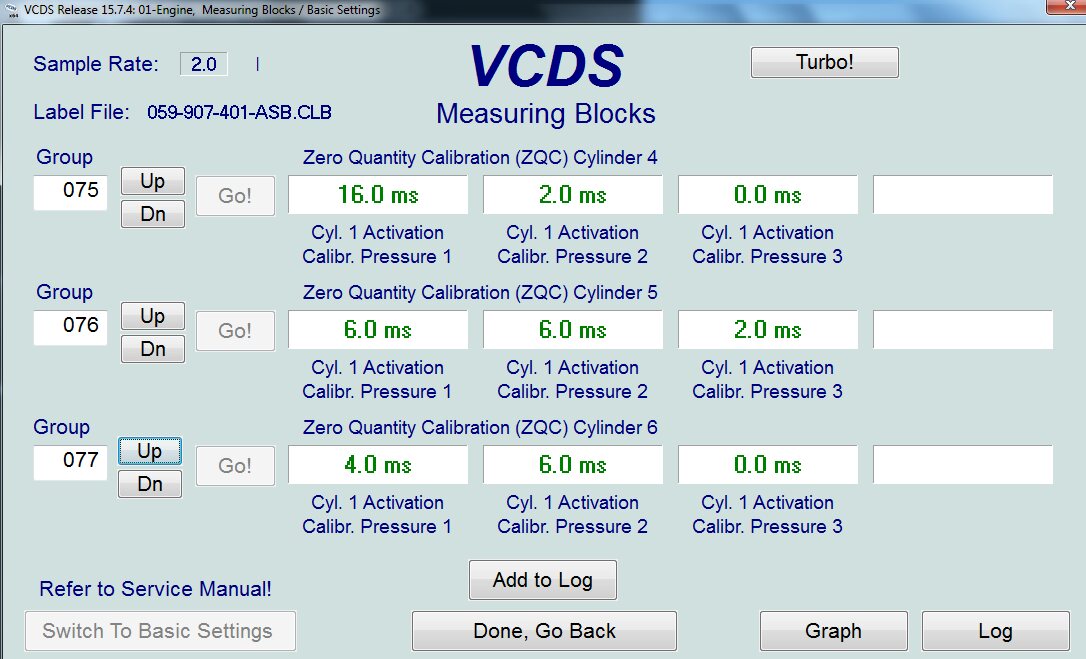

Thanks for that.
Attached is my readings.
They look ok, I think.

Not sure if we are in the correct blocks there Scott , think we should be reading the corrections ( injector trim ) in mg / str like in Snaps posting .
Just another point I see on range rovers with the 2.7 or 3l diesel that have twin egrs , if one egr bleeds across a little it affects all the cylinders on that bank so you could think injectors are near to the ends of the operating window but really it's egr gases affecting them .
I just blank egrs off and if injector corrections' clean up ' somewhat you know your on the right track .
