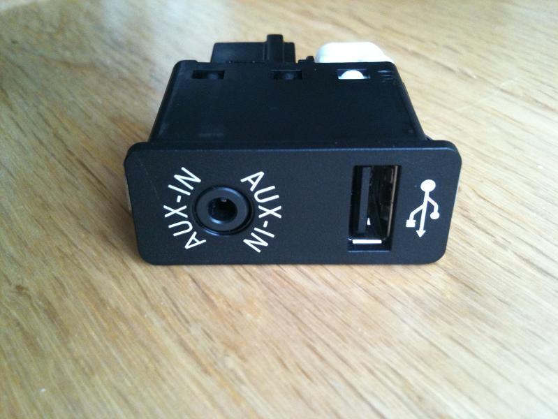

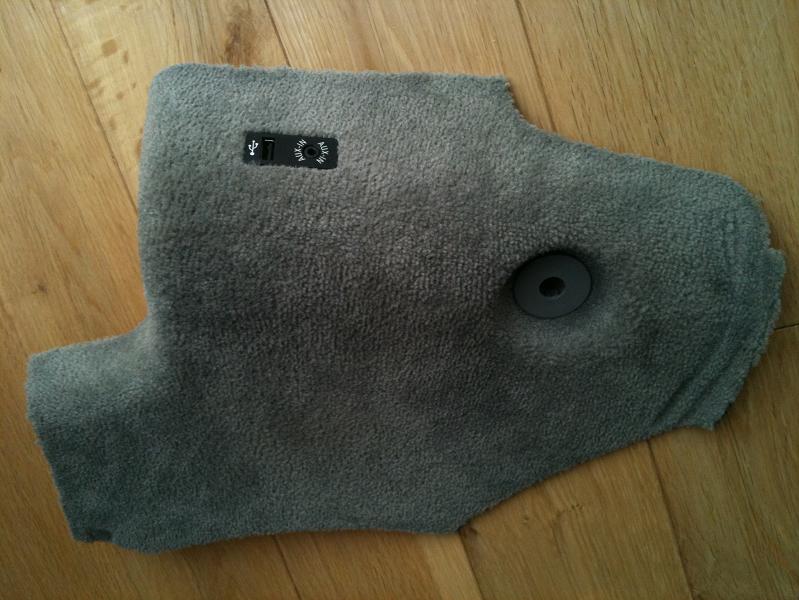

Well, you'll be pleased to know you can install USB and AUX socket from latest BMW cars, since Audi do not produce these dual sockets yet.
The 3.5mm jack is connected to AUX input on the back of RNS-E and USB is connected to the source of 5V to provide charging for your phone. You can now listen to music from your phone and even charge it if you want to. There are plenty of cables in eBay which connect to your phone or iPad with one end. Another end forks to 3.5mm jack and USB socket for charging. You put your phone into documentation shelve or into your door pocket and that's it.
I know there are not so many folks here with RNS-E here, but if you're interested in this mod I will provide more detail on request.
