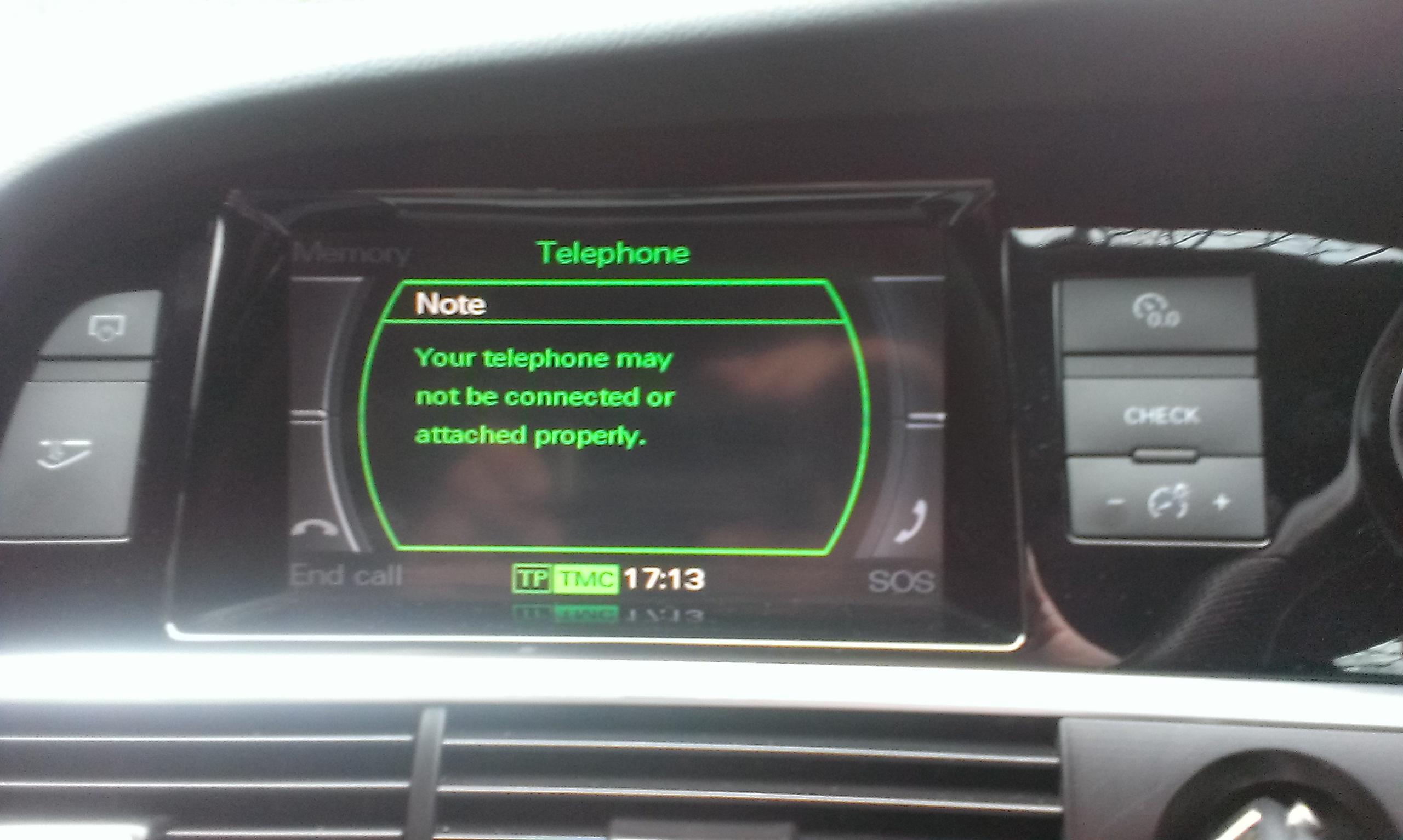

2 questions come to mind,
1) When you press Tel on the MMI, does it come up with the Tel screen implying the module is present and working ?
2) Anything on VCDS ?
From 2007 the Bluetooth modules were pretty solid, so should give you decent handsfree is nothing else

Oh, and the visibility is limited by default. Its only visible for a short while then vanishes to stop you meddling whilst driving....
Try it with ignition freshly on, and parked up
Old 11th April 2016, 03:59 PM
Also check under telephone, then settings, then Bluetooth should come up as a soft key option. Bluetooth may be switched off or made invisible

Thanks guys, was aware of the need to do it quickly as poss after switch on, attached a couple of phone pics of what I get, dont have access to VCDS here, on hols in lakes, should be able to get it scanned when I get home though.
