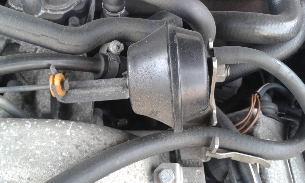

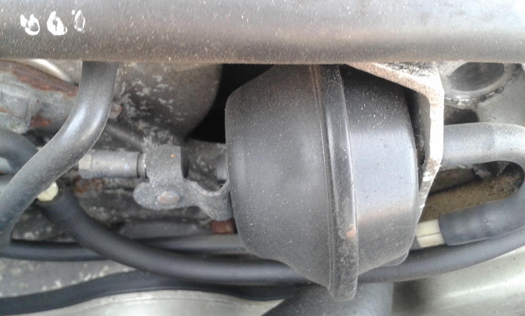

PF 8's also have similar for cruise control. Top picture show cruise control pod and bottom picture manifold pod for PF S8
ID:	13833   Click image for larger version

Ah interesting
Well the good old P38 Range Rover spares could help with those also.
