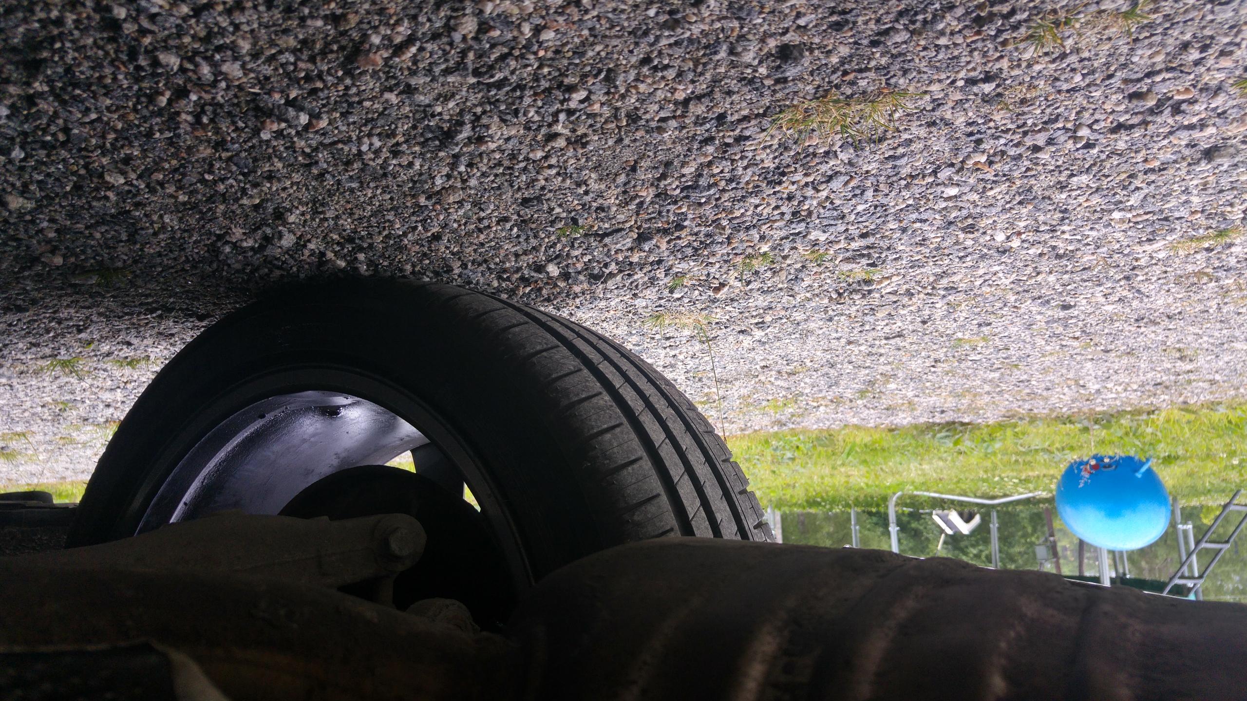

Hello everybody!
As the heading mentions I've struggeled with a leak from the L/H rear caliper. Wife had complained about a red brake warning sign in the dash.
The picture shows what I had conserns about.
(for some reason the picture turns upside down when uploading...)

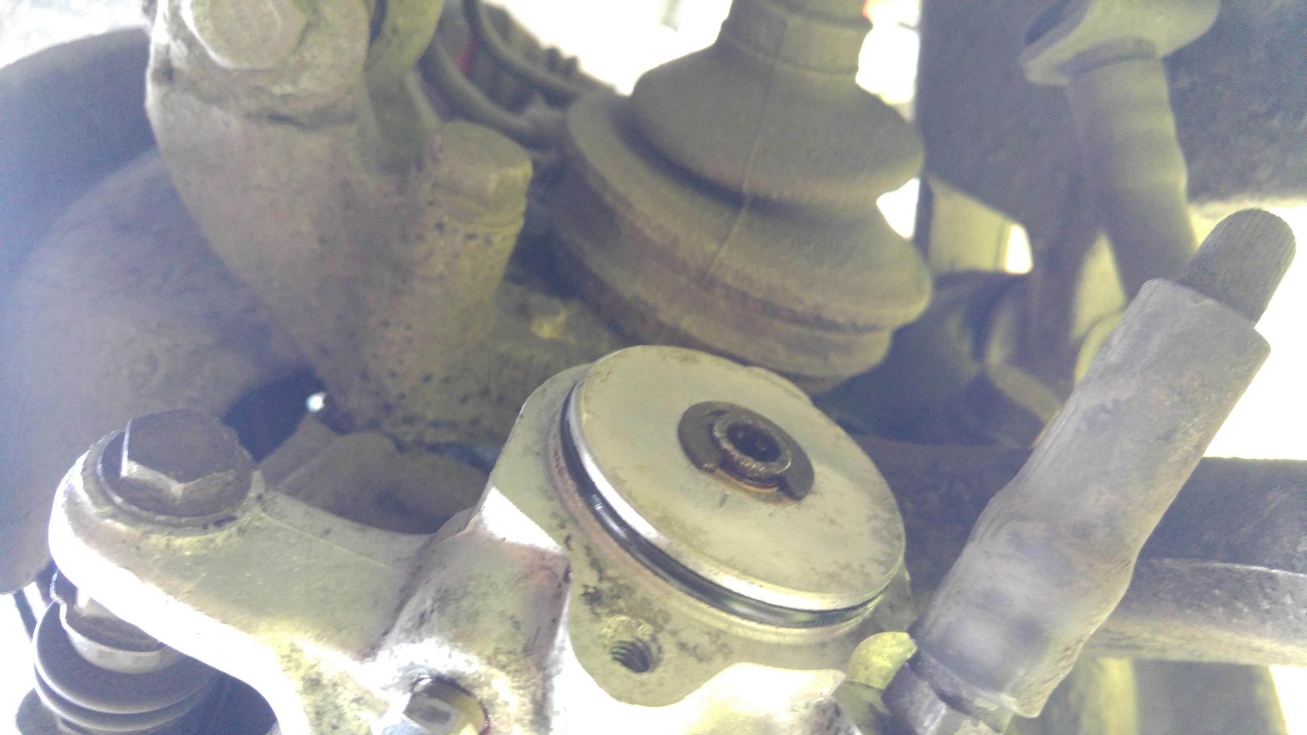

To isolate which side from the caliper that was leaking. I parked the car for two days, and drove it to work one day without applying the brake. The plan worked☺ the calipper had dried up.
I jacked up, removed the wheel and applied the brake and voila! 2 seconds and the leak developes as the picture shows.

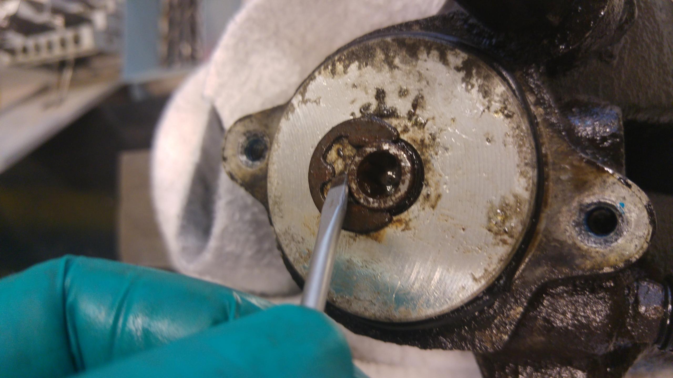

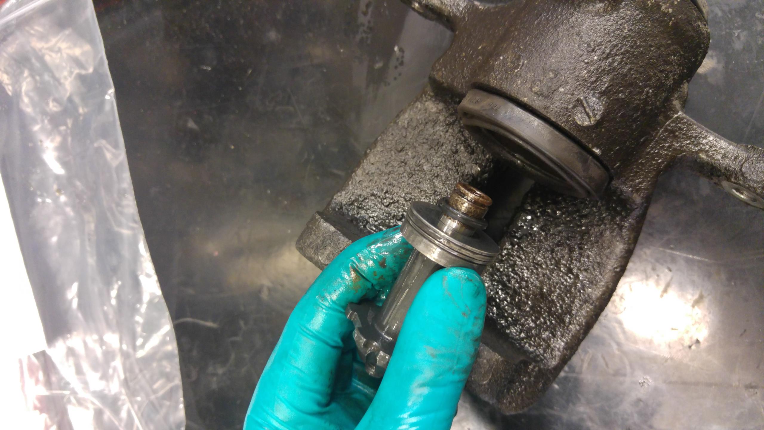

The problem really is a "chain of events" 1.st The cover for the E-brake has cracks, this 2.ndly leads to moisture enterring the area where the axle enters the brake caliper, 3.rdly this causes the axle to corrode as the picture shows. 4.th the corroded axle "chews" the O-ring and causes the caliper to leak.

So replacing seals is just a time extension - but its better then the option at the time being.
The housing can be "fixed" with sealant
Getting a long term fix for the axle is a more complicated matter.
Anyway - calipper is now reassembled with new seals - no leaks☺

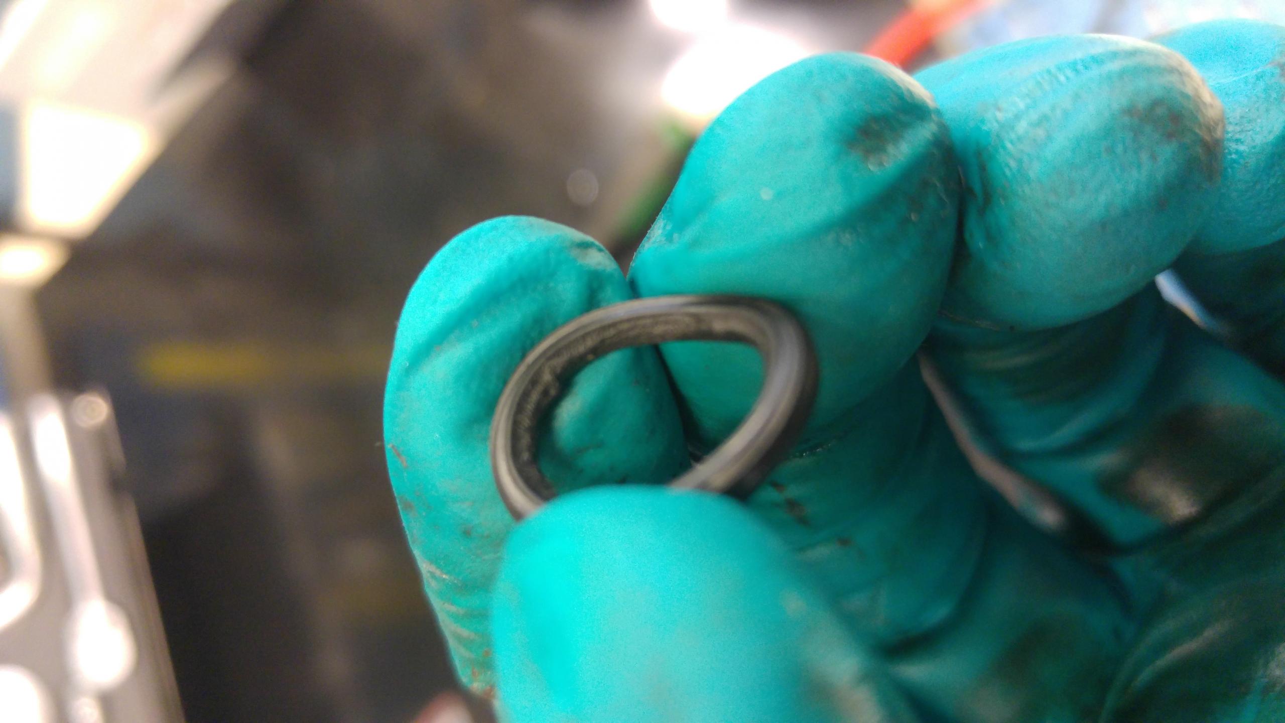

All 3 grooves was filled with old grime. I sand blasted the caliper housing, but only gently scraped the grooves for the piston seal and dust cap. The groove for the seal between the e-brake was incredibly full of crap. As the picture shows the O-ring is forced out of the groove. With the caliper body blasted, and new O-ring greased up with dow 55 O-ring grease it looked awsome
