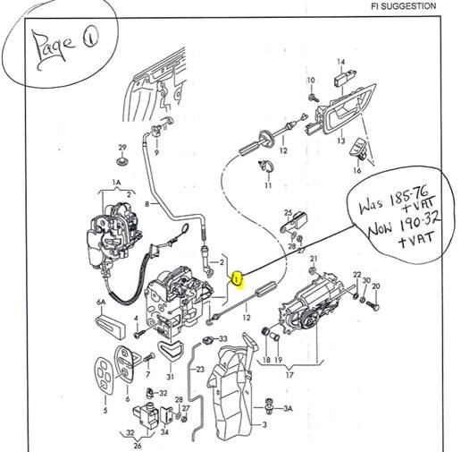

Here's the diagram i got from the dealers....they're saying it's Part 1...but that appears to be the locking module, nothing to do with the handle...
Bit confused tbh...
