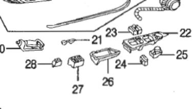

Old 18th November 2016, 02:06 PM
Its OK . I am easily confused
The door lock switch is item 27 in the picture = 4A0 962 107. or am I on the wrong track again.....
Name:	Door Central Locking Switch.png
