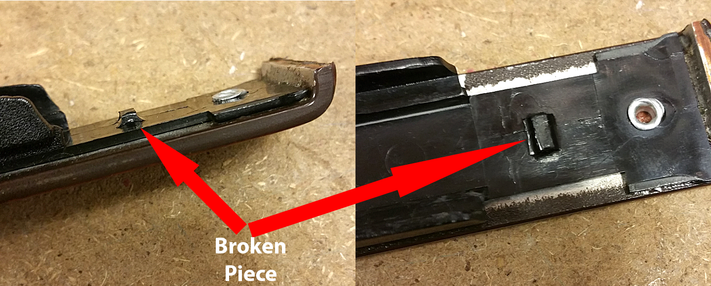

My wooden trim was broken when I got the car so I don't know what was on the end of the small broken nub:
My thought was to fasten this tiny nub back on to the small bolt-like thing that you can see going across the inside of the top of the handbrake (when the wooden trim is removed). My solution was to cable-tie it using a very thin Wilko 200mm long cable-tie.

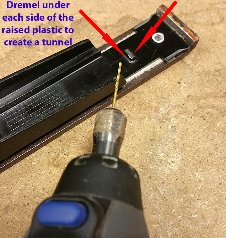

But first I needed to fasten the cable-tie to the wooden trim so I used my Dremel and with a small drill bit, I VERY CAREFULLY dabbed and drilled either side of the nub to create a tunnel. I didn't want to drill into the wooden layer on top of this piece of black plastic so it was done a bit at a time. I could feel when I had pushed through the black plastic and was about to hit the wooden plastic attached to it so it wasn't all guesswork.
I then slid my cable-tie through the small tunnel (more of a slit) and if it was too stiff I drilled a bit more out until I could slide the cable-tie back and forth without too much resistance.
