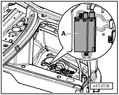

The front heated screen module is a slave from the Climate Unit. It's located in the boot near the battery.
Module identifier is J505 in the current flow and part number is 4E0910133.
