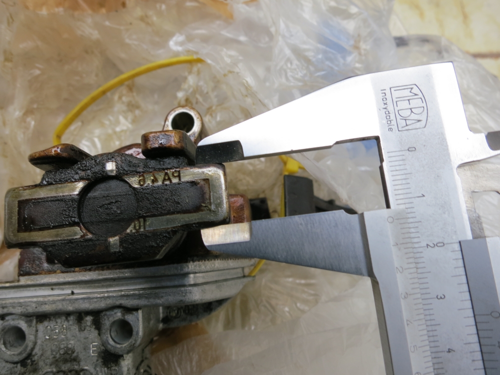

Me again
I wanted to check dimensions of the variator, so I got a cheap used A6 variotor from Ebay. Also allows me to practice putting on the macined pads (if I ever manage to convince someone to make them for me from that tough material).
The pads on this variator (mileage unknown) seem to be in pretty good shape, not too worn. I took one off a couple of times and it didnt brake.
If only Audi sold the pads separately I would be quite happy to stick in a set of new original Audi pads and change them again in another 100k miles.
Dimensions of pad mounting plate are 51mm x 14mm x 5mm, so the drawings I posted before seem to have the right dimesions for the mounting section.
The piston of this variator just comes out by itself, doesnt seem to have the locking pin that our variators are supposed to have that only release with sufficient oil pressure.
