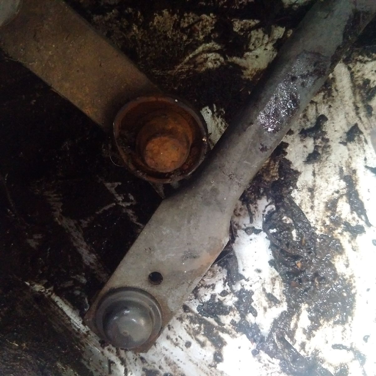

Arrow The Culprit!
Hi All,
So thanks for the tips, I got the scuttle off and tested to see what was happening.
The motor is working but this "Conrod" (see picture) seems to have come away from a "pivot / shaft" (in pic) which is attached to a bar which operates the the driver's side spindle and thereafter the wiper arm (clearly you ain't dealing with no engineer here...).
If anyone could help here I wonder,
1. Can this be drilled out in-situ and replaced with a a stainless bolt, spaced with nuts and washers??
2. If the whole assembly is removed would drilling out and putting in a Bolt work OR can just the conrod be bought?
3. Or is this a "replace the whole assembly" job? Laird, do you still have the assembly with the burned out motor??
Thanks again for posts already; I just wouldn't have had a go without the explanatory post from B@??? (Name escapes me! Daren't risk losing what I have typed!) and the tip to "have a look to see what's happening"!
Robert
3.7 to the stars... D2, LPG kit, March 2000(road tax...)
Old 23rd October 2016, 02:54 PM
Eww thats pretty bad. It may be recoverable depending on whether the plastic is worn away from the rust or not.
First step is to clean all the rust off the ball - wire brush and wire wool, some coarse sandpaper if you have it. Clean it up as much as poss, then give it a good coating of grease. If you can get to the other side of the conrod (don't think you can with it in place tbh) then also clean out the plastic socket and grease that. Then, see if the plastic socket on the conrod will pop back on to the ball. It should take a lot of force - mole grips or water pump pliers are good to squeeze it back together.
If it pops together easily then chances are it'll just pop off again, in which case another assembly will be needed afaik. I'm not sure the parts are even listed separately tbh.
I've been wondering about remanufacturing these things using proper ball joints, but mine is in reasonable condition so not made any progress on that yet.
Old 23rd October 2016, 03:44 PM
As MJ says its a press fit joint and perhaps may go back together after a clean. However, it does look pretty worn and may well be beyond repair. The only problem with a second hand unit is that the linkages may well be worn too and it will be a "slapper" at best. I exchanged a unit with The Laird and so at least one of his (the one with the good motor) will be worn - I am sure he wont mind me saying this . The one I got from him has been OK but is now over-running on full speed. I have thought about ways to adjust the the linkages as the motor is OK and I am sure that the unit comes with motor/arms etc.
Sounds like MJ has a business opportunity upgrading wiper arm units!
