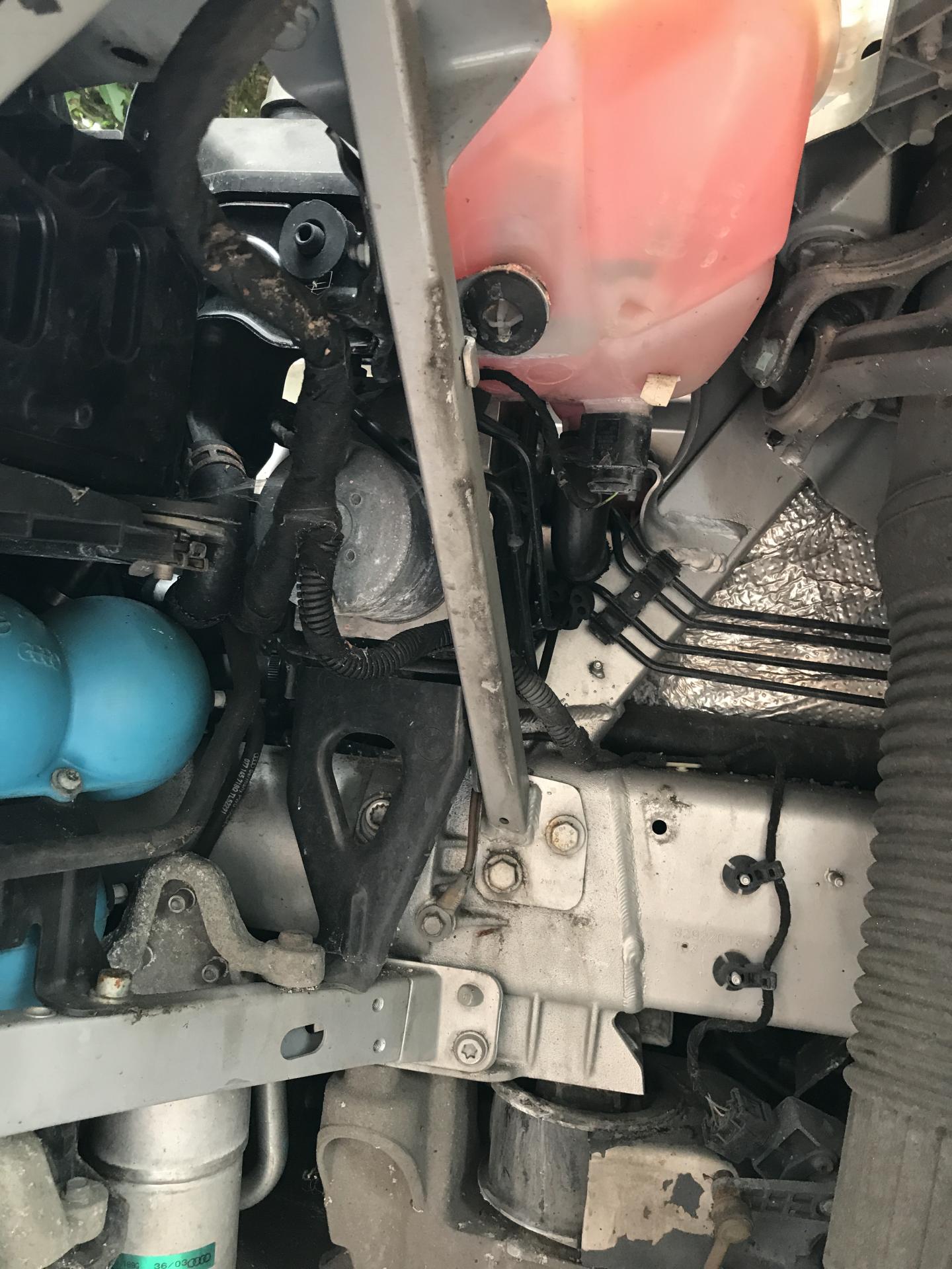

Still cant see it with the passenger side wheel and cover off
Any Clues? Do I need to remove the under cover too - power probe at the ready!!
