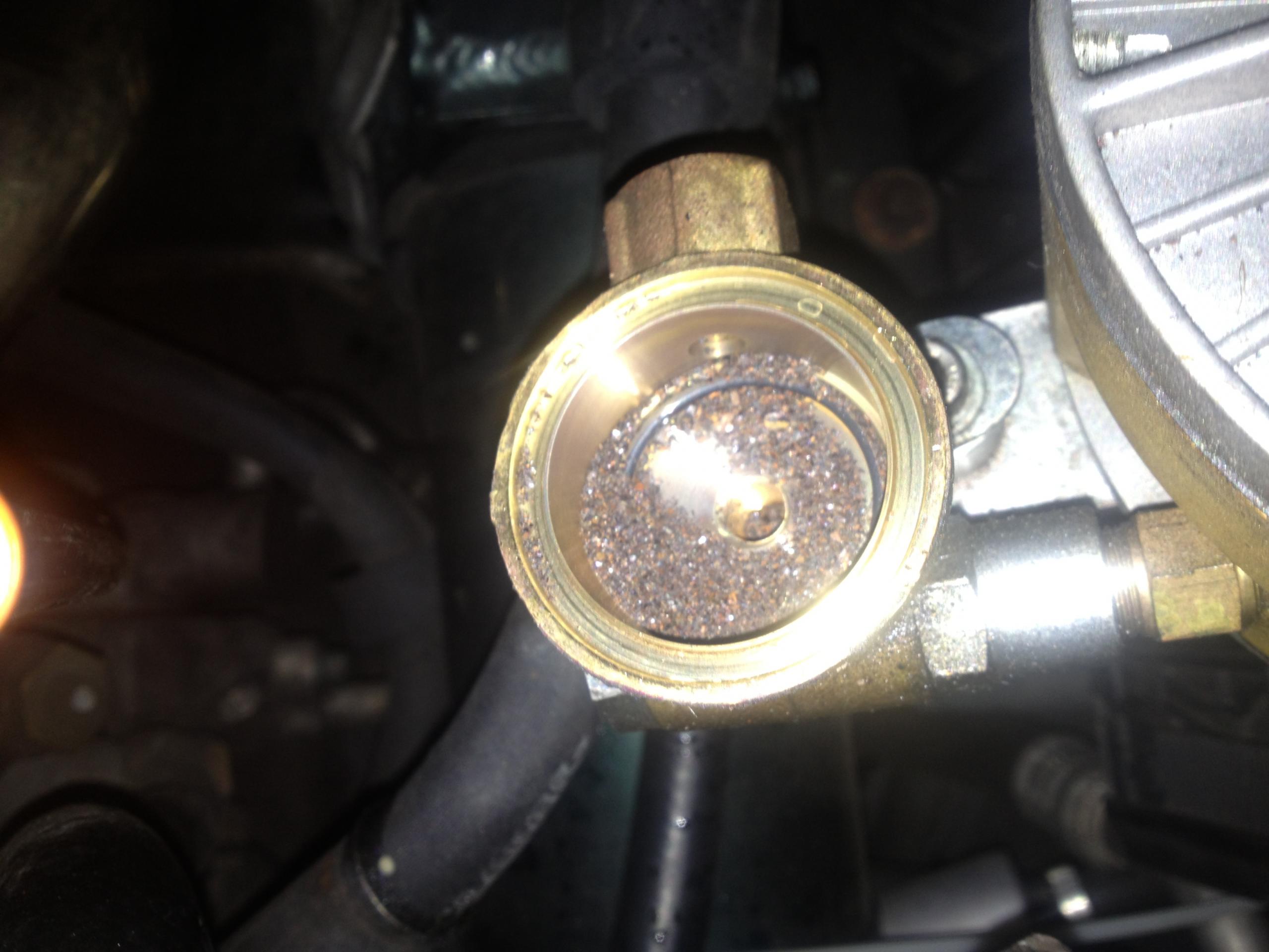

Hi Folks,
Maybe one for Steamship (or members who had LPG on other vehicles; this is a generic post).
Over the past few days the car has "fallen off the gas" in the middle of journeys , not under hard acceleration. After pulling over it went straight back onto gas first few times but now is struggling to find the gas again.
Any thoughts?

Hi it could be starving it causing a low gas pressure to switch back to petrol. as well as the filters that need changing periodically. the solenoids being magnetic collect all the rust and iron filings out of the storage tanks and your gas tank. the reducer can stop working properly from heavy ends gumming it up. so if you've done a lot of miles it could just need a service. by a specalist or yourself if your competent the LPG forums are very helpful. this is what i found in mine.

Starvation seems likely, when the gas "falls off" it won't come back on...
We did the journey down nicely, fell off once, picked back up. Return I ran 90 miles on petrol, double the price but we got home sweetly...
I will look on LPG sites too, thanks.
