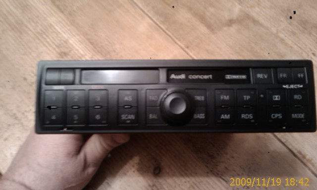

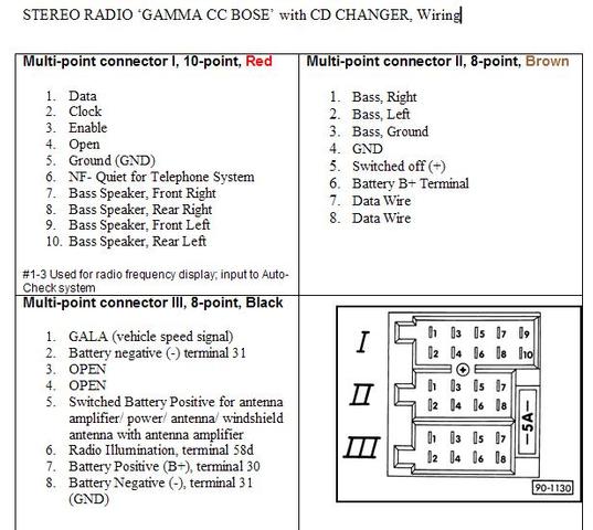

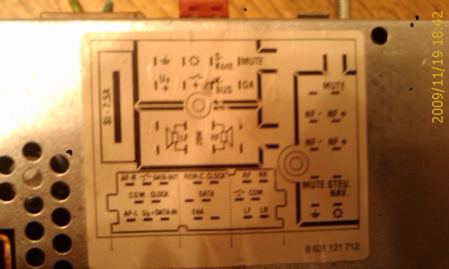

but i found this today..the 1st piccys my stereo with the picture on it of the wirring ..and the seconds on i found on audi com...but..me being thicker than an offspring of a chicken couldnt wire it in as i dont know what the abbreveations mean,,,,also rang the garage that installed the shark fin on the roof and they said they did wirre this into the power suppluy to the old electric aerial
But on my new stereo it only has ...
two red leads one marked power and the other B+
one orange marked electric antena
One brown lead negative
And 8 speaker wires 4+...4-
Im sorry to sound thick but can anyone help me to connect the right leads,at present i have power and just the front speakers on
