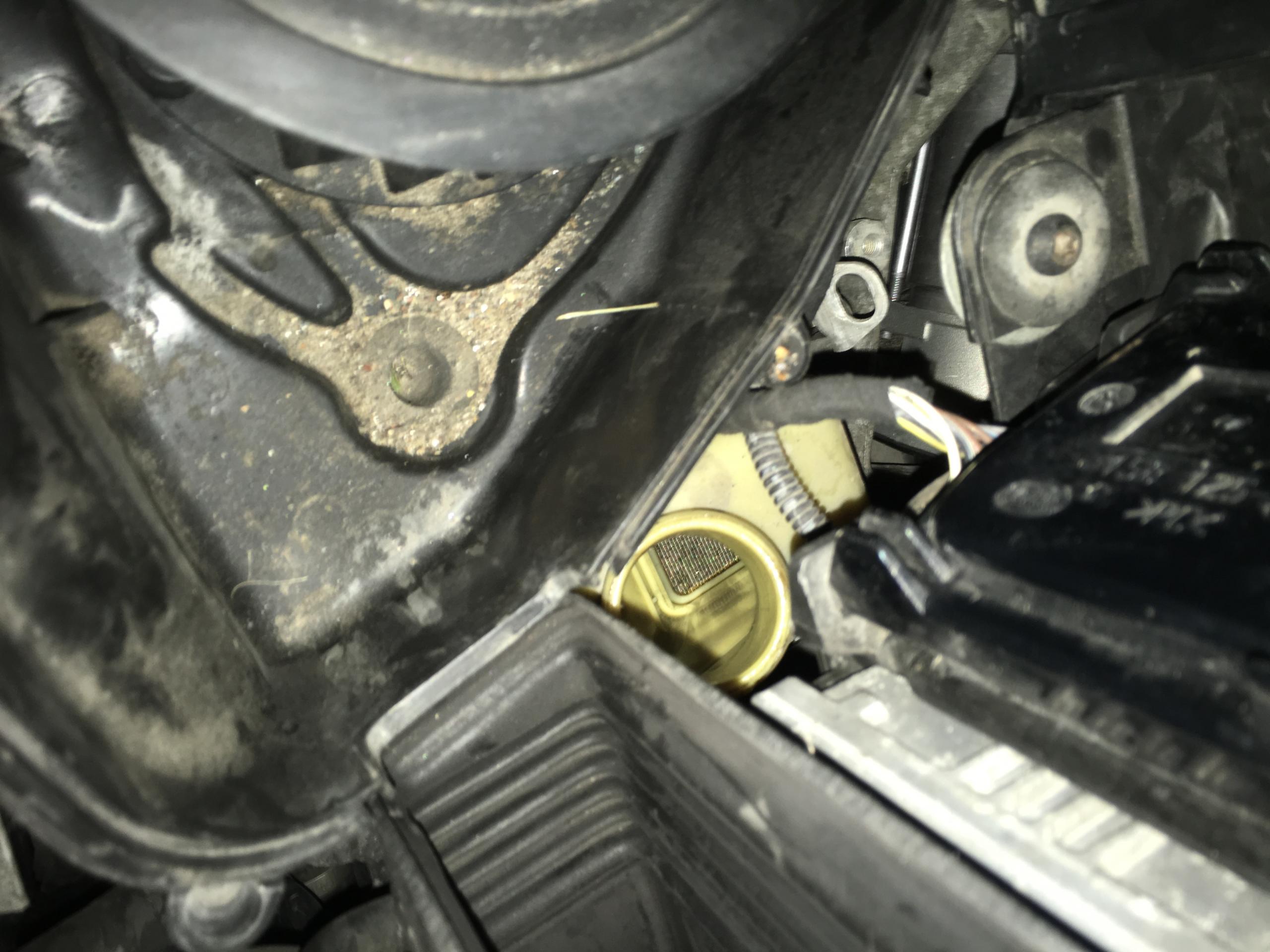

lordchris lordchris is offline
Join Date: Oct 2017
Posts: 81
Yes mine was black, it was a pain in the ass to get too.
Air box needs to come off- I think I left the bottom of the air box in and was able to work around it.
I had a Wee syphon lying about that I used to suck out the old stuff then just refilled.
Give it a go
Old 22nd December 2017, 03:53 PM
Join Date: Oct 2017
Posts: 81
U will need a funnel or something to refill

Pic of it
