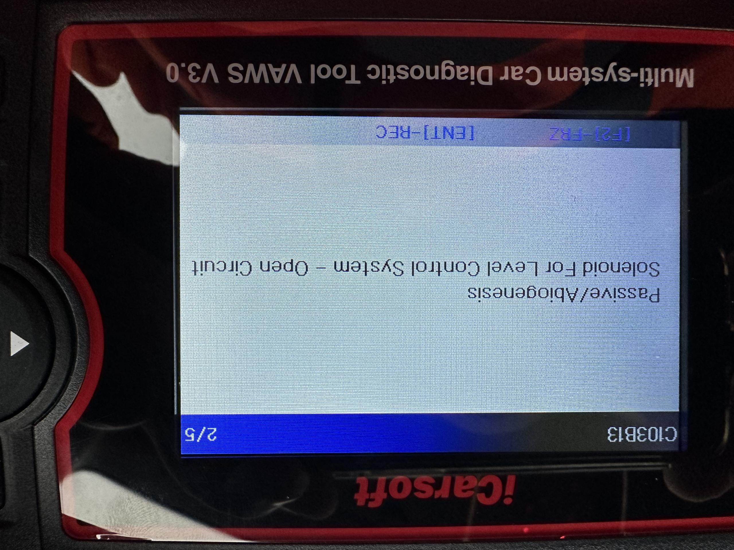

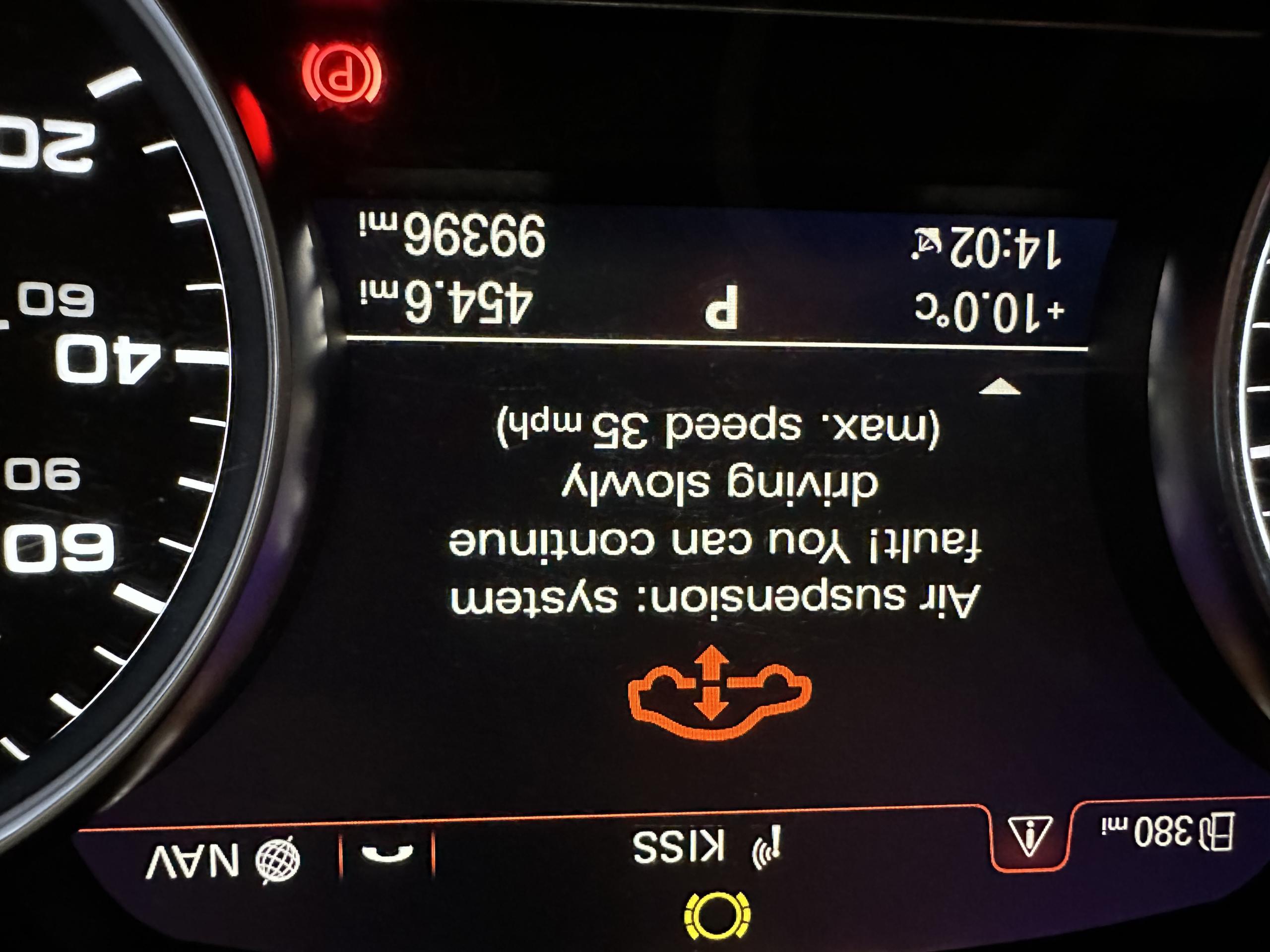

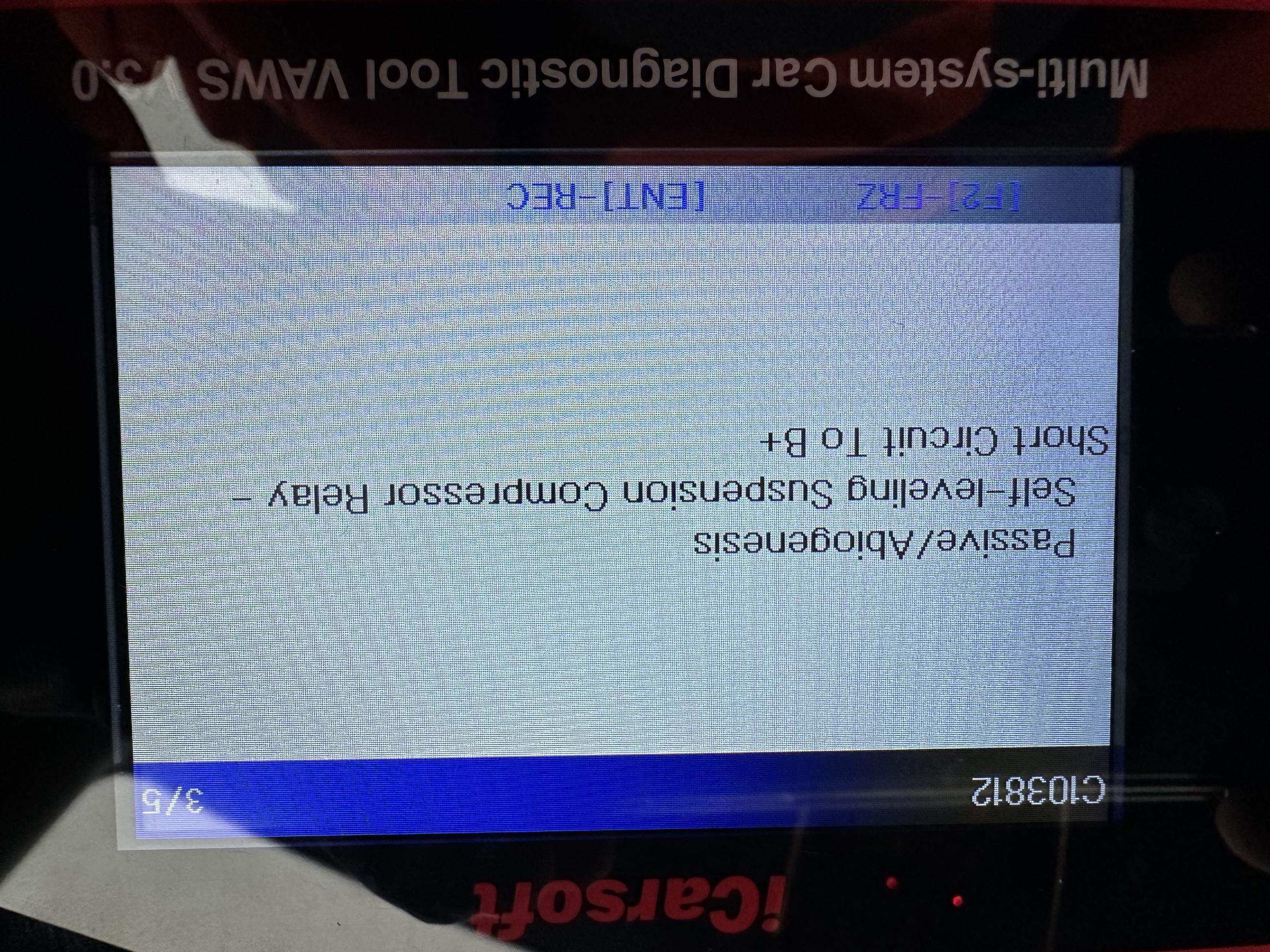

I am attaching the errors on the dash and what my little tester shows me
