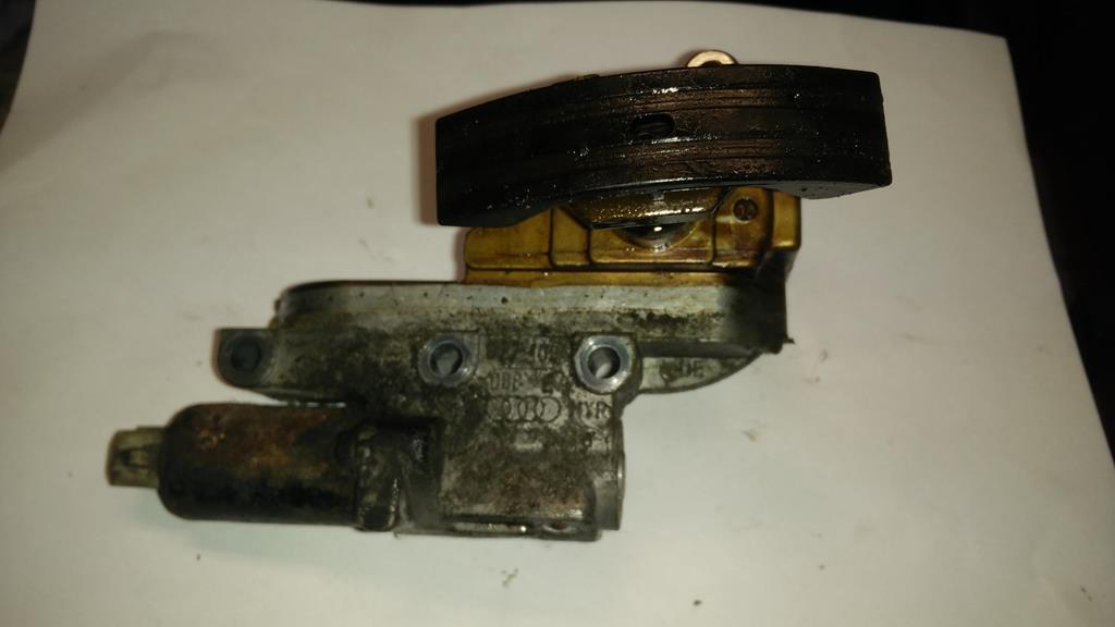

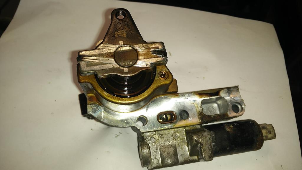

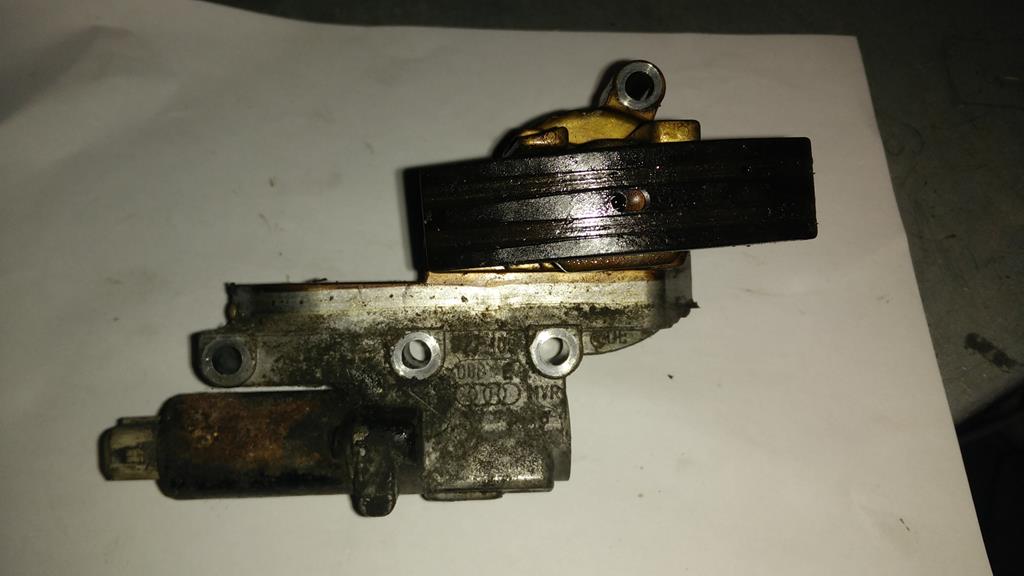

Pulled the cam covers and had a look at the tensioners. A bit of a tramline on top, but not terrible
Underneath, not so good!

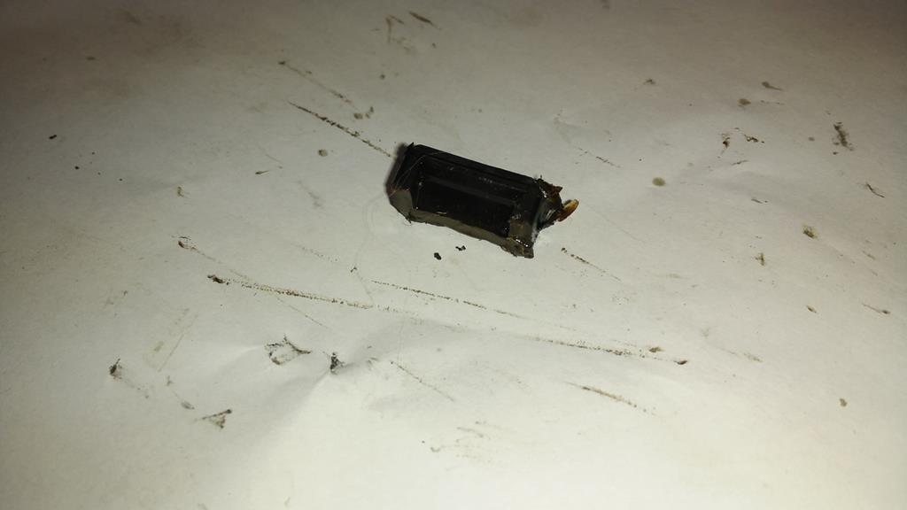

This is all that was left of the tensioner pad in the head!

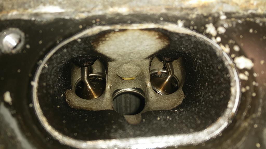

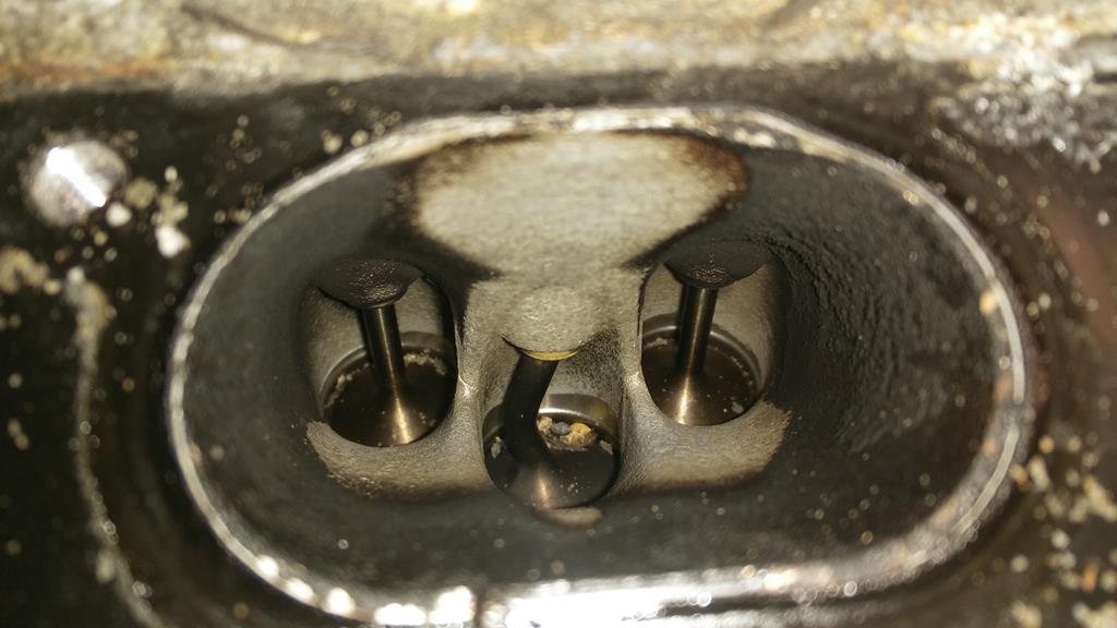

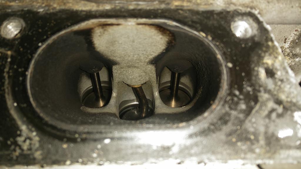

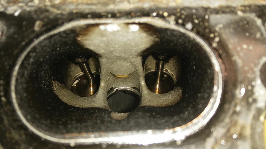

Pulled the inlet manifold next. I know these can contain little surprises, and as expected it had a bit of a rattle. Two inlet valves! They're not supposed to be in there

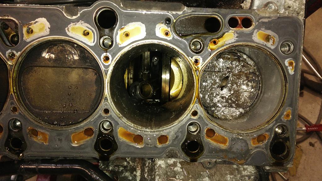

Cylinder 1. Oh dear. Thats one of the inlet valves.
Cylinder 2. Aaand thats the other one
Cylinder 3
Cylinder 4

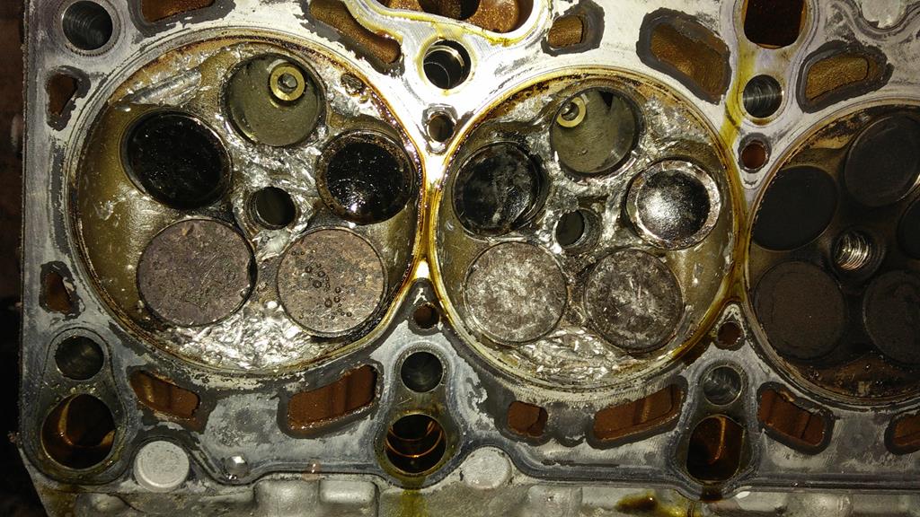

Off with its head!

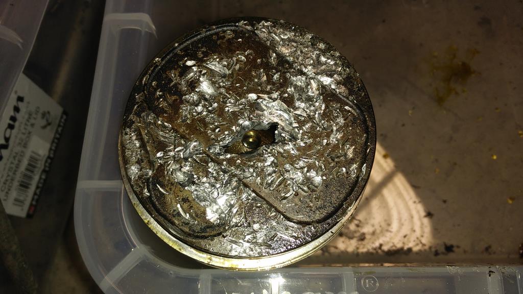

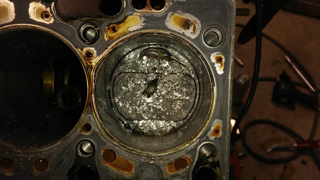

#1 has a hole in it

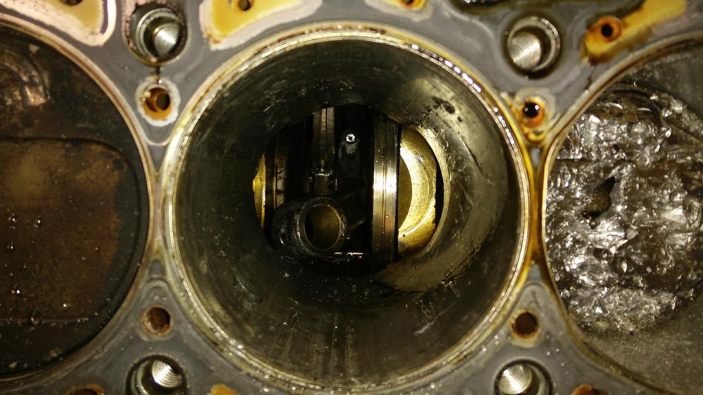

#2 has, um, gone

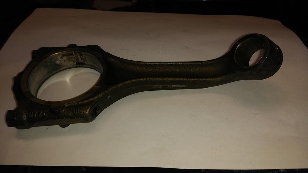

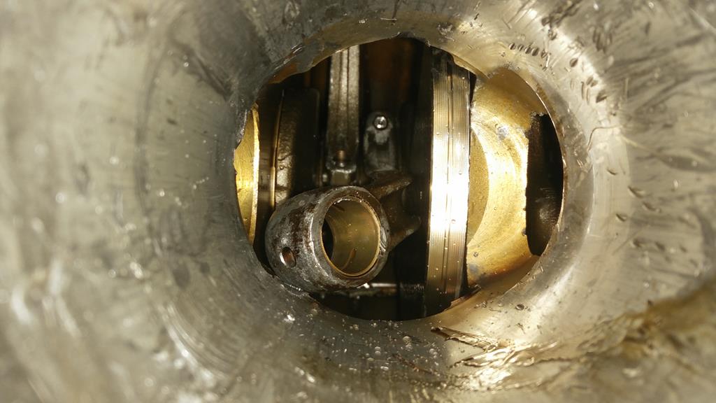

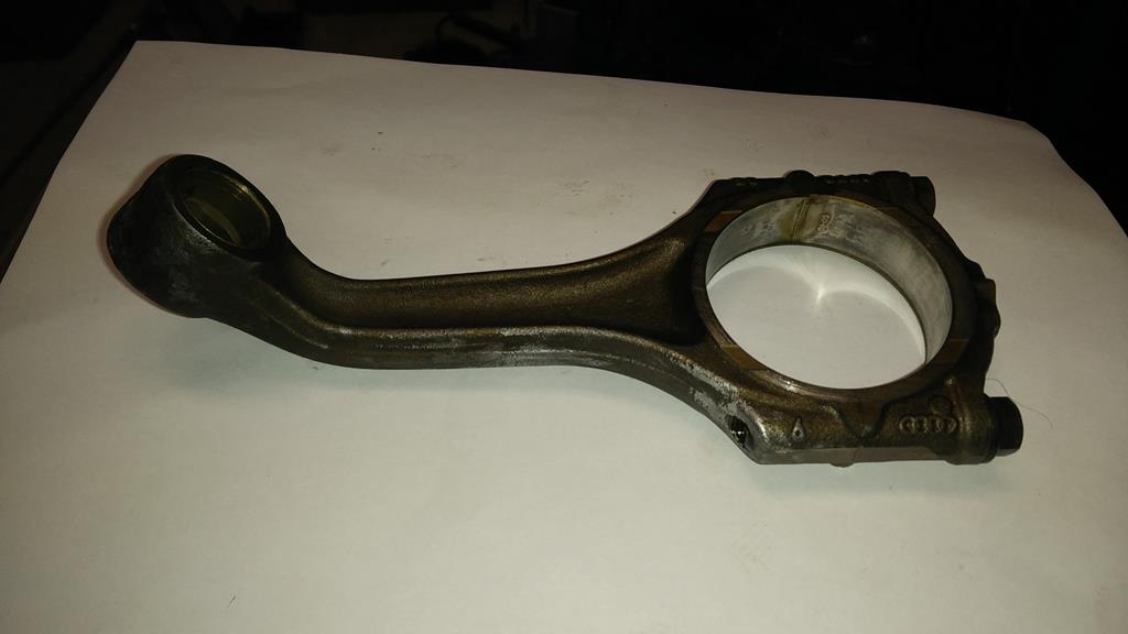

#2 rod is bent at the end, but amazingly still attached to the crank and still moves smoothly!
The head did not fare well The other head is also damaged due to bits of exploding piston going through the inlet manifold and in to the cylinders on bank 2
#2 con rod. Amazing it didn't break since the 40v rods are supposedly the wek point in the engine.
#1 piston has a hole in the middle

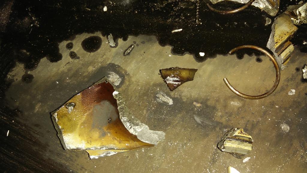

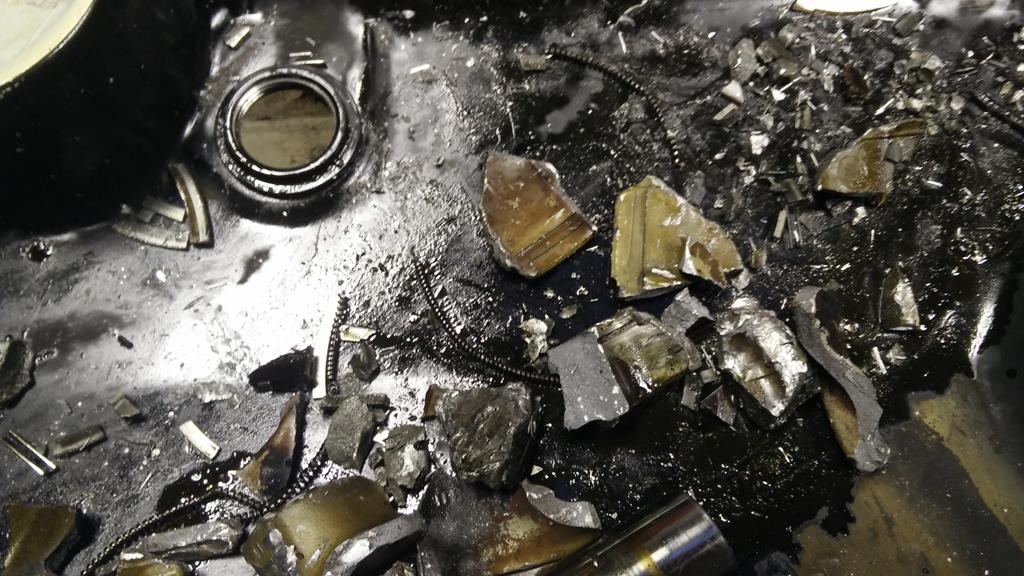

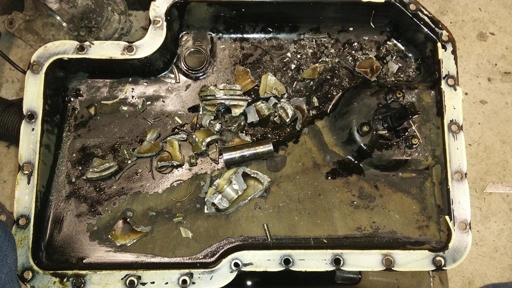

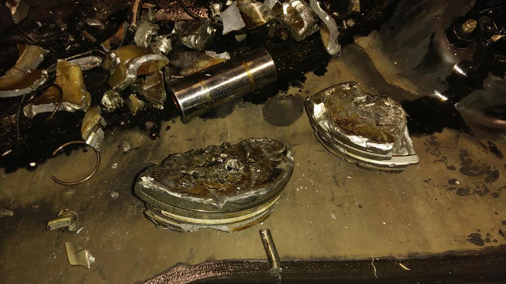

#2 piston is in small bits in the sump!

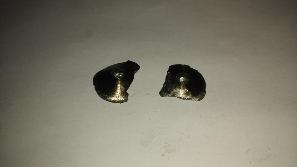

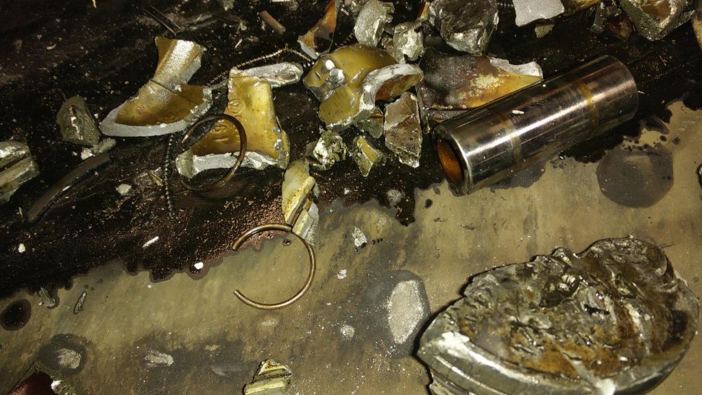

These are the two largest chunks, plus the remarkably unscathed gudgeon pin. You can see a 15mm piece of valve stem at the bottom of the pic - thats all I can find of them. No idea where the rest went.
Pin circlips and some bits of piston ring
Another tiny bit of the cam tensioner pad

Old 26th January 2019, 08:21 PM
One head is mashed, as is the piston where the valve dropped, but the bore is mostly ok. There's one tiny ding in it but the piston moves past it smoothly so its recoverable. All it needs is another head and the one piston. It won't ever be perfect, but I'll just put it in something disposable for a laugh

I'm sure you could fix it though MJ!
Interesting how it seems to be the middle inlet valve that's bent in each case. I suppose the interference is greater/closer for that valve?
Old 27th January 2019, 12:08 PM
Yeah that one has the least clearance.
