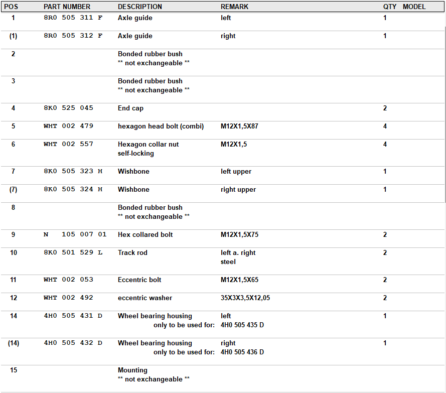

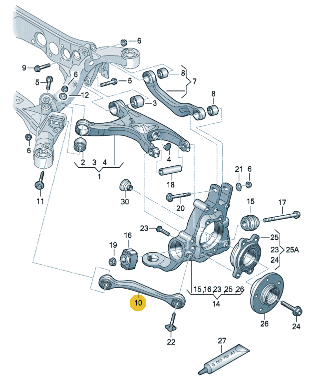

Here is a diagram of the rear axle, with the 'track rod' number highlighted (10).
The part number is 8K0501529L and both left and right are the same. The price in ETKA (mine anyway) shows a price of £53.40. With that in mind, and the price you've been quoted, I'm wondering if your description and the ETKA description are misleading somehow.
I've also attached a couple of screenshots showing the part numbers for everything else on the rear axle.
