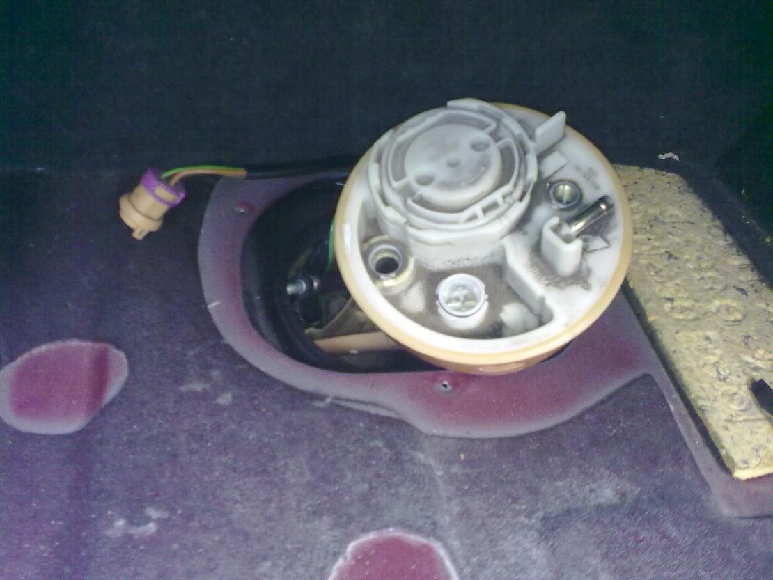

I'm in the middle of attempting to replace the fuel pump in my '95 4.2 QS but I can't seem to get the fuel pump assembly out of the tank . I've been in the boot for about 45 minutes pulling and twisting but it just won't come out . Do I need to drop the tank to get it out or am I just missing the technique?
I'll add a pic of were I've got it to in a minute.

This is where it is right now...(see attached pic)

i think there is a write up of pump removal on the audiworld forum, it mentions the way of getting the pump out, in the write up it says there is 1 section that has to go out first and then the rest of the pump follows easily. Can't remember details exactly, so i'd google it.....

Thanks for the reply B@fink. It was the sender unit stopping it from getting out.
Now that I've swapped the pump I'm having trouble getting the (expletive deleted) thing back in again. I can get it down to about an inch away from home but it just won't go. I'm trying twisting and a reasonable amount of force but it still won't seat.
