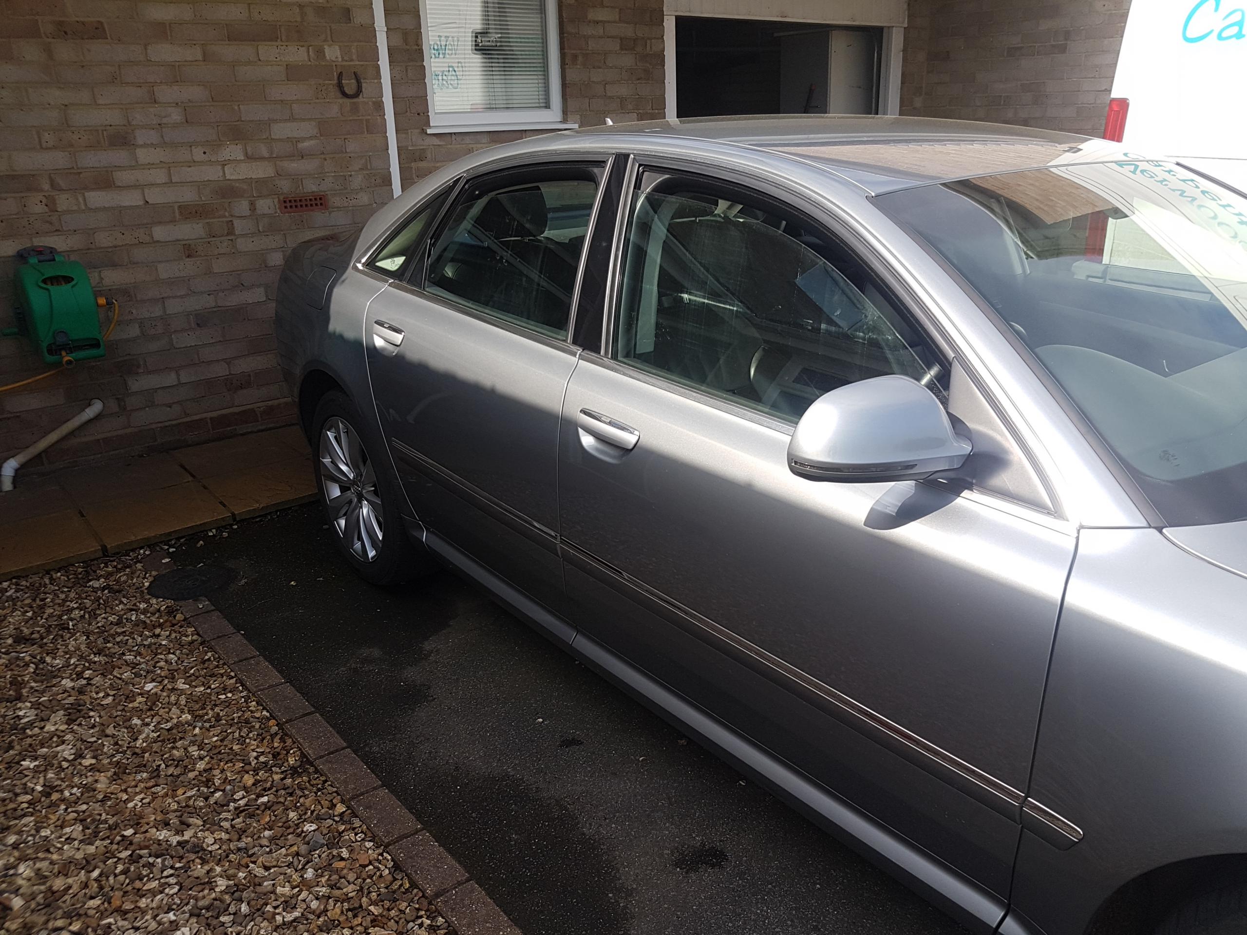

Well i purchaced 4 used handles from our forum sponsors and as expected got great service and they were delivered the next morning.
I have had a little opp so cant work for a few weeks so fitted the drivers handle today. So i have keyless on the driver's door again. 1 down 3 to go. Interesting that on mine only one handle has ever worked properly opening when you put your hand near and 3 you had to lift the handle twice. For the first year i thought it was tbe good one that was faulty 😶
Unfortunately the handles are more silver and my car is more grey so they arent a perfect match but it doesn't look too bad. I dont think most people will notice it but it will probably drive me mad.

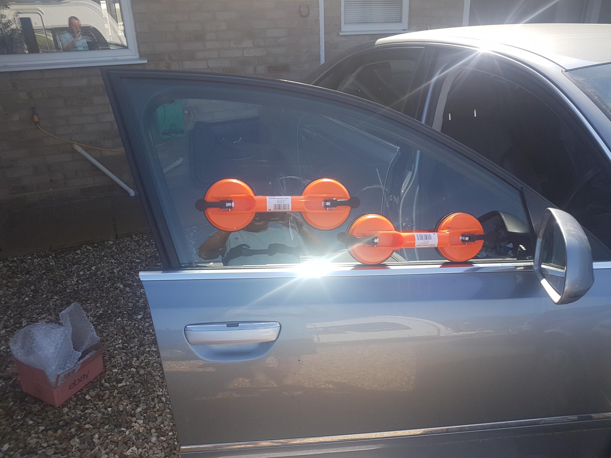

Well i did the rear drivers side hamdle this morning. Its a little trickier than the frints as its behind the window rails but with a little fiddling i managed to unplug and undo the rod retainer through the hole front outside whilst lifting the handle, this saves removing the window and window surround.
The second handle even though a little harder than the front took 45 minutes to fit and finish
