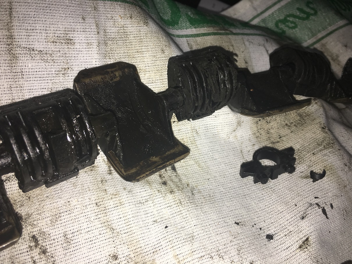

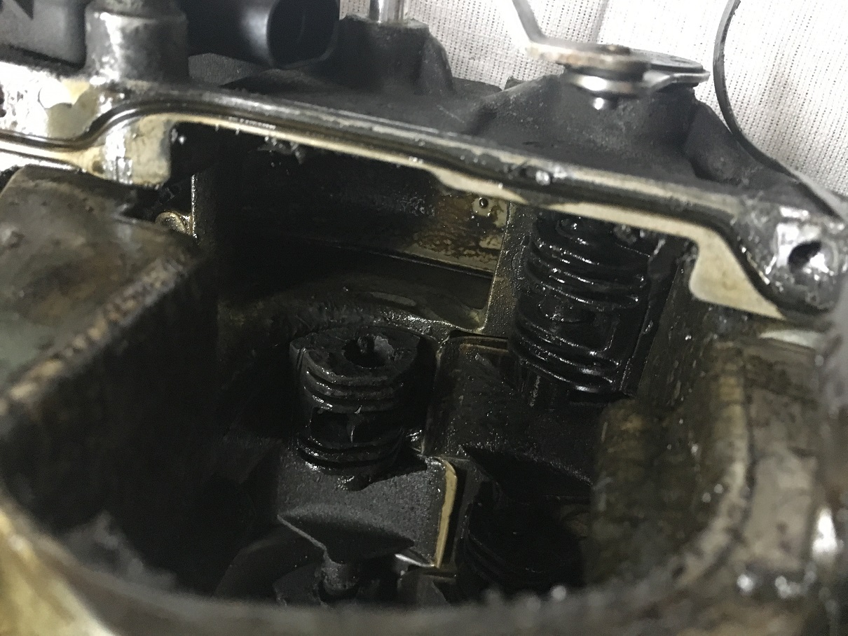

And this was the reason for it, one flap broken of laying at the bottom of the manifold and second one hanging up in the air.
Oil separator was faulty hence a bit more than usual of filth inside the manifold.

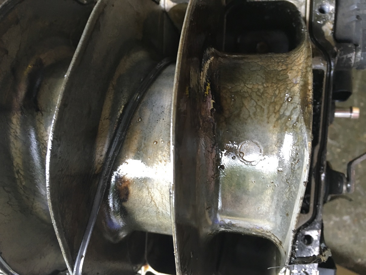

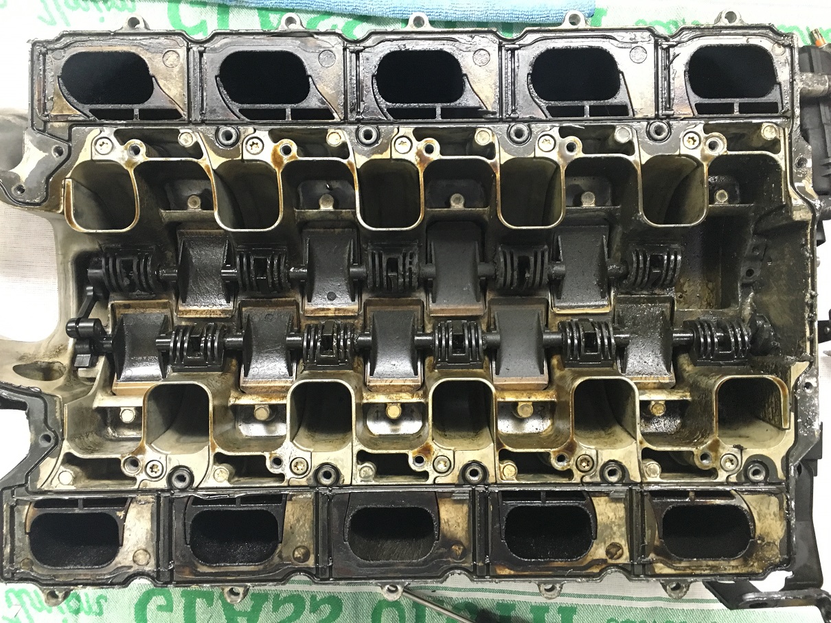

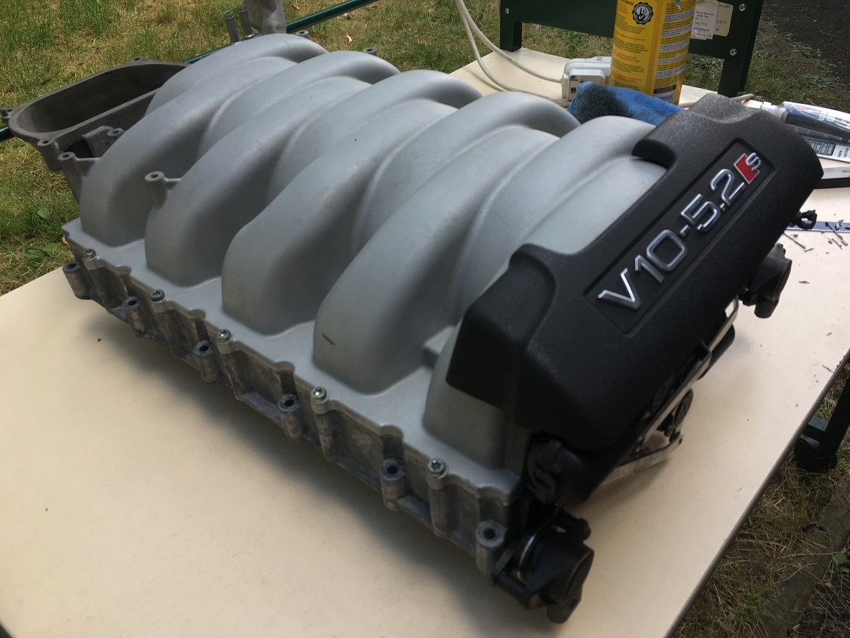

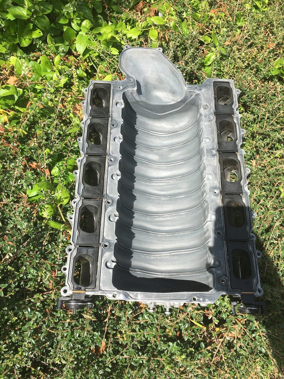

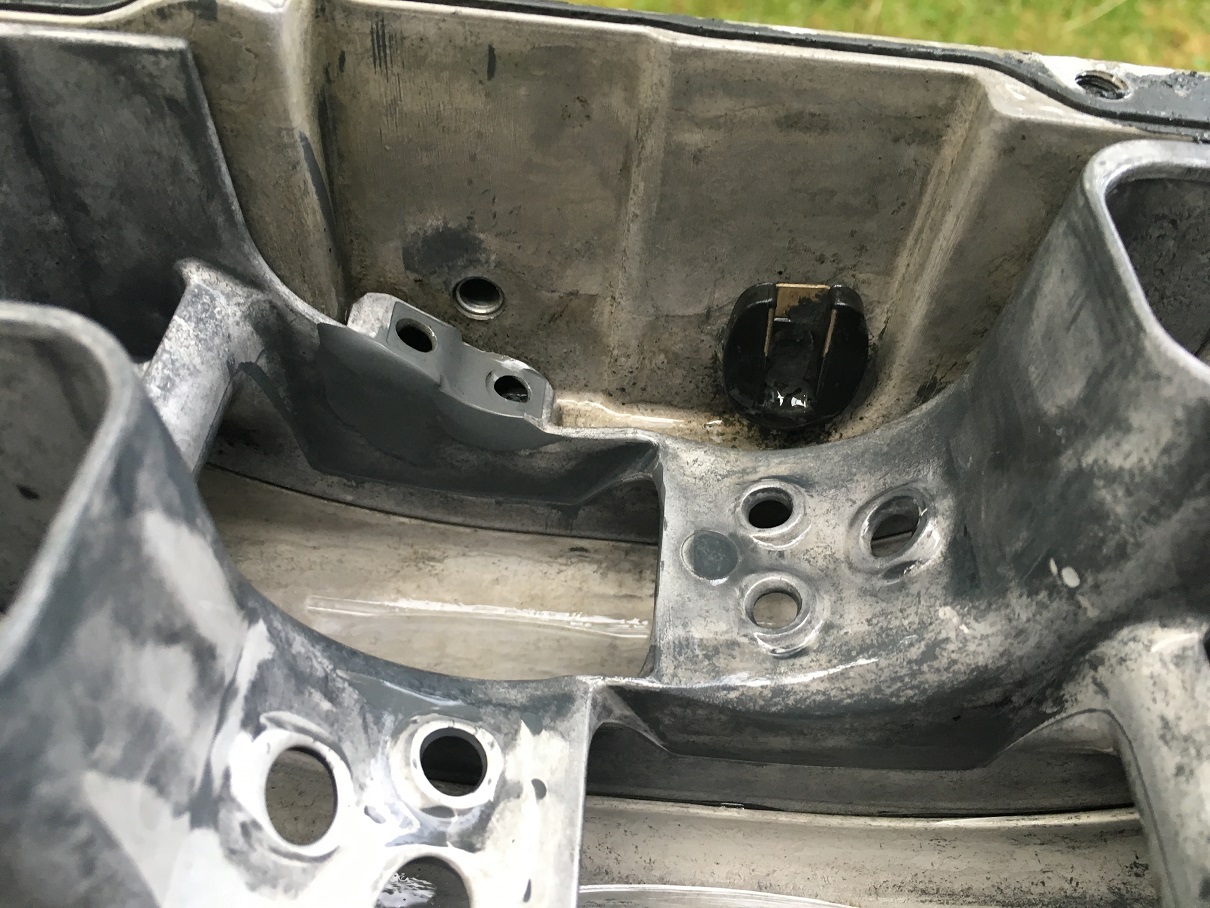

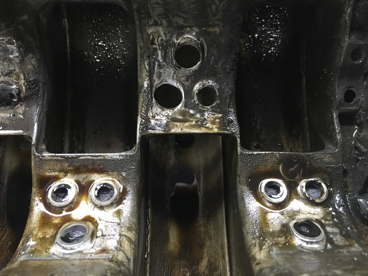

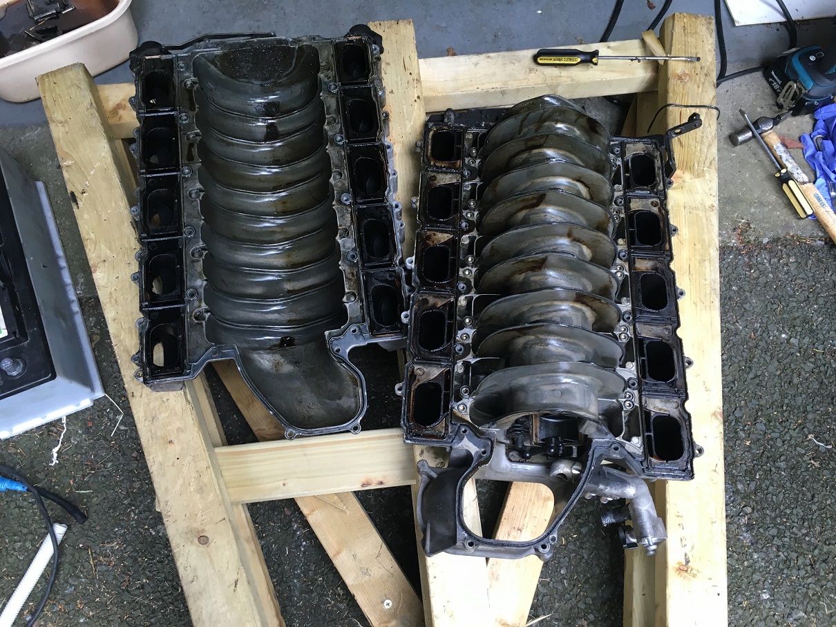

Here is the manifold with the bottom part removed.

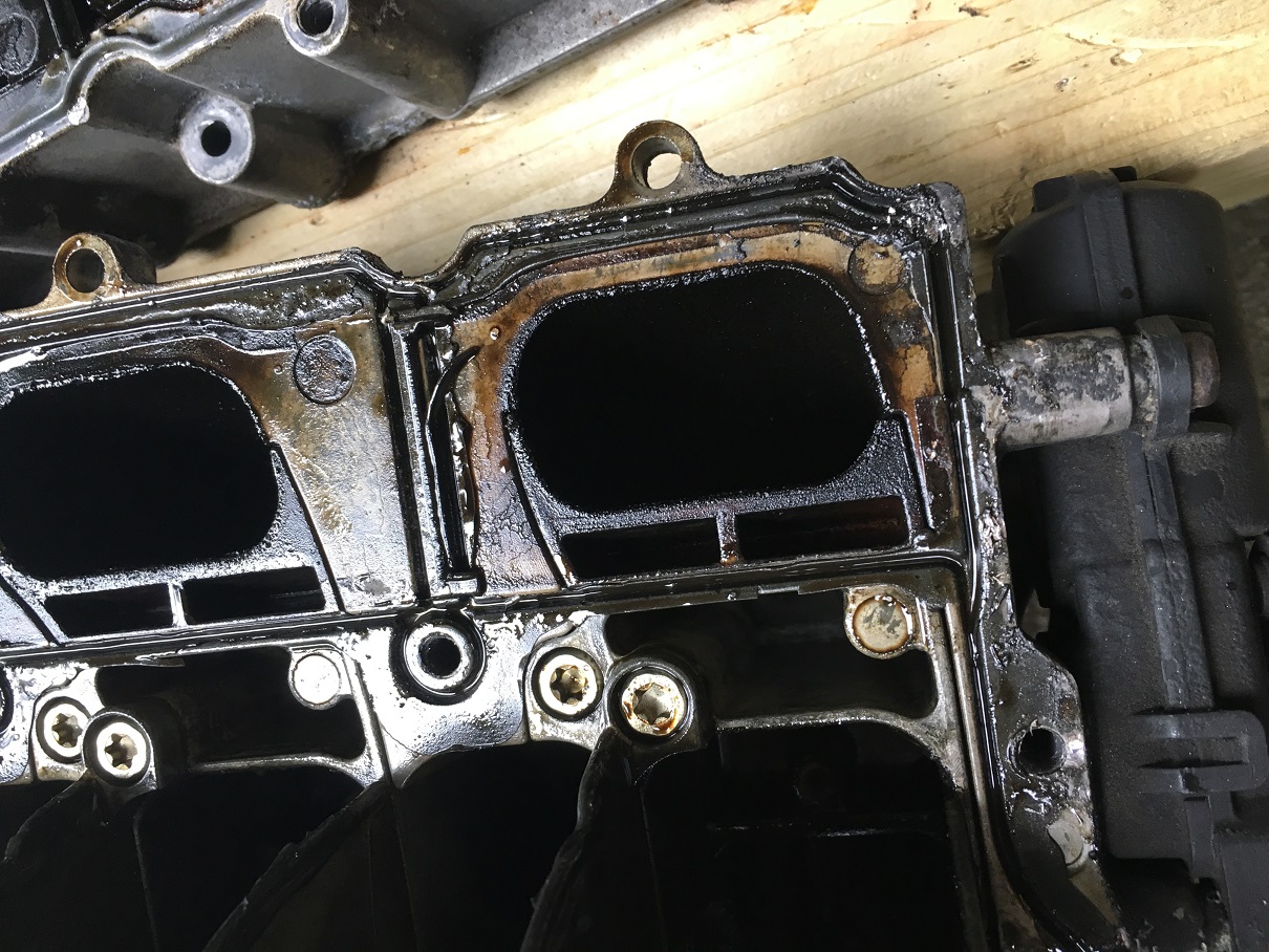

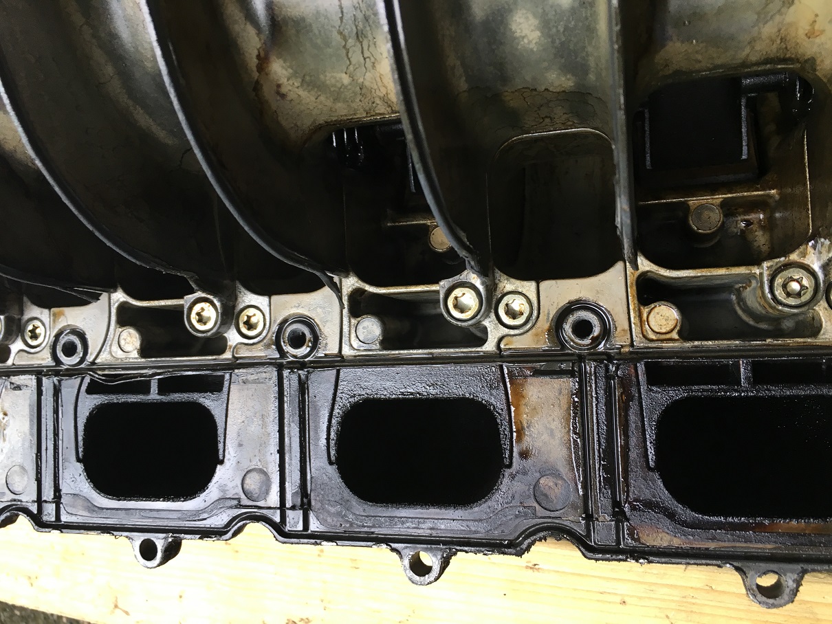

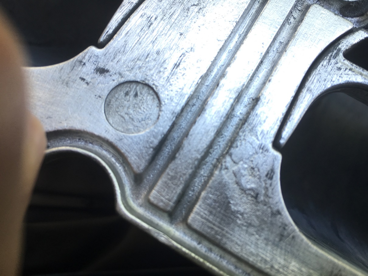

All the black/grey stuff around each groove is the silicon gasket, there is plenty of it around to be removed.

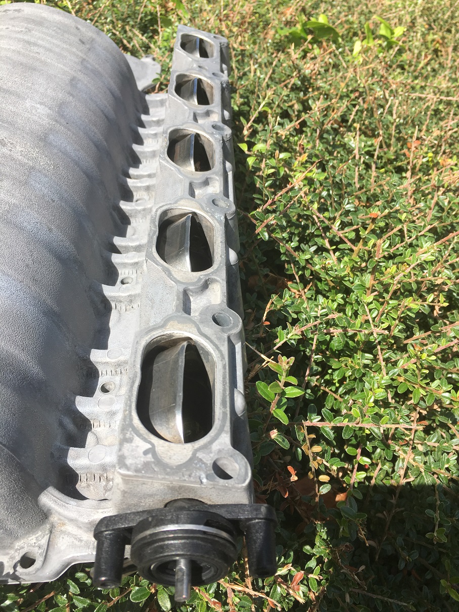

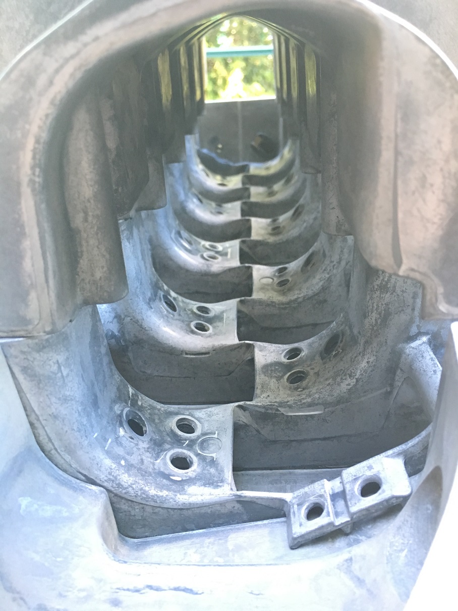

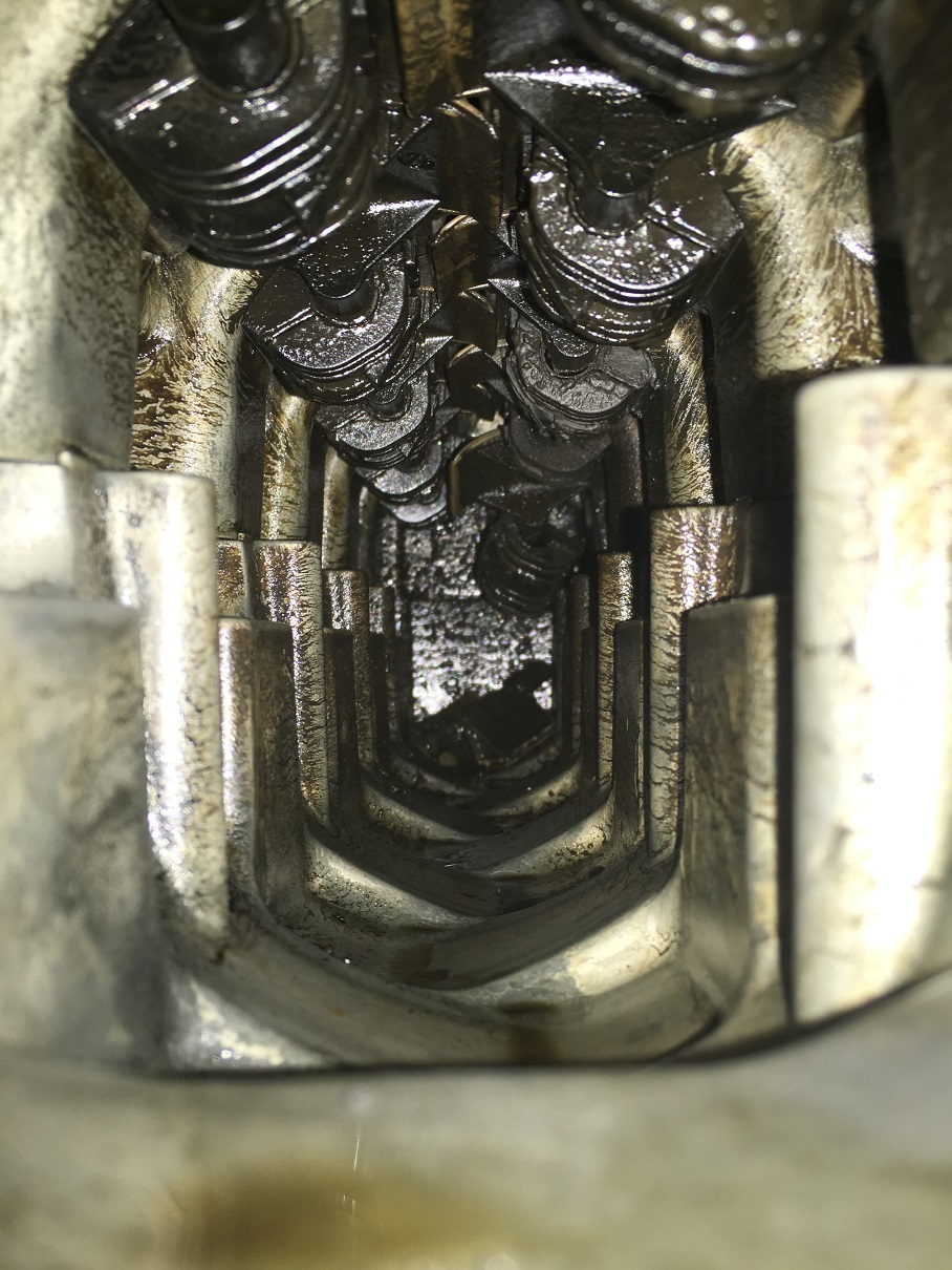

You can also see how the exits to each inlet on the engine are coked up as well (part I mentioned in the decoke thread which really pushed me into decoking the whole engine)

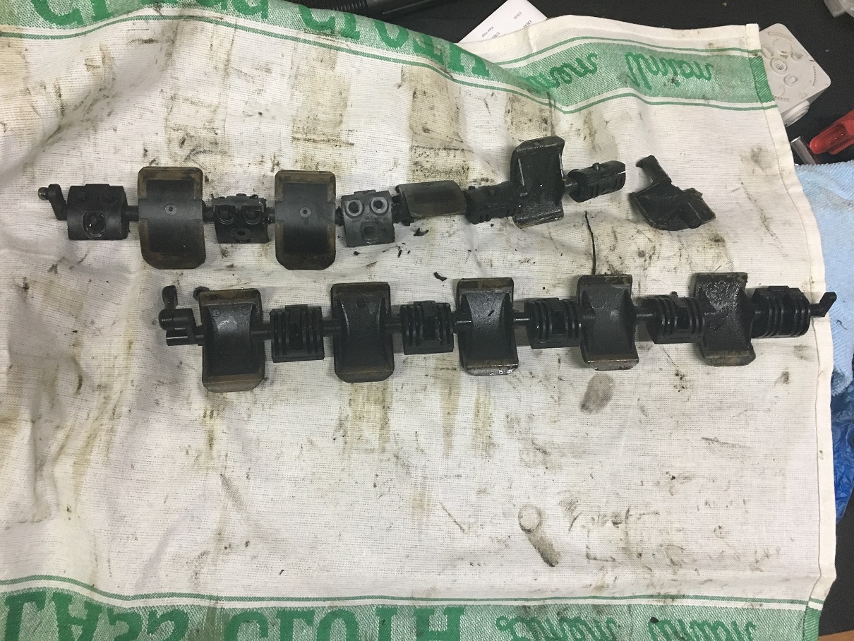

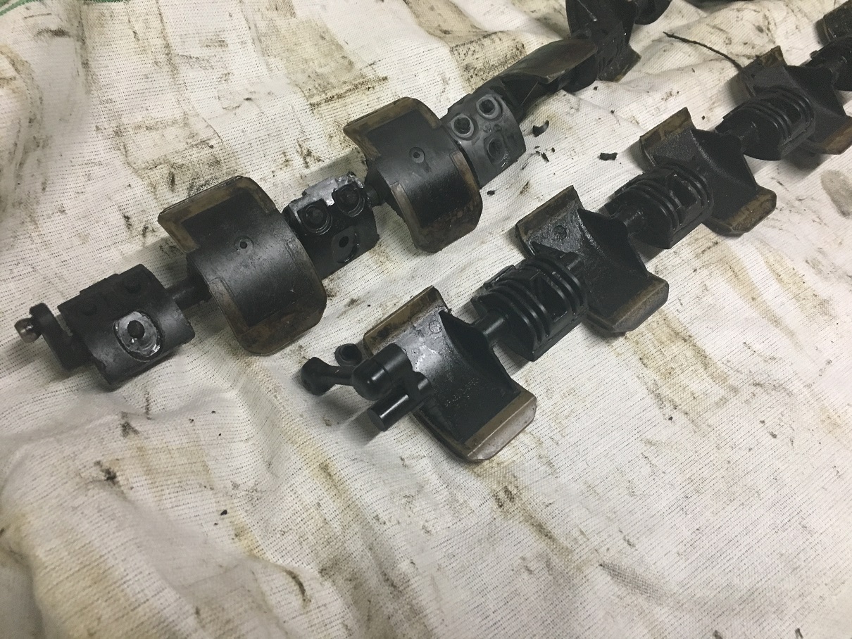

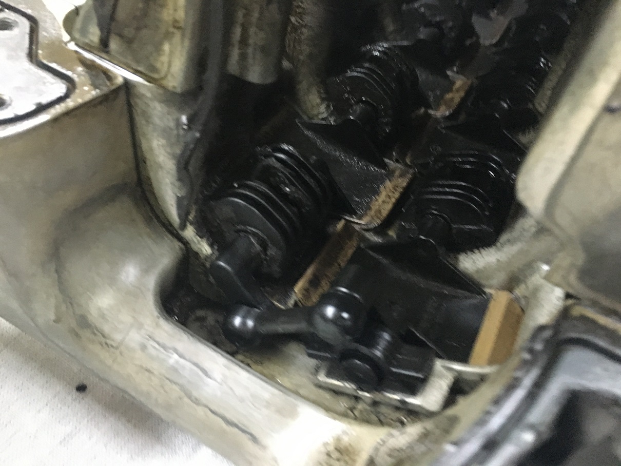

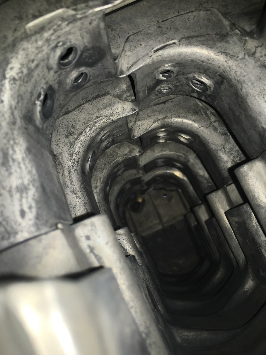

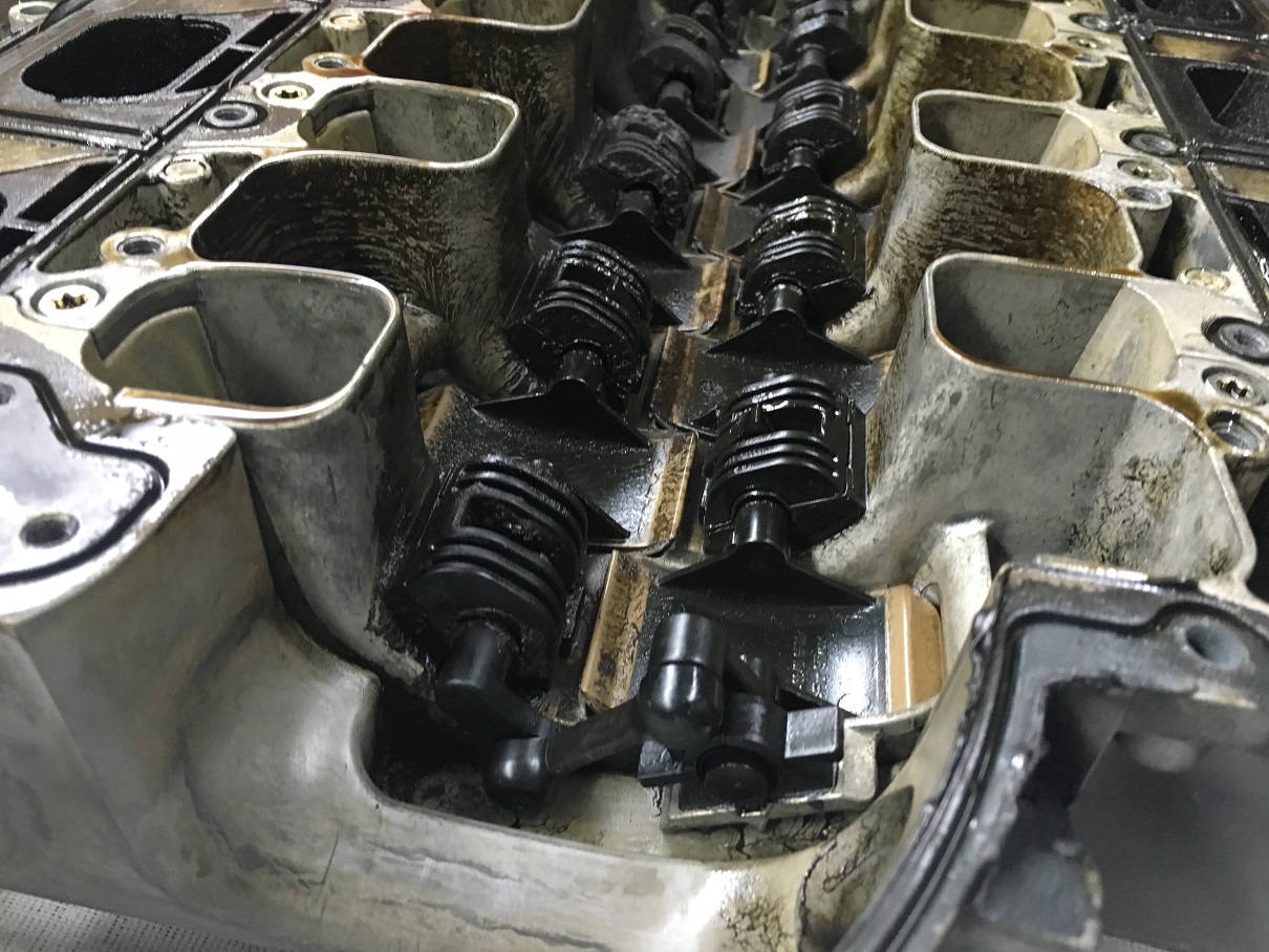

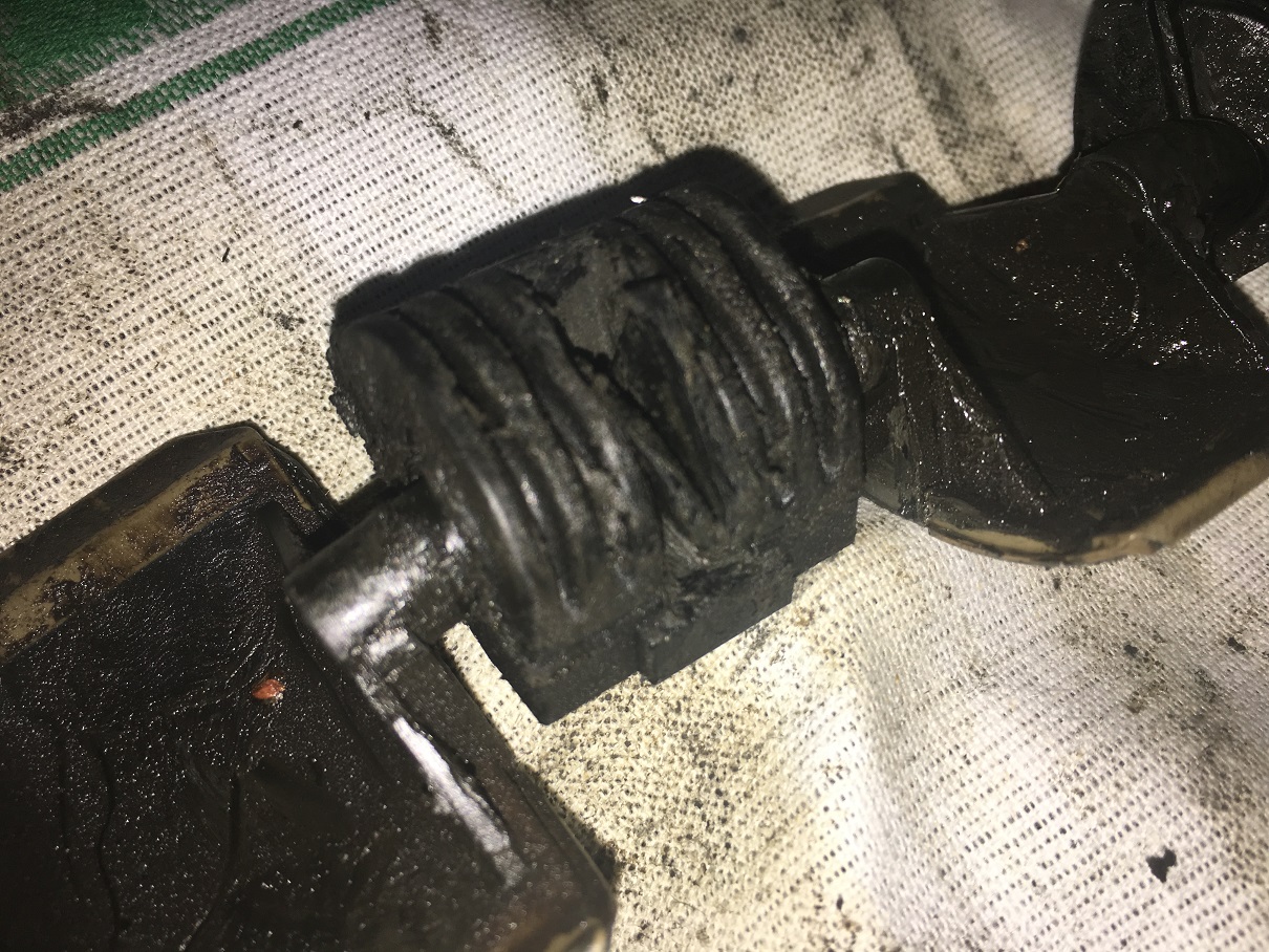

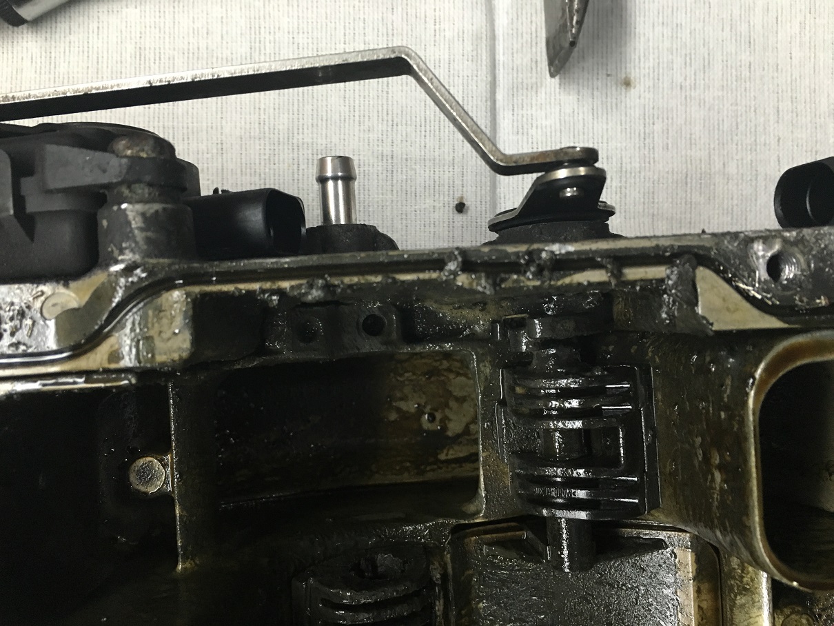

Few shots of the flaps

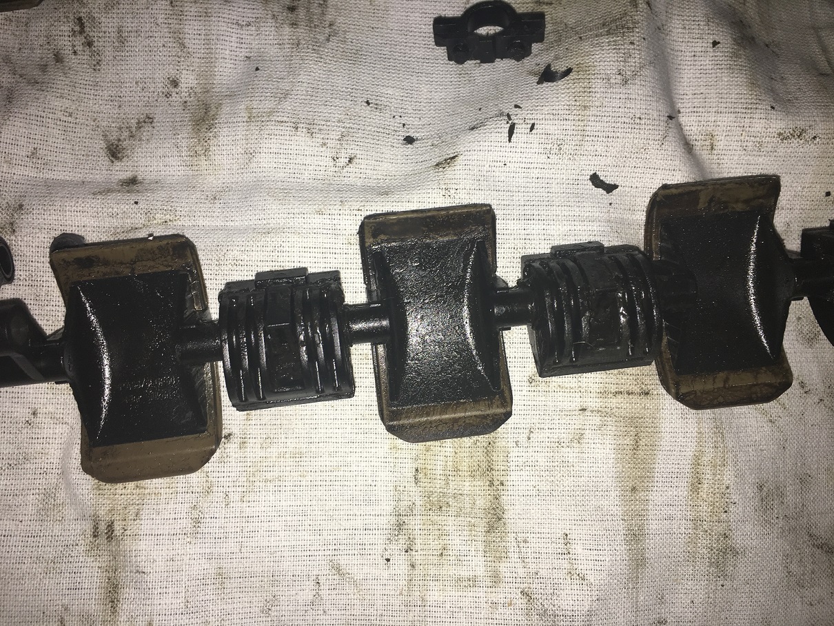

Flaps removed, actuator motors removed and manifold ready for cleaning.

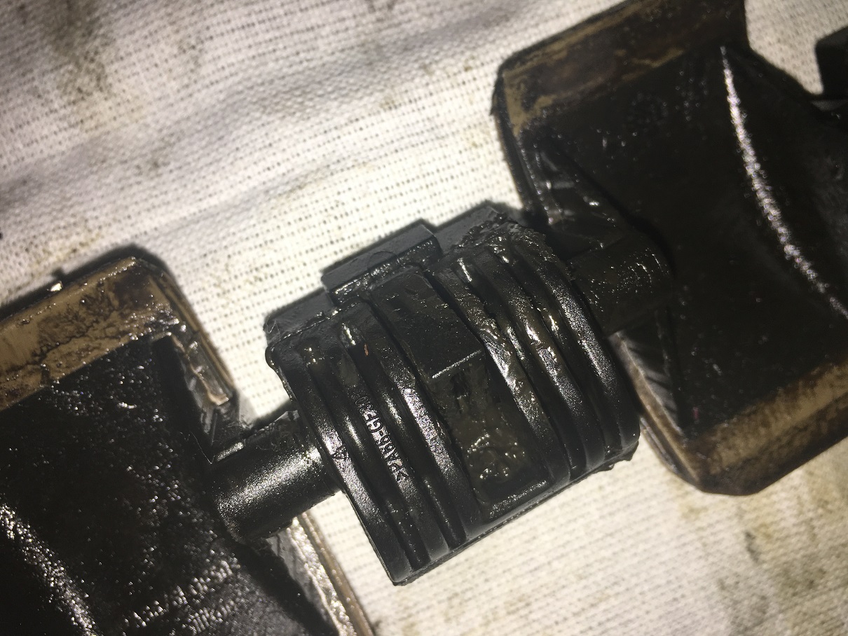

One row of flaps was in very good condition while the other driven by the main set was absolutely worn out damaged in multiple places which makes no sense as you would expect the main set to be ruined which is driven the by actuator motor mounted at the front of the manifold.
Breaking off them ain't very easy, a strong flat head screwdriver with thin end is needed along with the hammer to break off three plastic rivets on each flap. You can see how some holes are worn out there where the flaps got loose before detaching from the base.

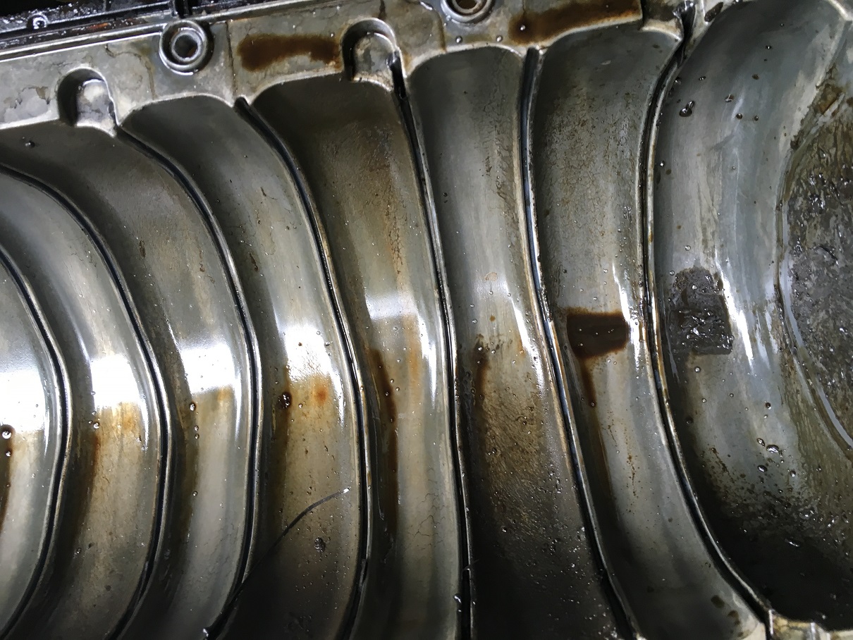

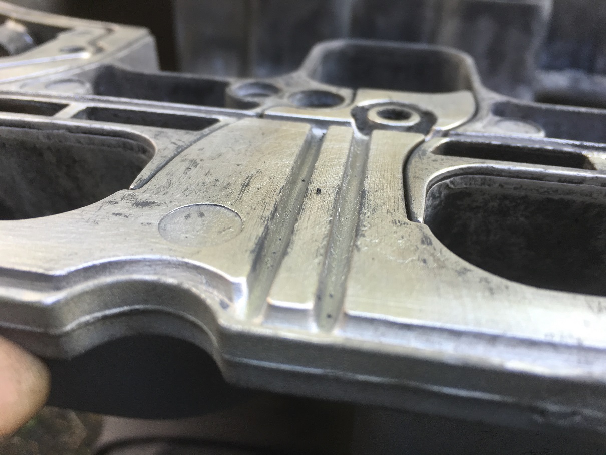

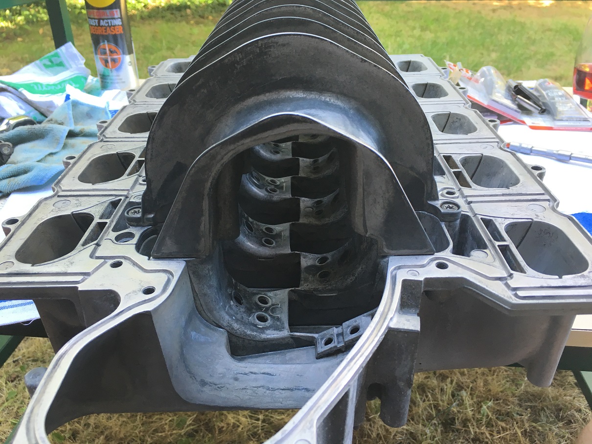

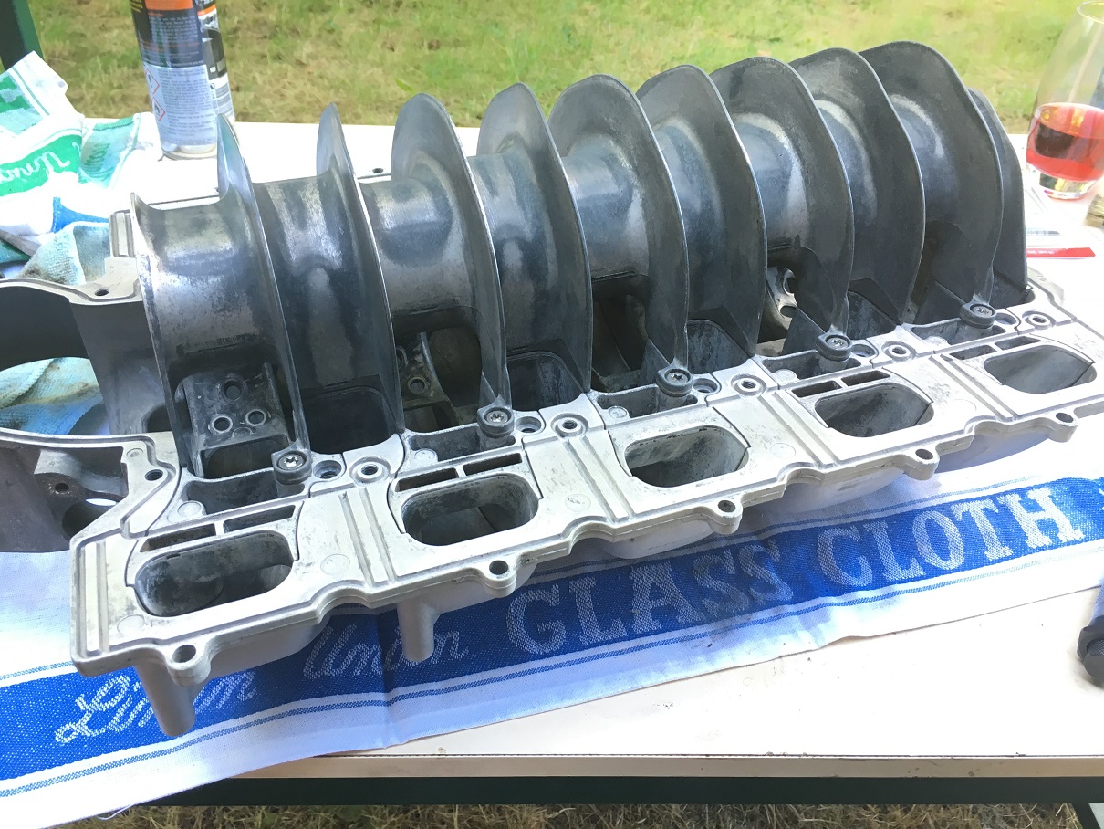

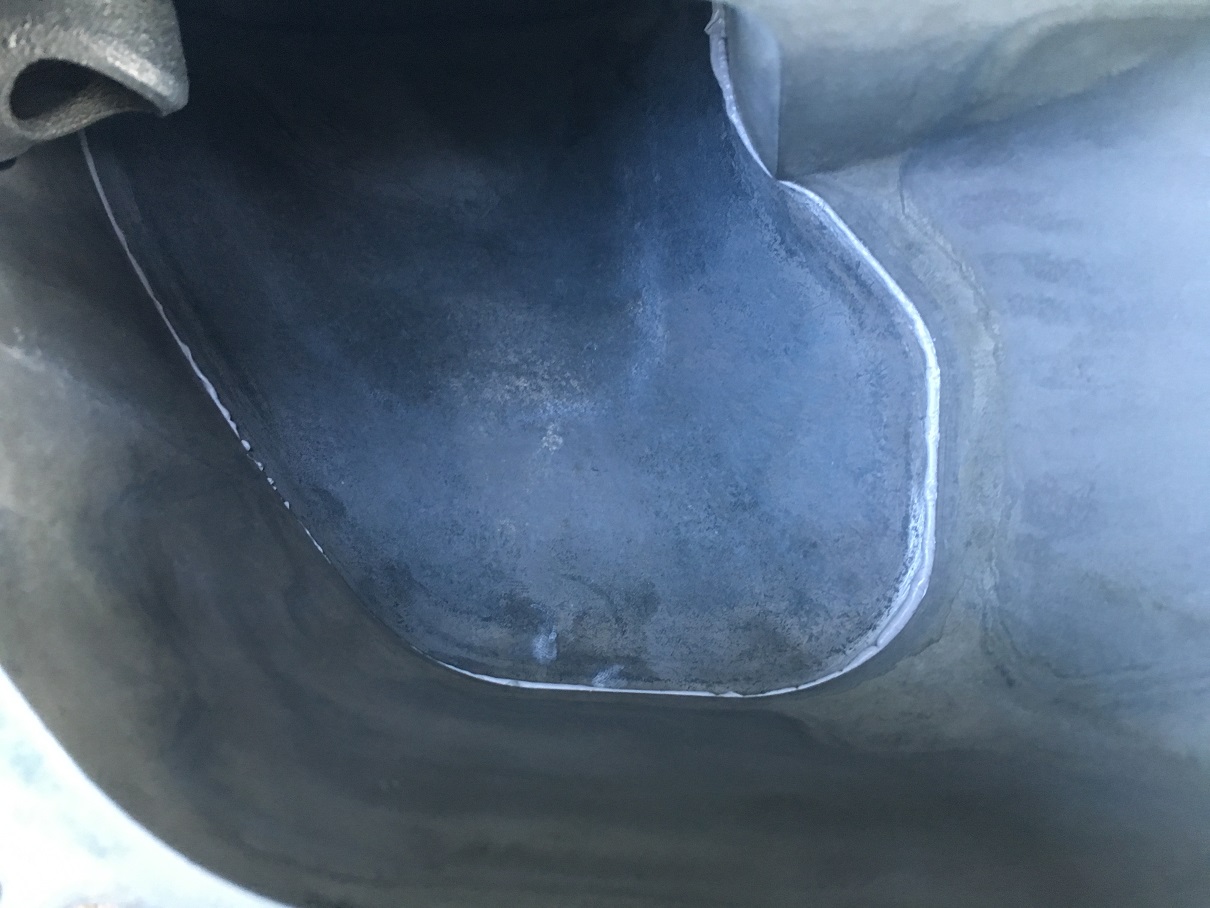

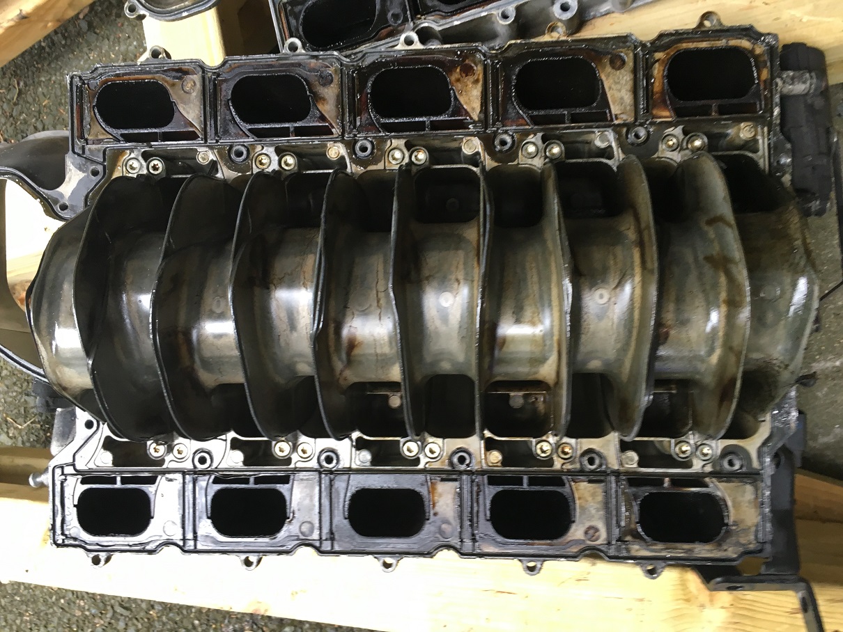

As mentioned earlier removing the silicon is a real pain and here are some shots of all the sealed are preped for sealing, all the inlets along with variable flaps cleaned/decoked and both parts of the manifold drying out in the sun after last and final rinse with the WD40 Degreaser.
For sealing the manifold I've used JB Weld Ultimate Grey Silicon
Very very hard to squeeze out so expect some rushing, sweating and your hands hurting at the end as hell.

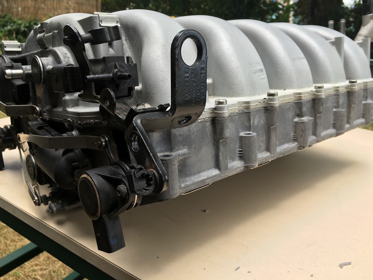

And here is the middle part bolted on and bottom and top part finally sealed.

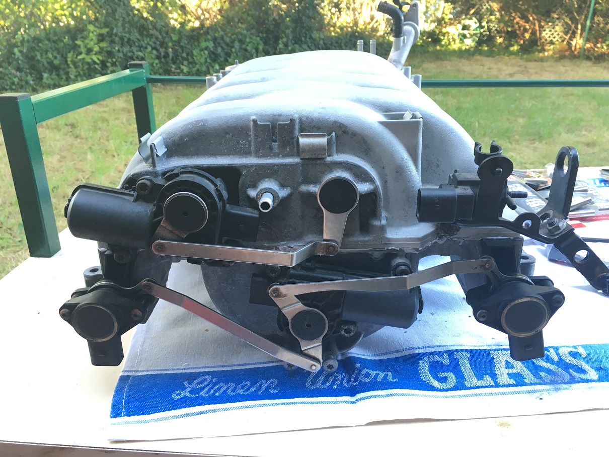

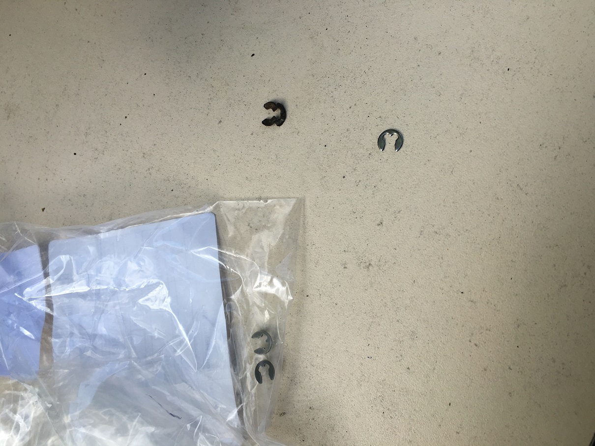

All actuators bolted back on (had one arm securing clips missing from the back on one of them so decided to pop in to Audi and order and replace all 3 of them).
All the excess of the silicon from outside trimmed.
DONE !!!
