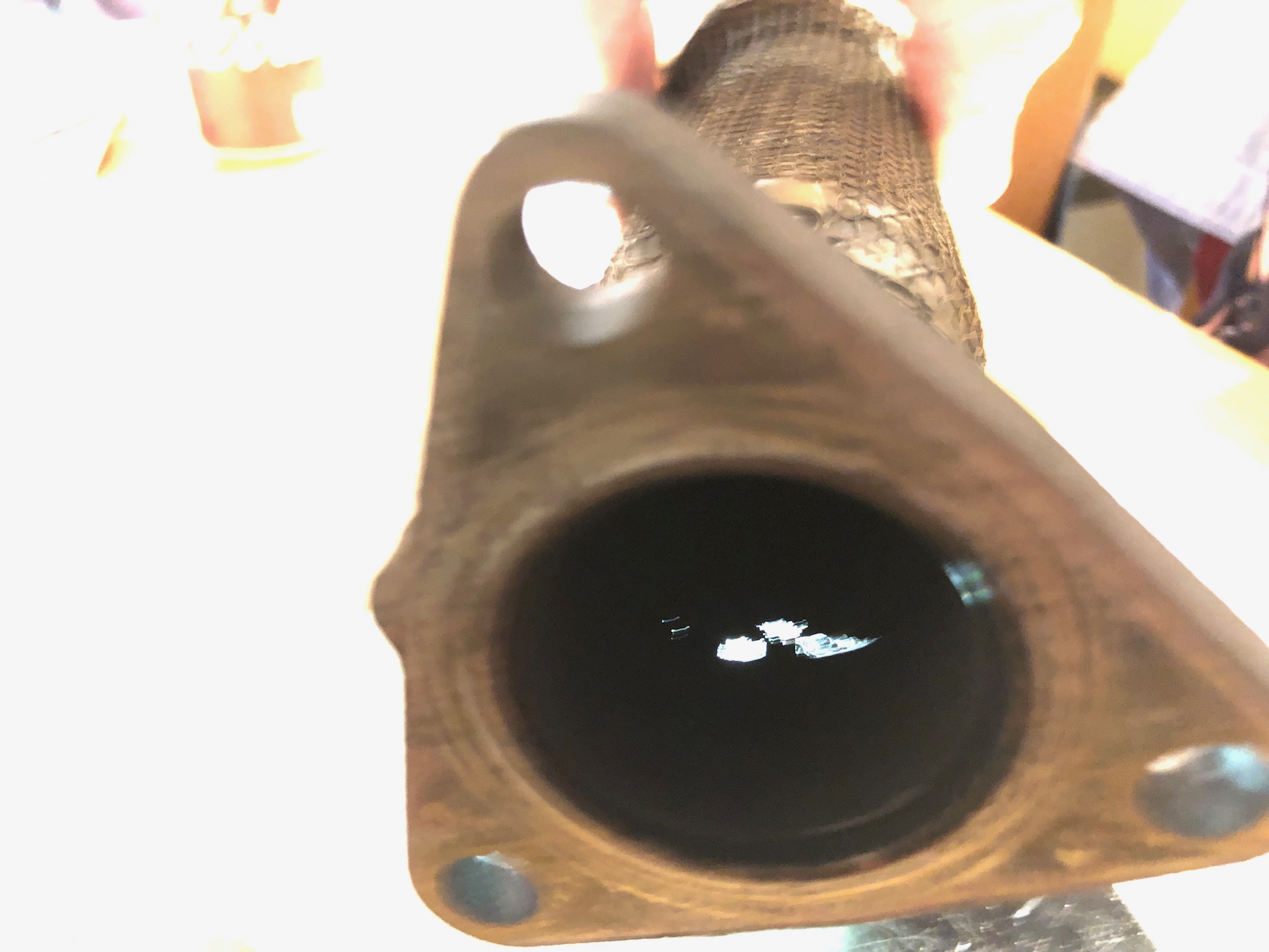

Posts: 1,602
Default The offending article
Behold the b#@5ard part, with hole...
ID:	20320   Click image for larger version
