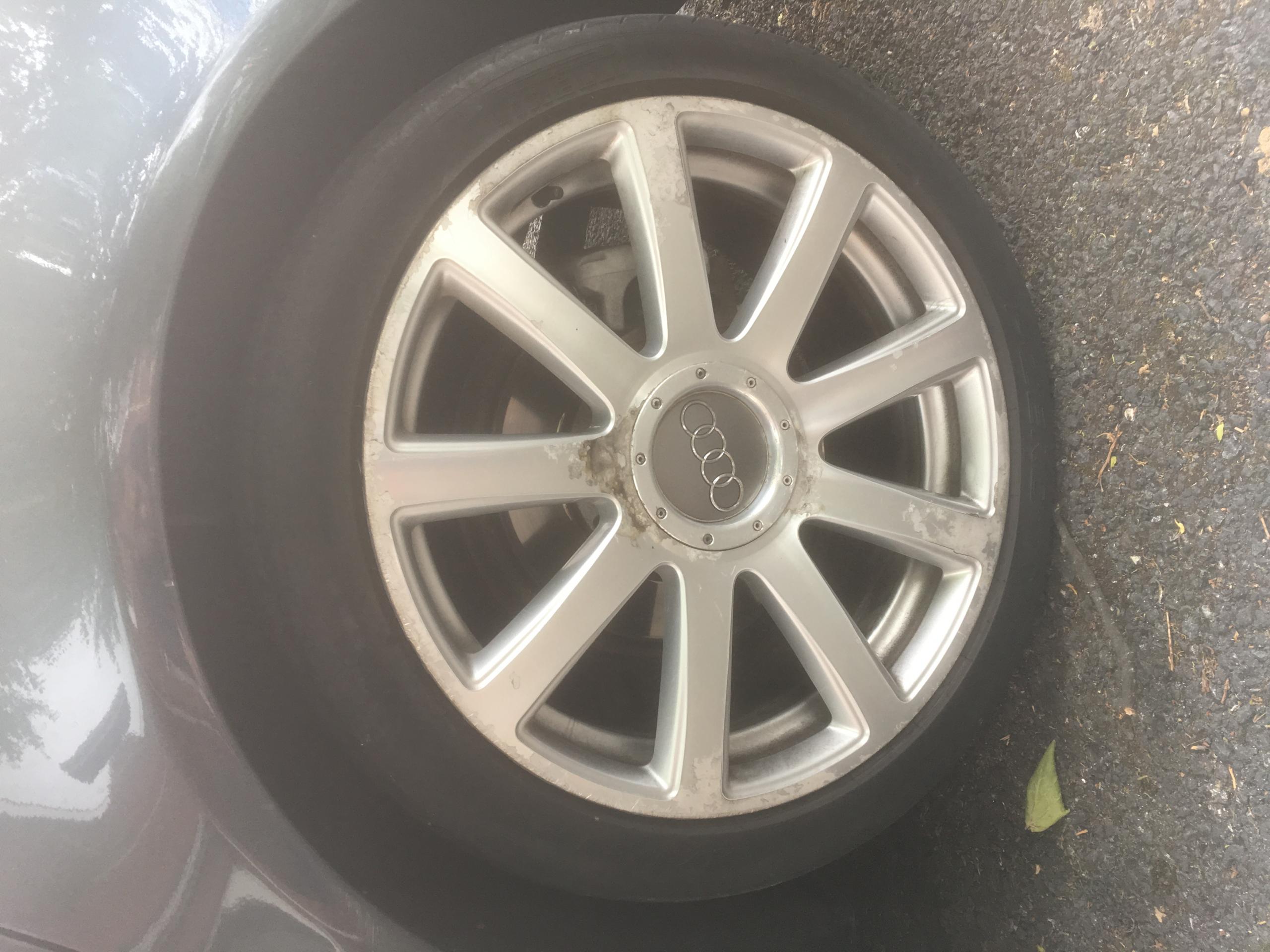

Post a pic of one of the wheels and I can point out where this happens and whether yours have any more room for cutting
Personally, I'd just wet-paint them Avus silver
Hi Mikki, they've not been refurbed before so I think i should be OK getting these back to as close as factory as possible. The toss up was between powder coat and DF but i think based on what you say, the 150 additional will be worth it. I need new centre caps also so that adds another 200 for 4 new OEM ones off Audi...

Looks like they may have been done once so you might be ok getting another cut, but only a light one. If that corrosion at the centre is quite deep you're probably better off getting them painted.
Centre caps from Audi are about £140 a set, but they all come scratched so bear that in mind if you want them flawless. They are unable to pack them properly from the factory so they all get bounced around loose in transit - I bought five sets and returned them all with damage. All they need to do is make them with some sort of film protecting the polished edge, but they just come plain in a plastic bag and are thrown in packing crates with other loose parts.
