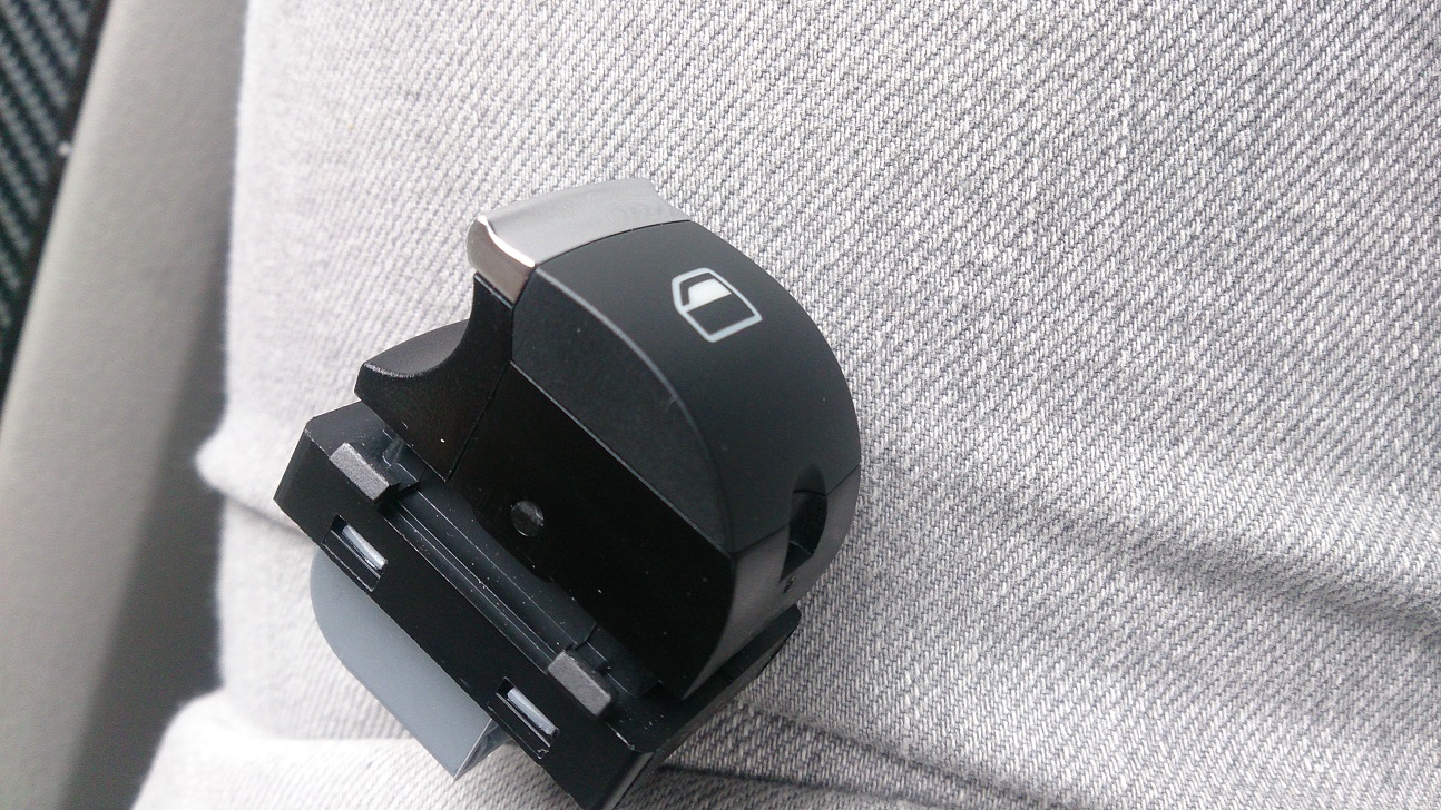

Originally we were hoping for a simple cap swap, but it got even better, 2011on A3 switches are a direct replacement for A8 switches

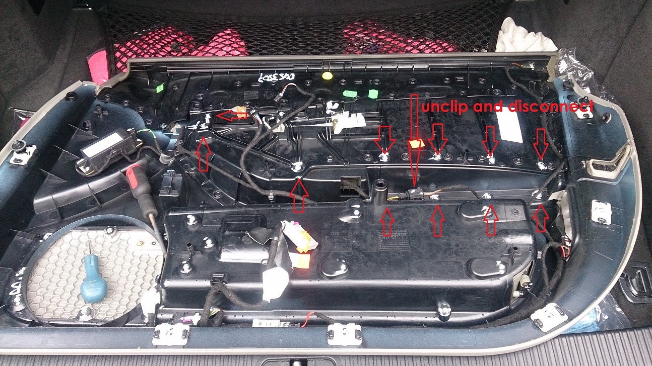

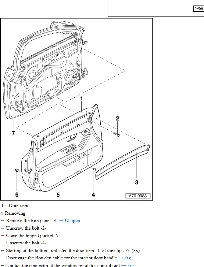

Few pics from Elsa showing fixing points and connections between the door and the door card

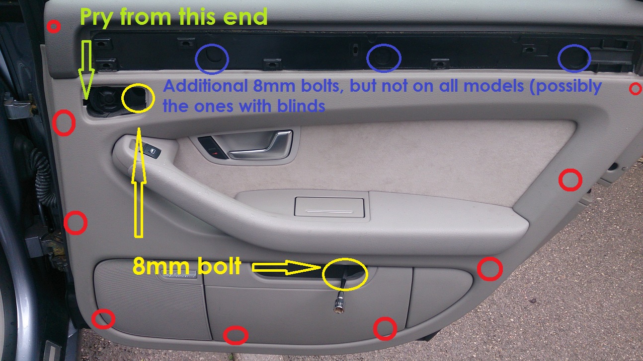

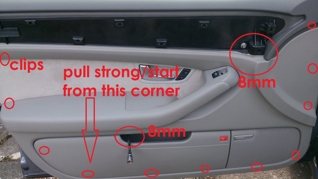

So first remove the decorative door trim, start prying from the hinges side.

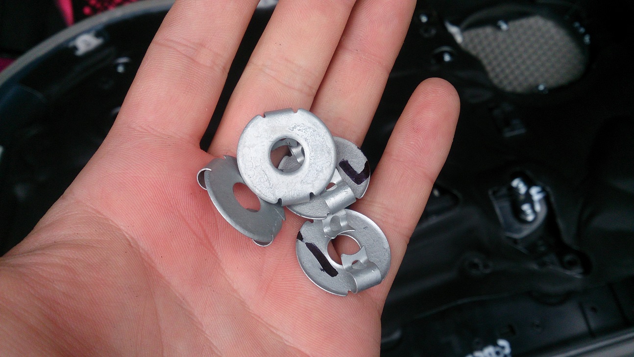

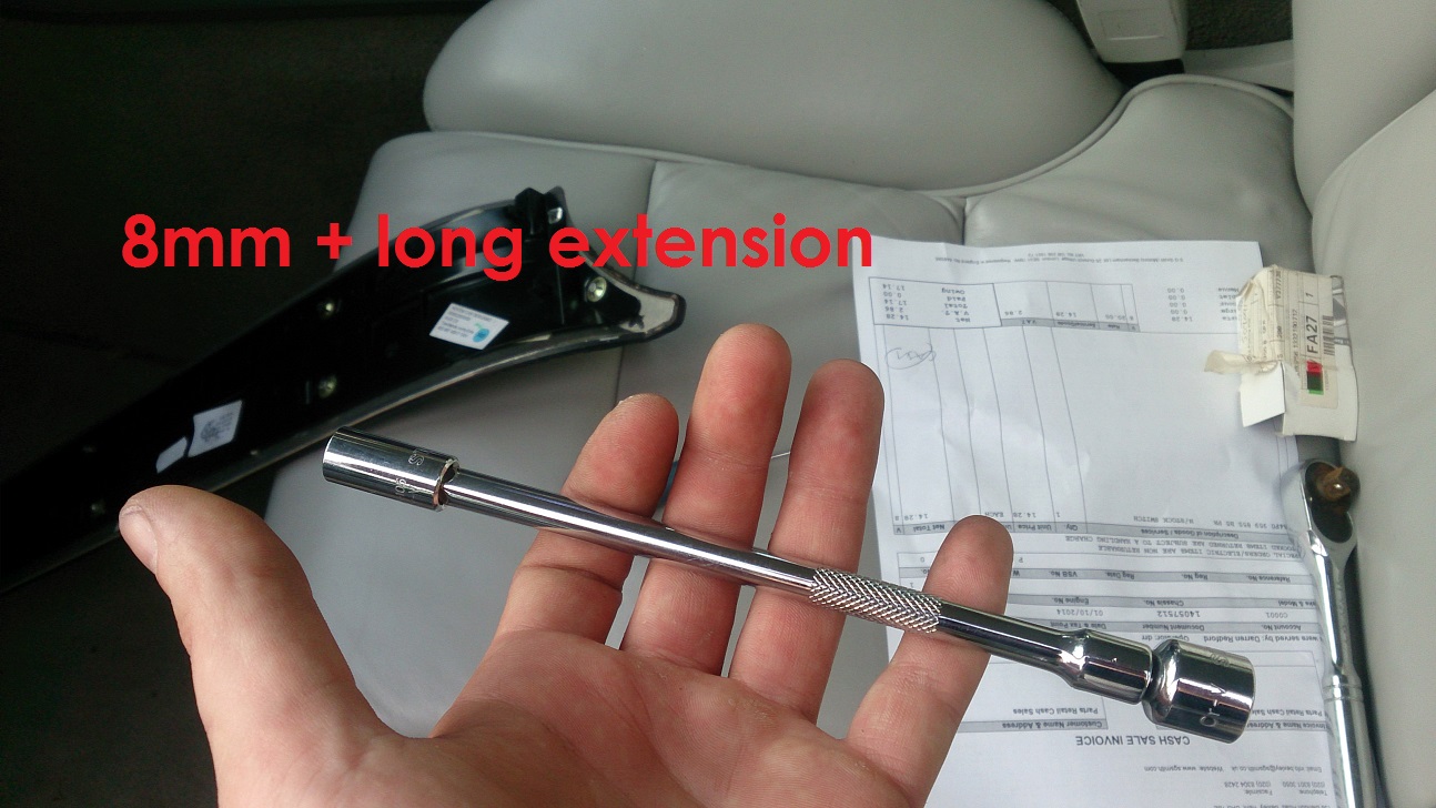

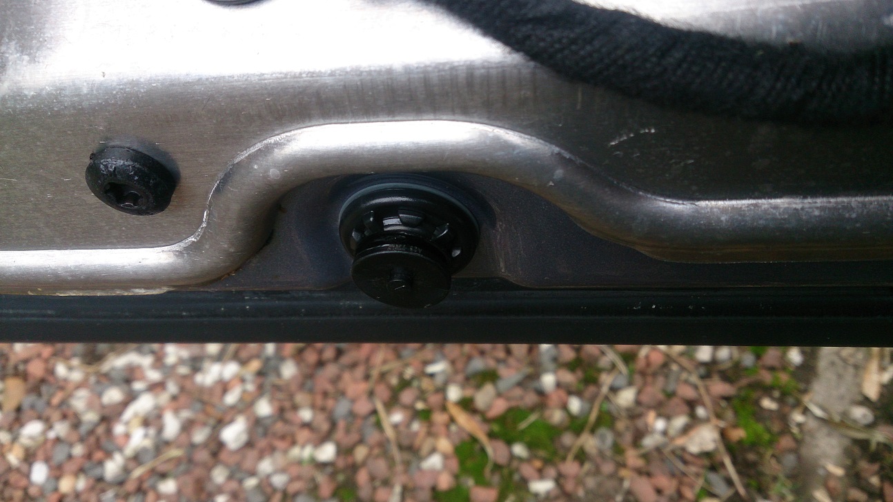

Then get your self a 8mm socket and a extension bar for the bolt behind the door pocket. This are the only two bolts you will have to undo.
Picture below shows you more realistic position of door card clips, and they are really really strong and quality. You wont break them like on other cars, but they will get you sweaty a bit because before the very first one gives up you will think 'That is not going anywhere'.

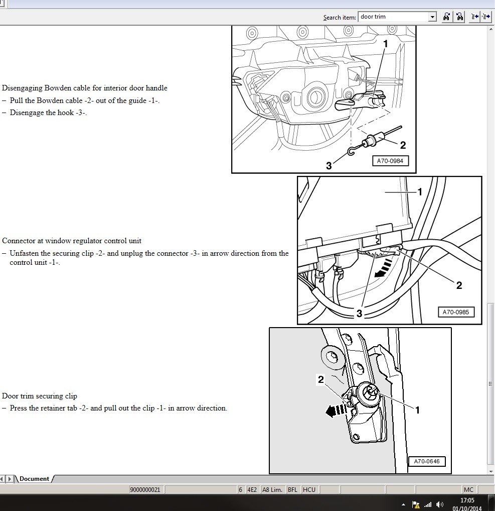

Start from the bottom outside corner and then just lift the card gently to disconnect one electrical connector and door handle.
As per picture 2 above (from Elsa) disconnect the door handle and then disconnect main electrical connector

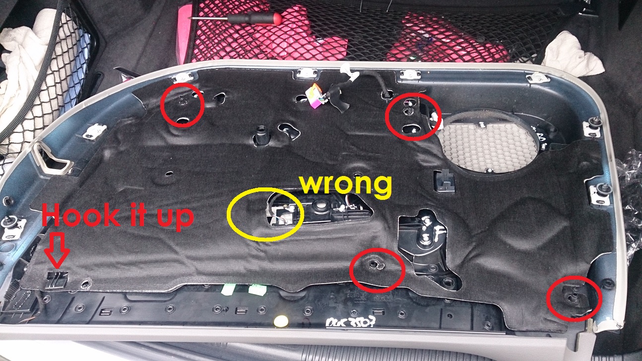

Lay the door card in the boot for example and remove the insulation/fabric by pulling and turning at the same time either way metal clips.
(at this stage ignore the ''wrong'' and ''hook it up'' markings)

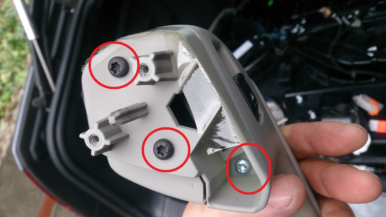

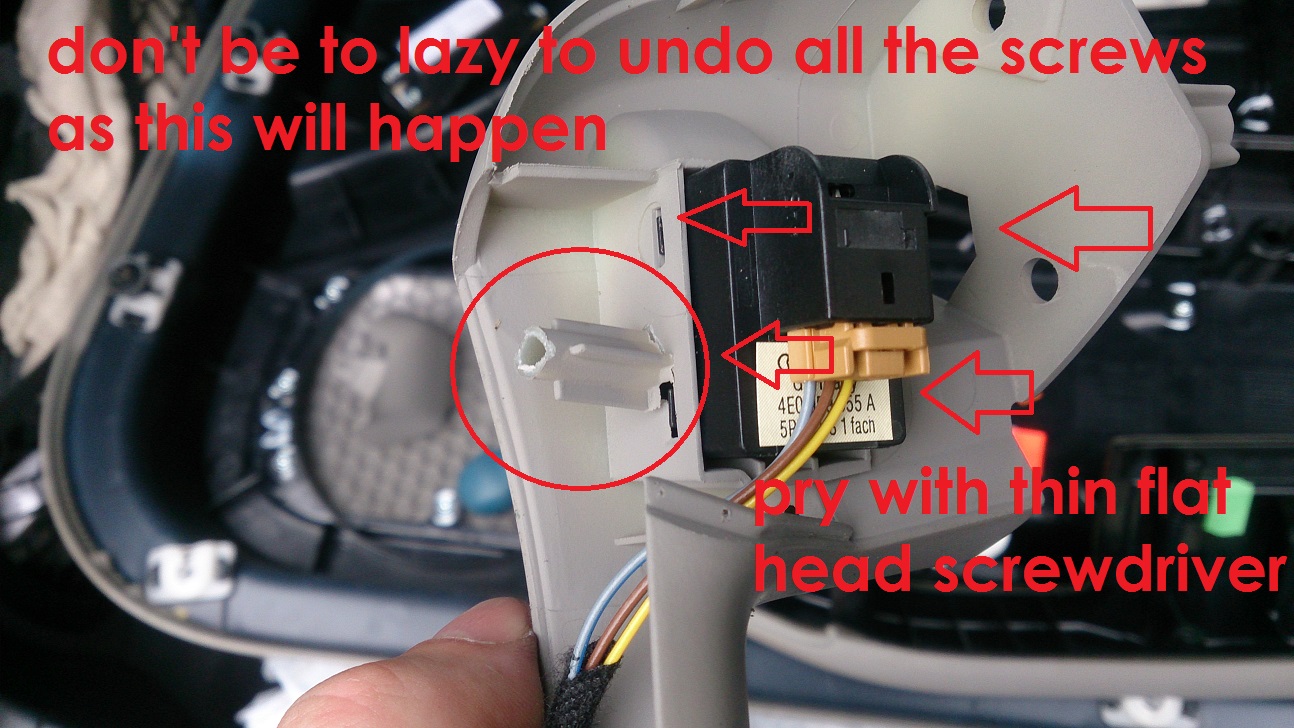

Your next step is to remove the arm support from the door by unscrewing 11 standard Audi torx screws, but before you do that pull the connector off the door and disconnect it as per picture below
Now the arm support. Here are only 3 standard torx screws which you have to remove in order to remove bottom cover to get to the switch, undo all of them even if you think the third one is irrelevant or are inpatient like me, otherwise you will break a plastic pin where one side of the cover clips on.

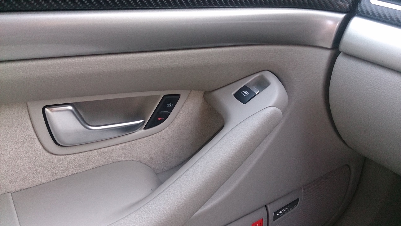

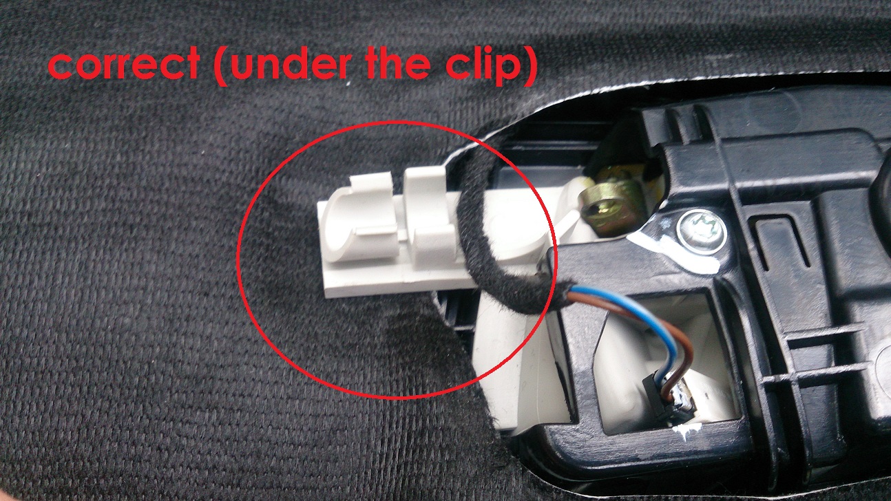

One thing with the insulation, make sure it is behind the internal door handle clip like in the picture below

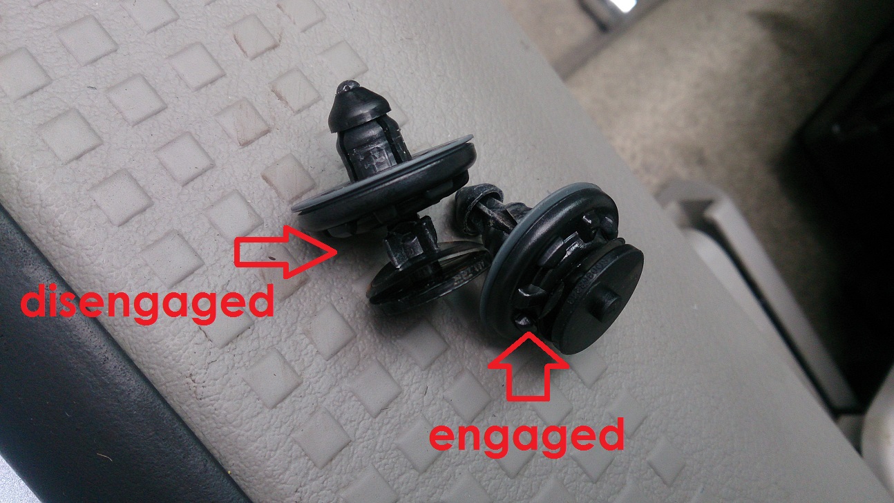

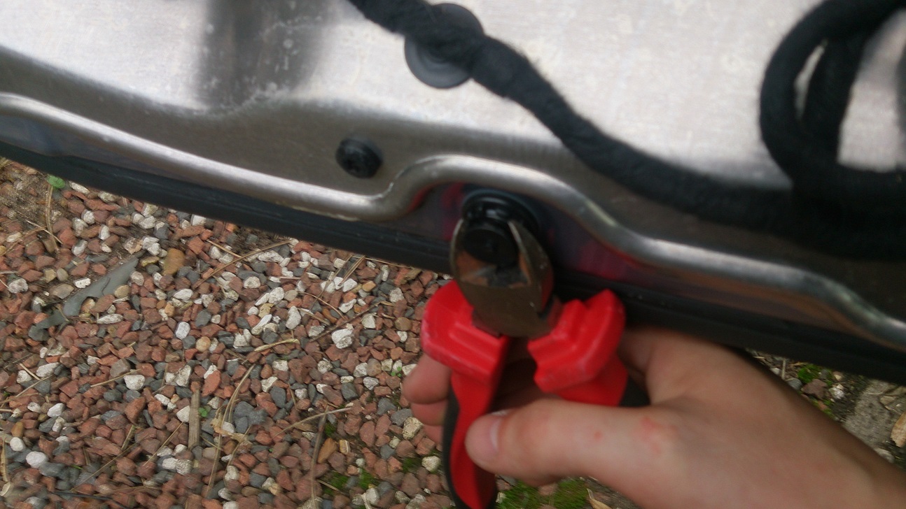

Now it's time to remove door card clips.
They all should disengage during the pull, but they not. Use cutters or tool of your choice to gently disengage each clip and pull the off the door.
Position each clip on the door in disengaged position
Hook the door card up and start clipping it bit by bit. Use some force to engage the clips so the card sits nicely on the door with no gap and not loose.

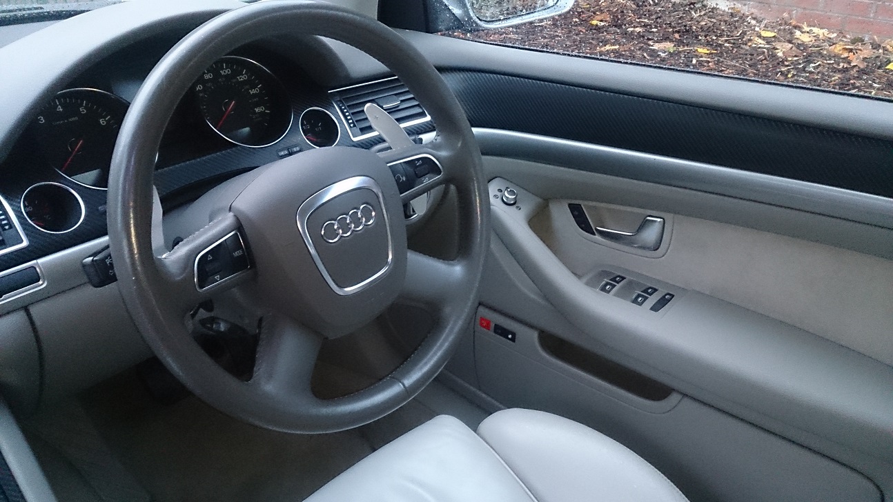

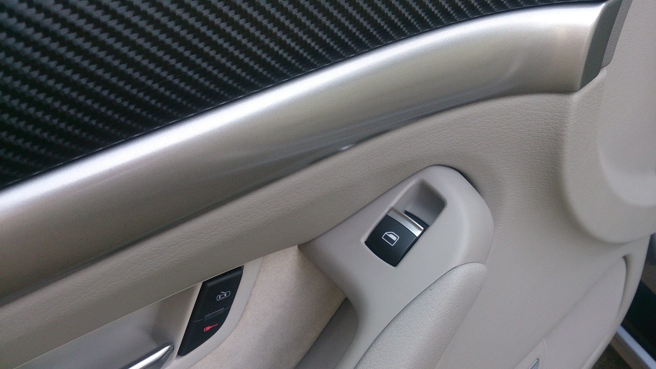

And here it is, maybe not so impressive as the master switch, but when they all are changed it will add nice feel to the cabin.
Illumination works exactly as the original switch and it has exactly same colour.

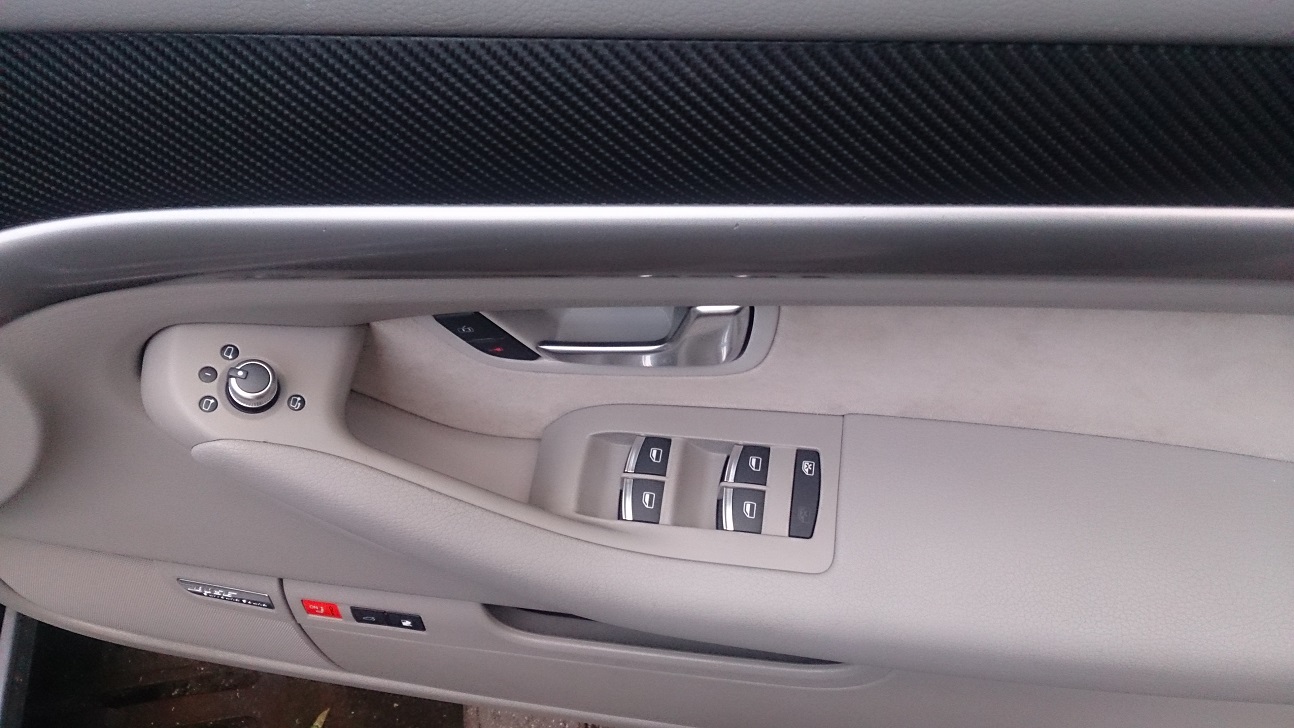

So, today I managed to fit rest of the switches and oh boy, they look sooooo good. One of the best mods for the interior, no doubts.
One thing different in operation is the mirror switch, it is way much smoother.
Scott, we did it and thanks once again for putting this idea last Wednesday in my head, hours spent on research were well worth it.

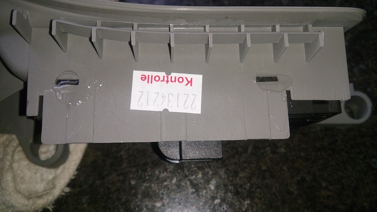

Mirror switch is a bit of a pain, but nothing serious. But, mine was glued on one side from factory, not much, but you will have to break the glue first.
It sits fairly deep. I used iSesamo tool which I squeezed between the clip and the surrounding housing and then used a flat head screwdriver to push it out.

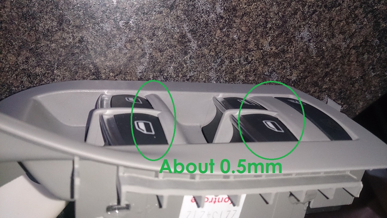

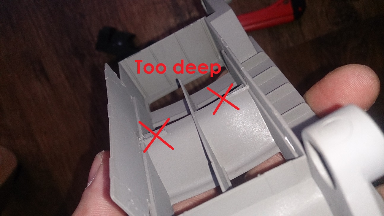

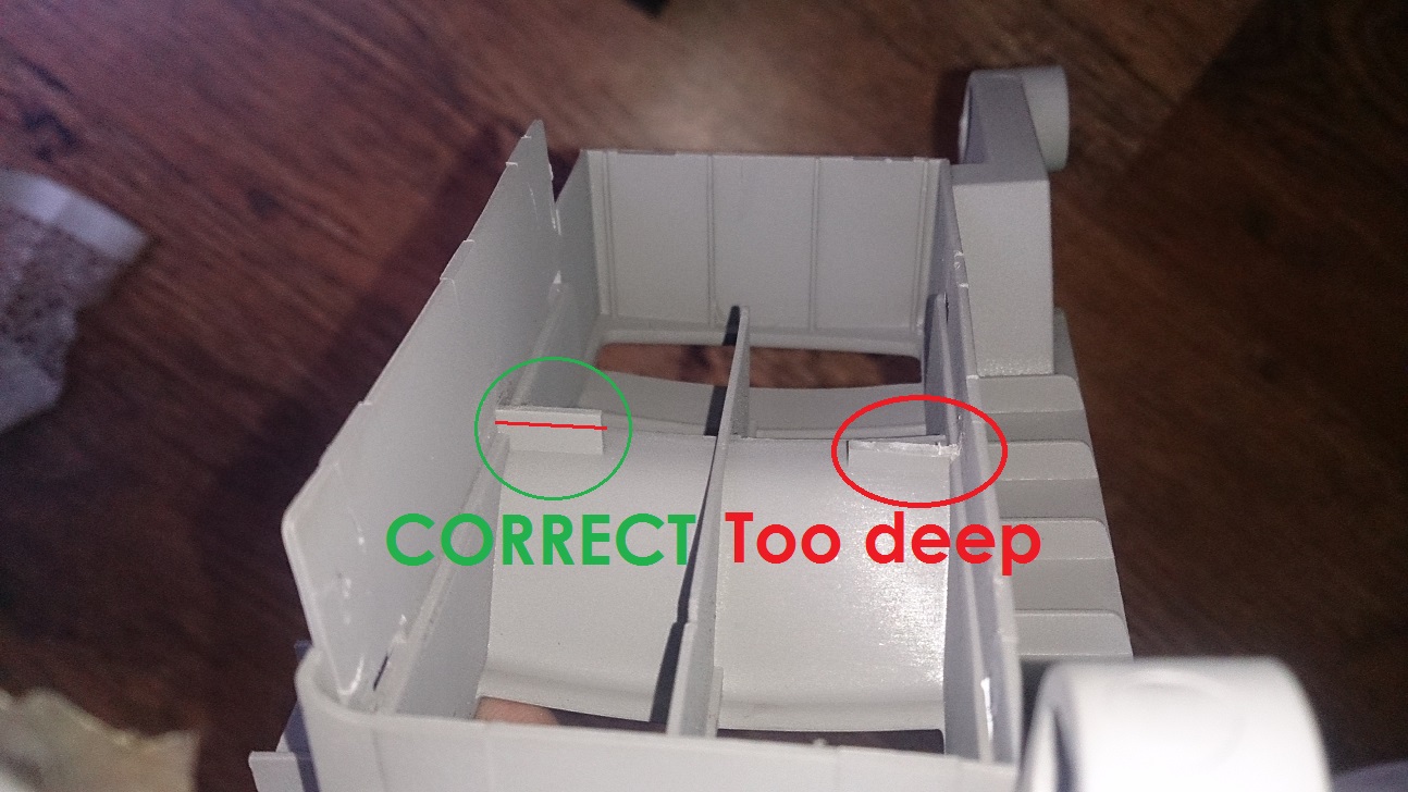

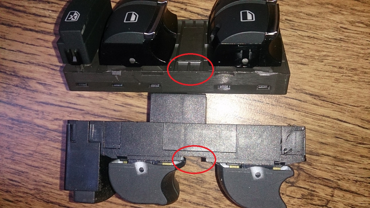

Here is the only little adjustment you have to do to make the driver's master switch fit, if you don't do this you will end up gluing it. I did as I was expecting to just click in, but instantly both front clips just broke off.
So there is a cut out in original switch for two plastic bits which you will have to trim a bit in order to fit new switch, well, it's better if you look at the pictures as I am brain dead after a long and hard day.
Then if you take too much of the plastic off as per pictures below the switch will go too deep and will be loose so keep cutting off bit by bit until you get the best fit.
At least someone else, me , made this mistake so you don't have to.
The gap should be about 0.5mm so the caps don't rub.
